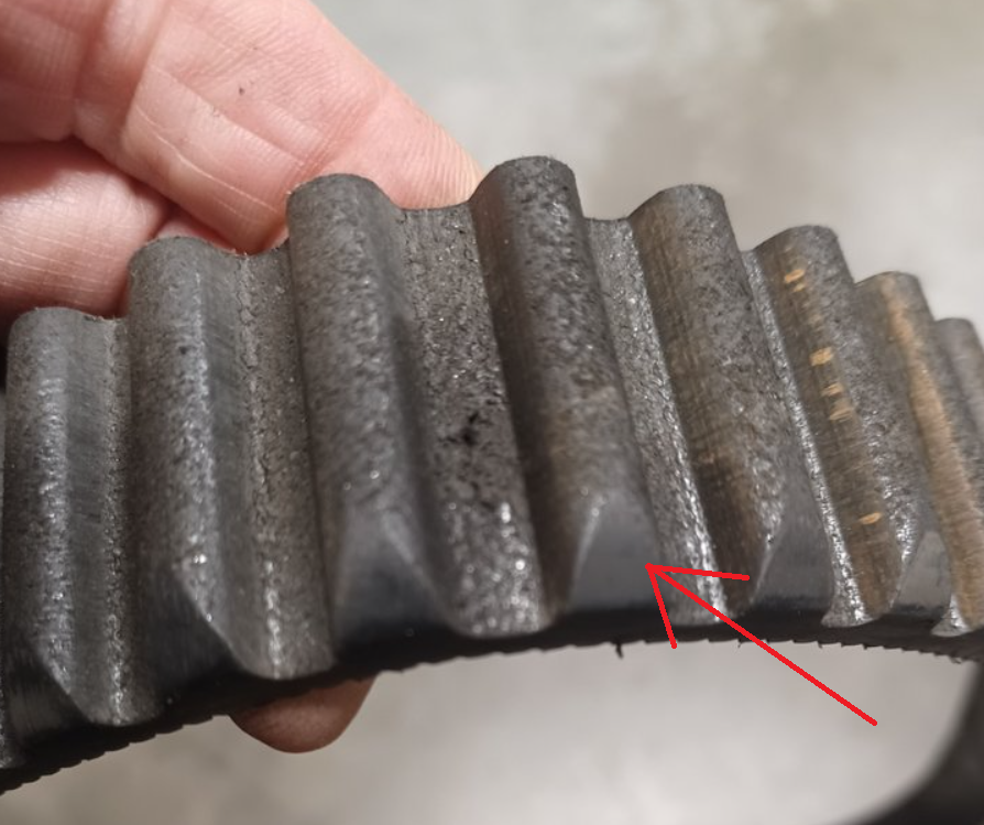

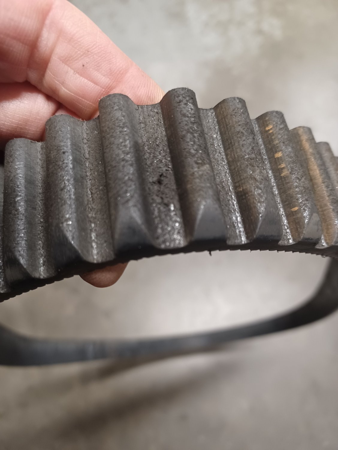

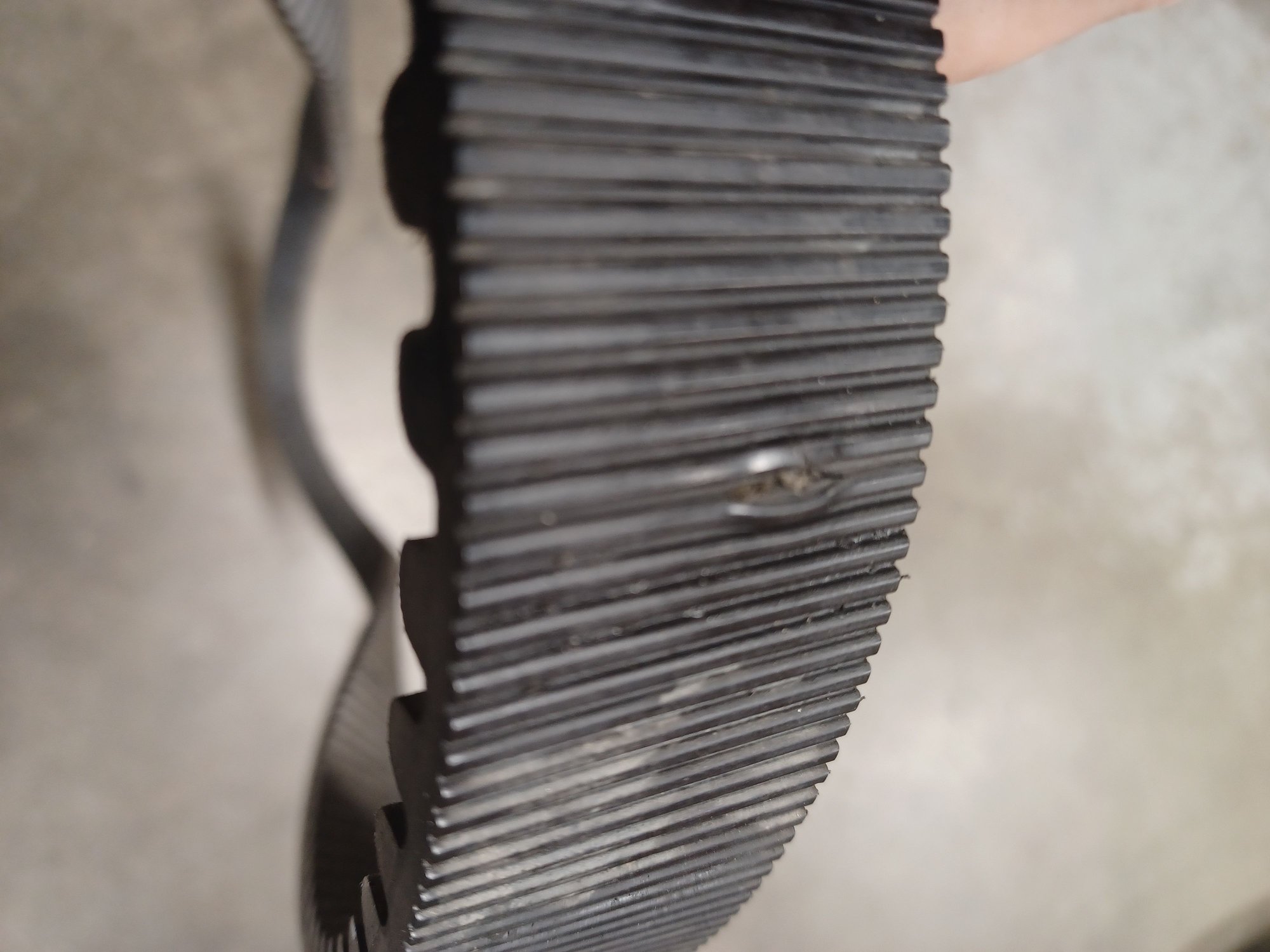

The old belt has damage from some sort of debri going through it. The bike has 70,000 miles and i have no reason to think its been replaced. I've only had the bike for 9 months. The damage was there before I got it.

Here are the photos

No offense but that hole could have been created 30,000 miles ago.
I had one punctured at 20K sold bike at 45K, saw it a bar years later 65K
Not recommending it ,but, there`s a lot of them out there.
But, it`s off your list, good on ya !

Never bend a drive belt backwards like that. It will ruin it.

I'd be more concerned with the wear at the arrow in the picture than the hole in the belt.
You can even see the pattern on the pulley, you need to look and see if you can figure what caused that.
