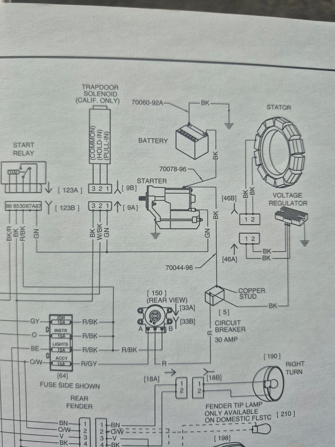

Originally Posted by RANGER73
Think about it for a minute, take two if needed.
There's no protection for the regulator wire coming from the regulator.
That's about 3' of unprotected wire running along the bottom of the frame rail.
Putting it on the battery side will only protects the bike wiring after the breaker,
and protects the regulator if a wire shorts on the ignition side.
Putting it on the ignition side protects nothing.
But what happens if you get a short to the headlight for example? If the regulator is connected to the ignition side wouldn't that negate the circuit breaker altogether if the shorted wire to the headlight continues to receive juice from the regulator?
I'm no Einstein, so correct me if I'm wrong, I'm just thinking out loud.
That is what the lights fuse/breaker is for...

On my 98 it's I feel it's the best way to wire it protected by the breaker and then feeding all the fuses in the system to everything else on the bike.. as in the attached pic...

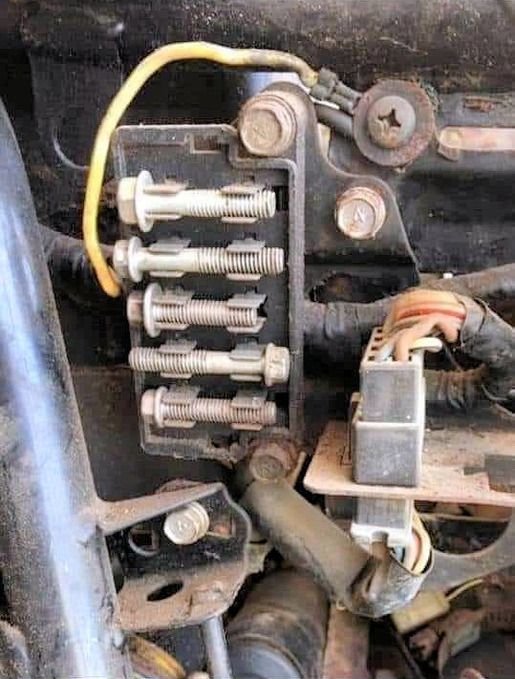

Yeah, just like it comes from the factory. Or you can do this...

Someone got tired of fuses blowing!!
50% of the time it works 100% of the time...
back in the 70's when we blew an AGC fuse we would wrap it in foil from a stick of gum to get where we had to go...
