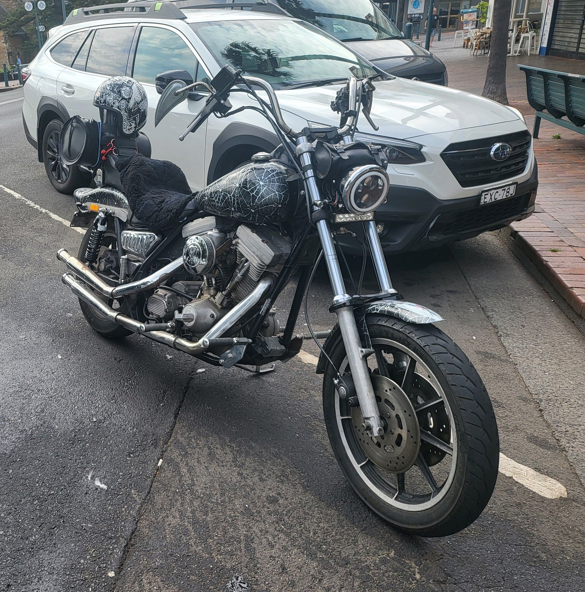

Hi All,
I am running aRivera Eliminator II SU Carburettor. (1997 and later version). Upswept manifold now fitted. Originally bought to install on a 2003 1200s
Now fitted to a 1989 FXRP with 1340 Evolution Motor. Have gone one size up on needle (By others)
I need help diagnosing issues.
On accelleration at about 2/3 throttle I get missing and like a backfire. Sounds like detonation at wrong timing.
For example it gets worse at 85kph in top gear and then gets better again at 105kph in top.
It got worse after I had a voes hose come of. It was noticeable but not as bad with an older style manifold ( with rubbers) but seems worse going to the upswept manifold.
This upswept manifold should have been an improvement but wasnt.
I noticed that the Voes is stretched tight and I am not sure if this is causing vacuum issues.
