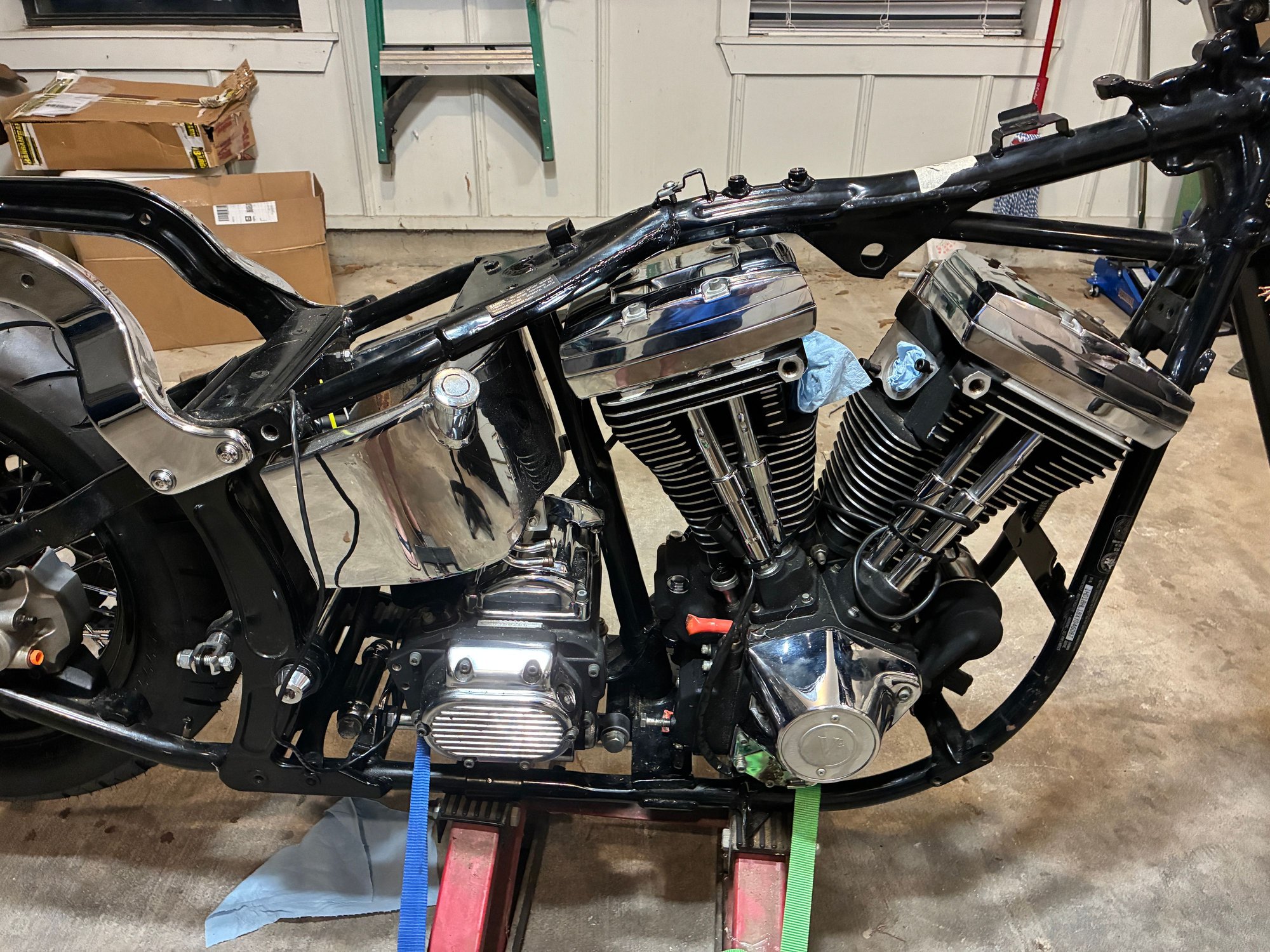

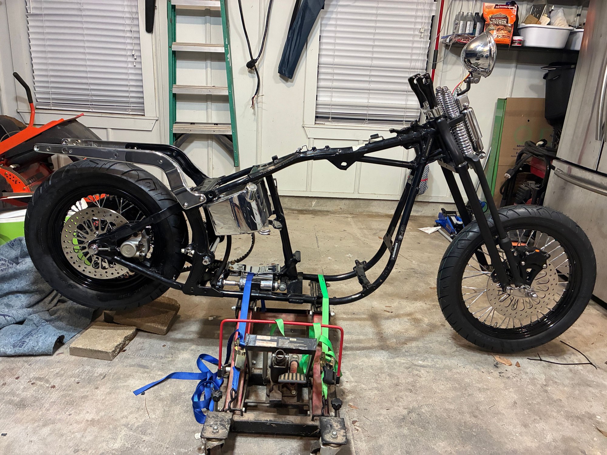

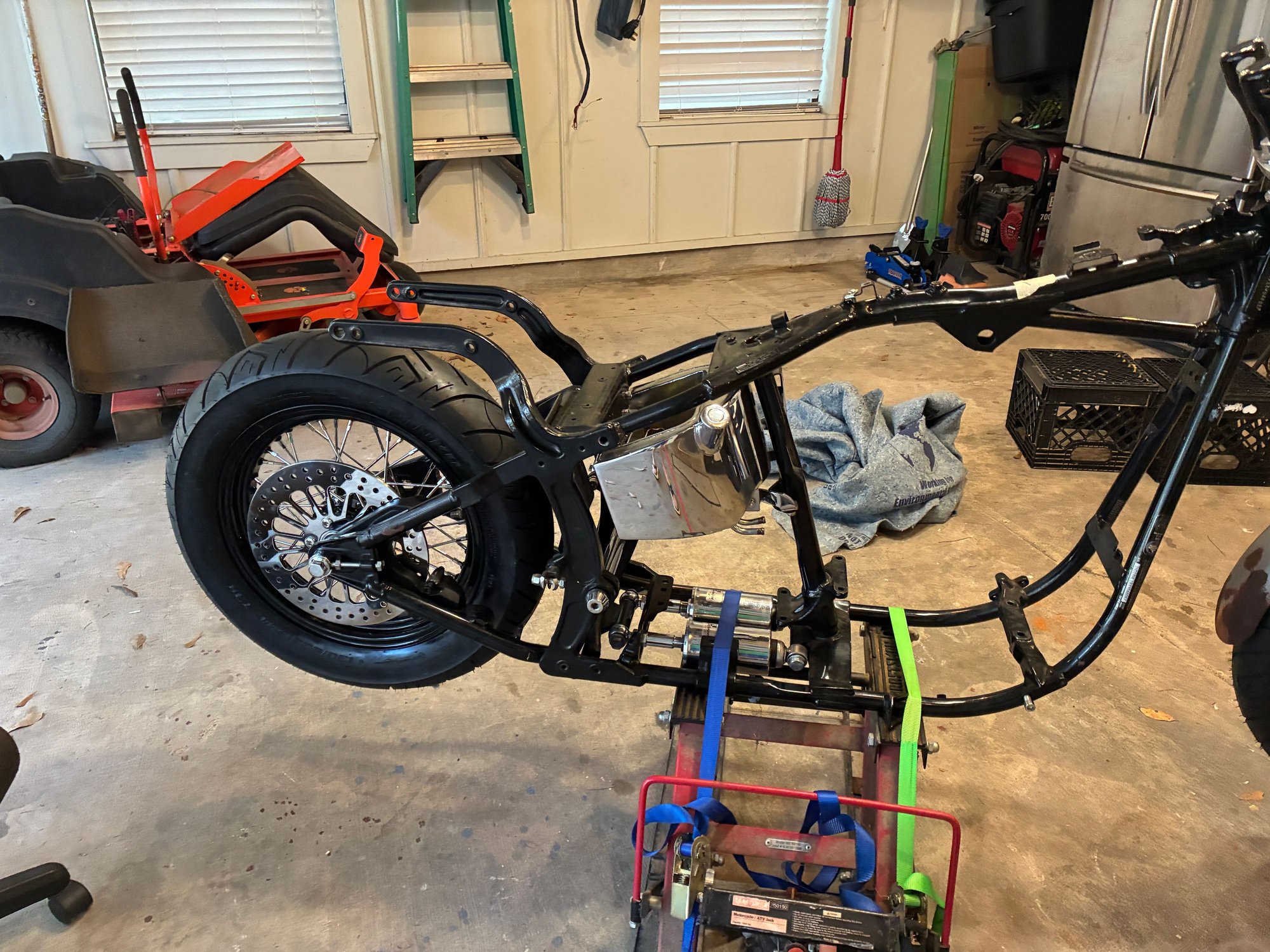

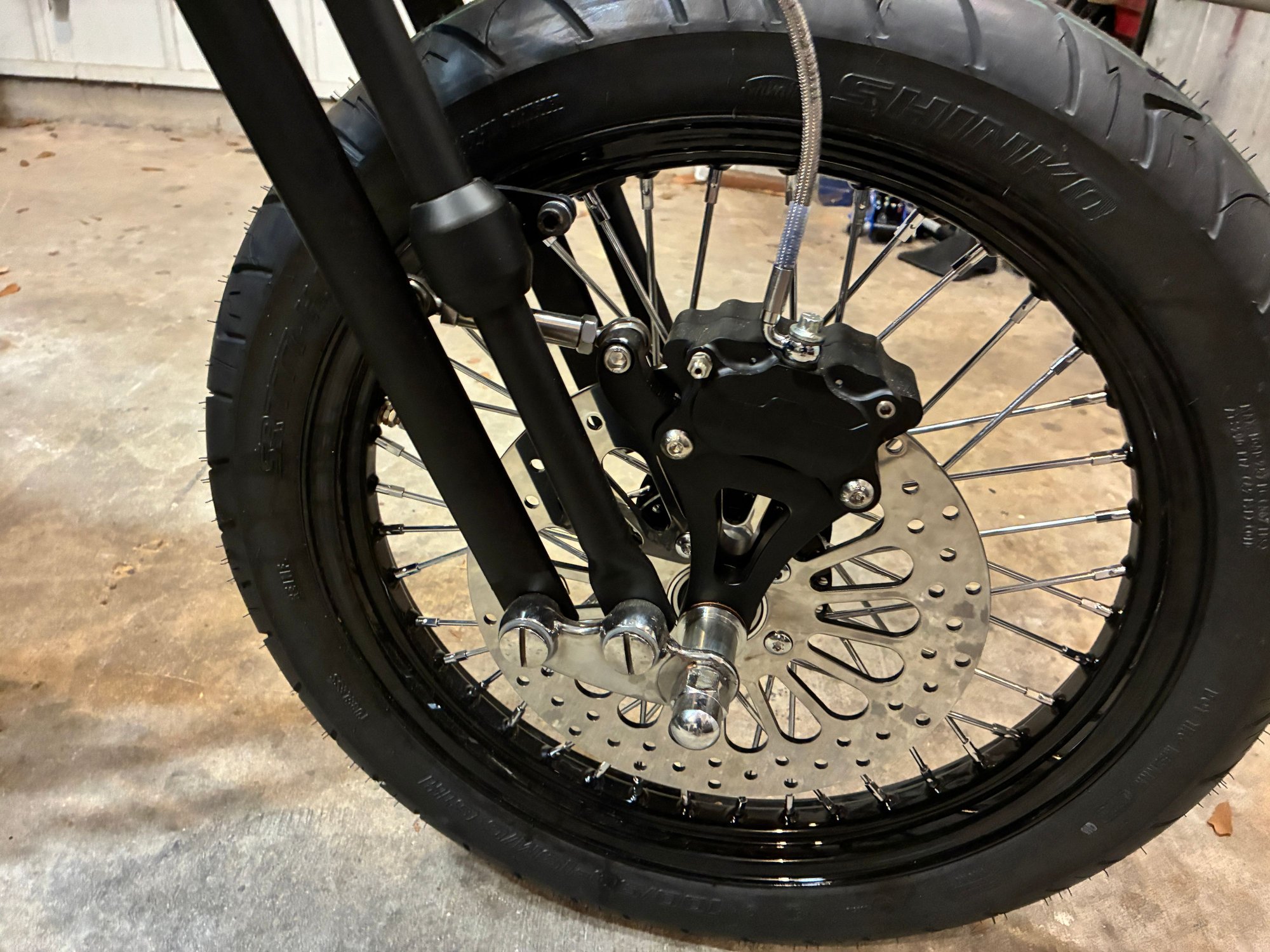

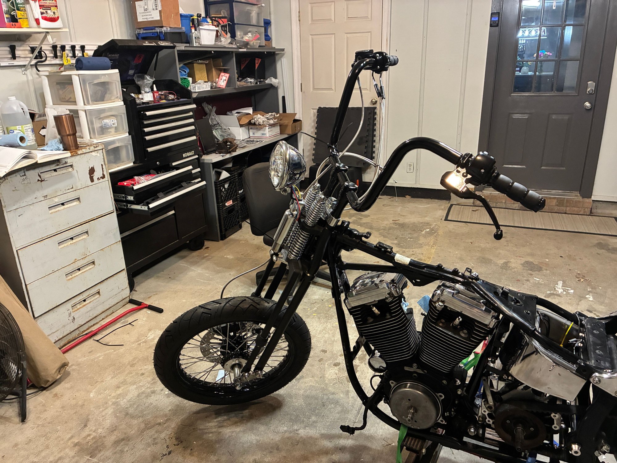

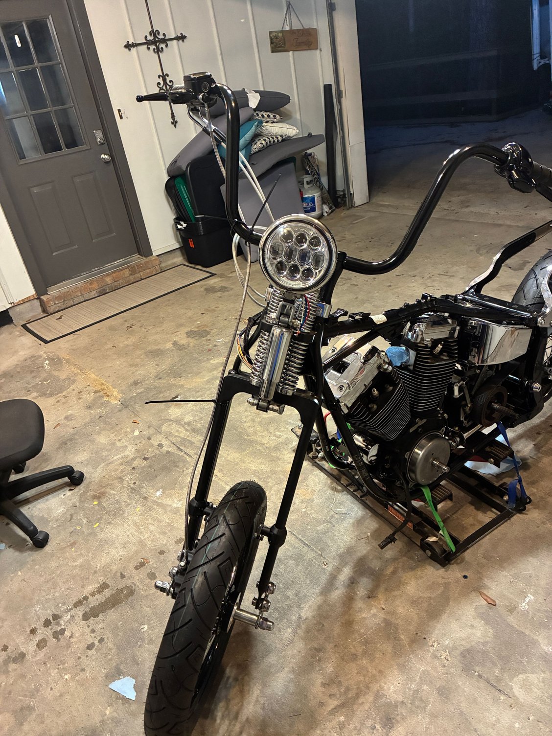

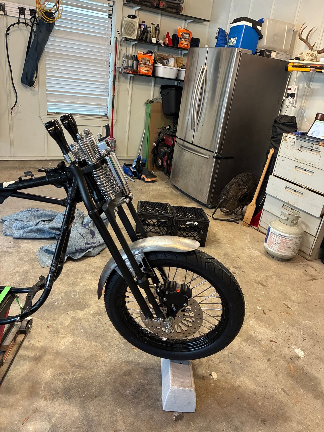

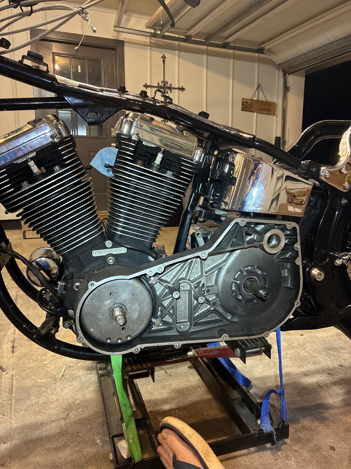

Here are some progress pictures and where I stand now. The whole thing got way slowed down when my wife of 25 years decided she wanted to leave last year. The divorce was finalized and judgement rendered last week so that is done and I am moving on. I should be finished with is in April or May depending on if life gets in the way. I am working two jobs right now to meet child support commitments so I am pretty dang busy. I hope to make somewhat steady progress and will try to take pictures. Last night is the most recent pictures. I lined up the motor, transmission, and inner primary per the manual and got everything torqued down. Set the rear wheel for proper belt tension and aligned it using the HD rear wheel alignment tool and the FSM. Front brake line is on loose and no fluid is in it. Hope y'all enjoy.

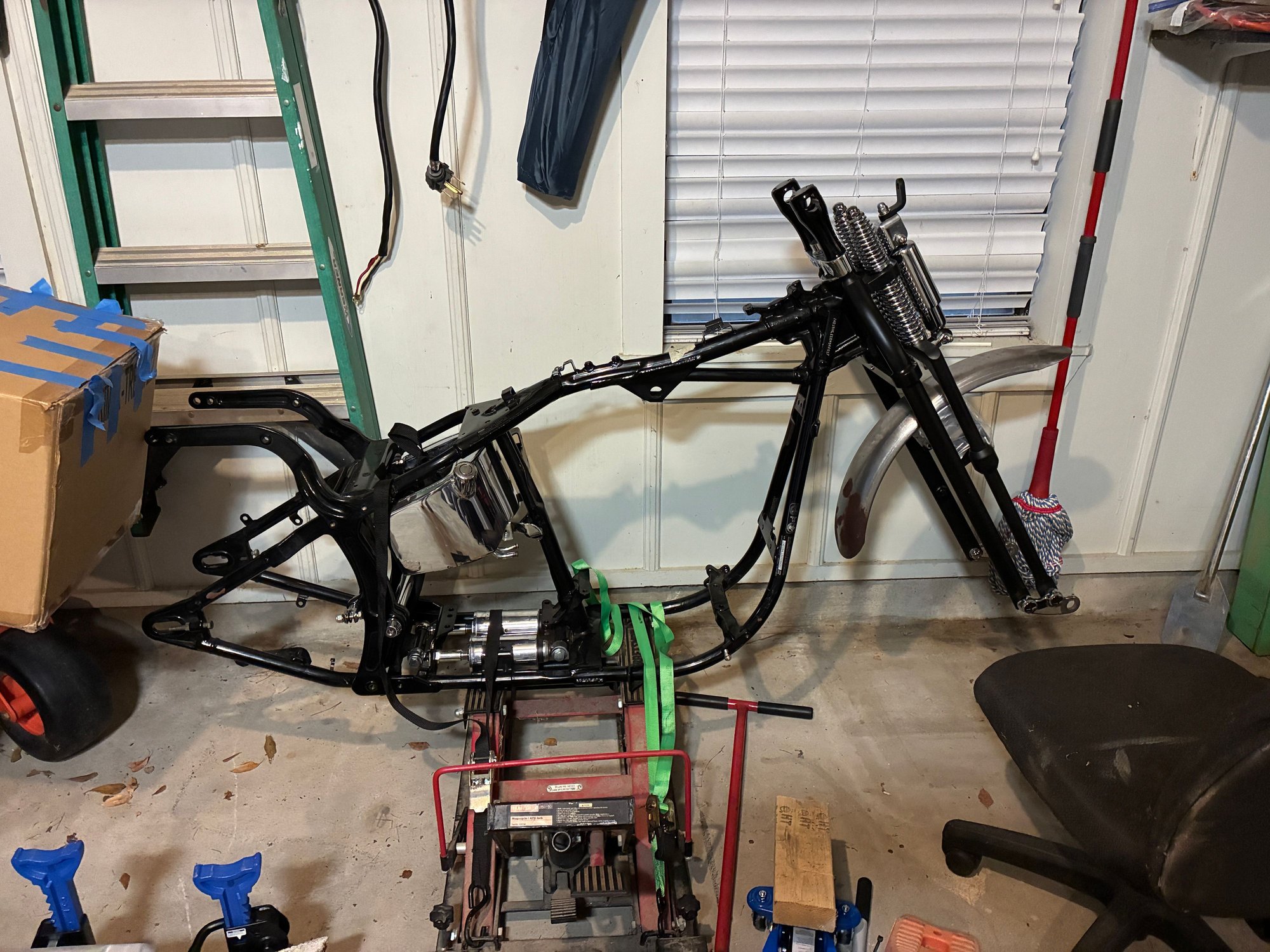

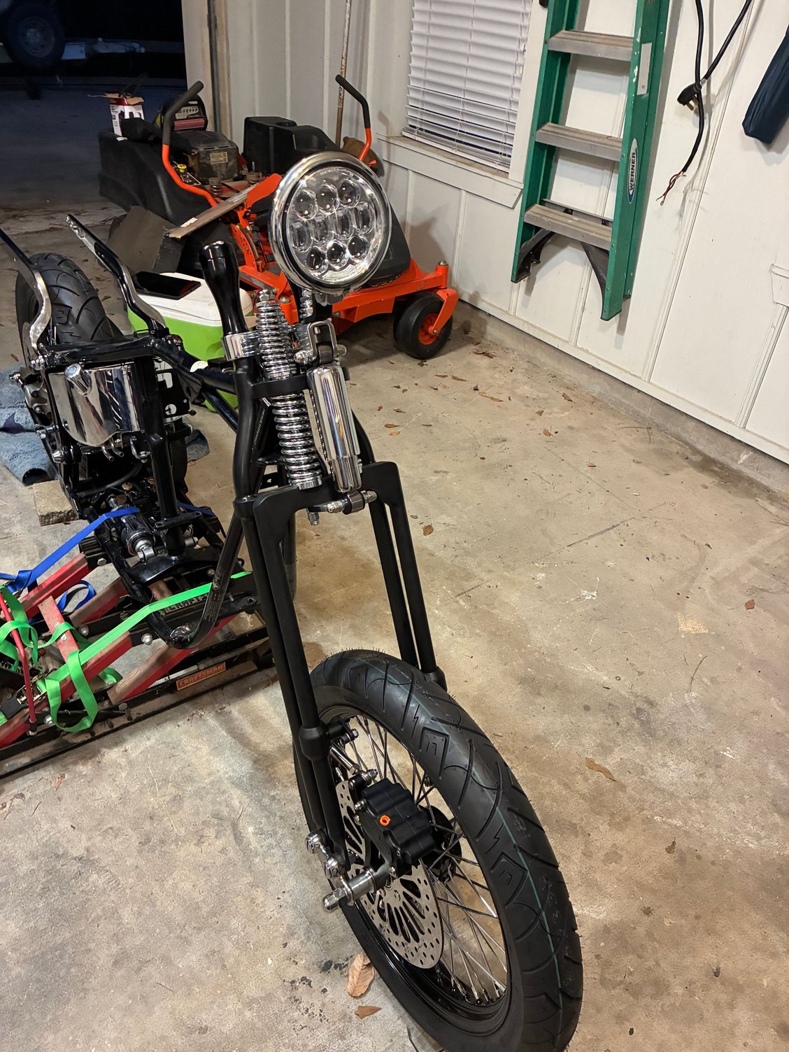

Right after putting on the Springer

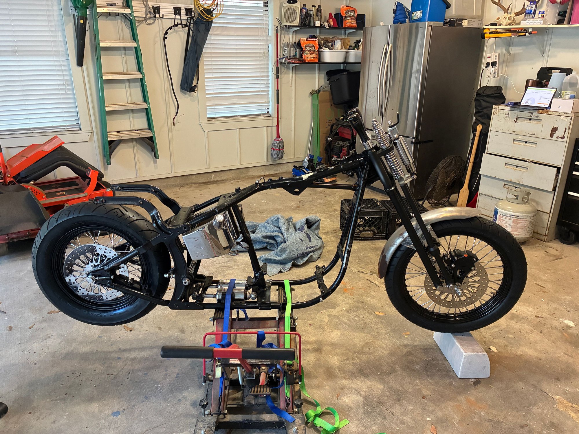

This is how is set for quite awhile

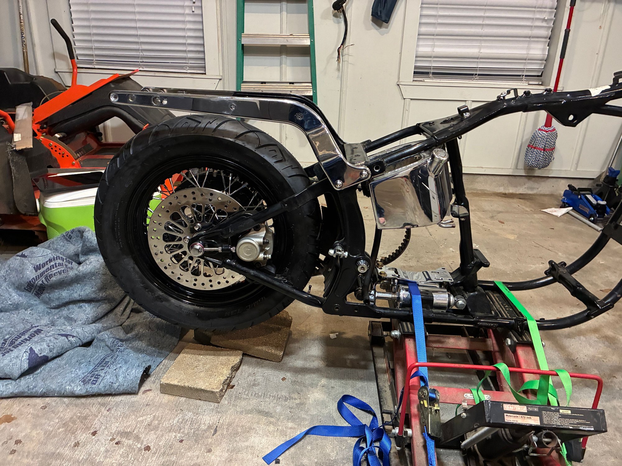

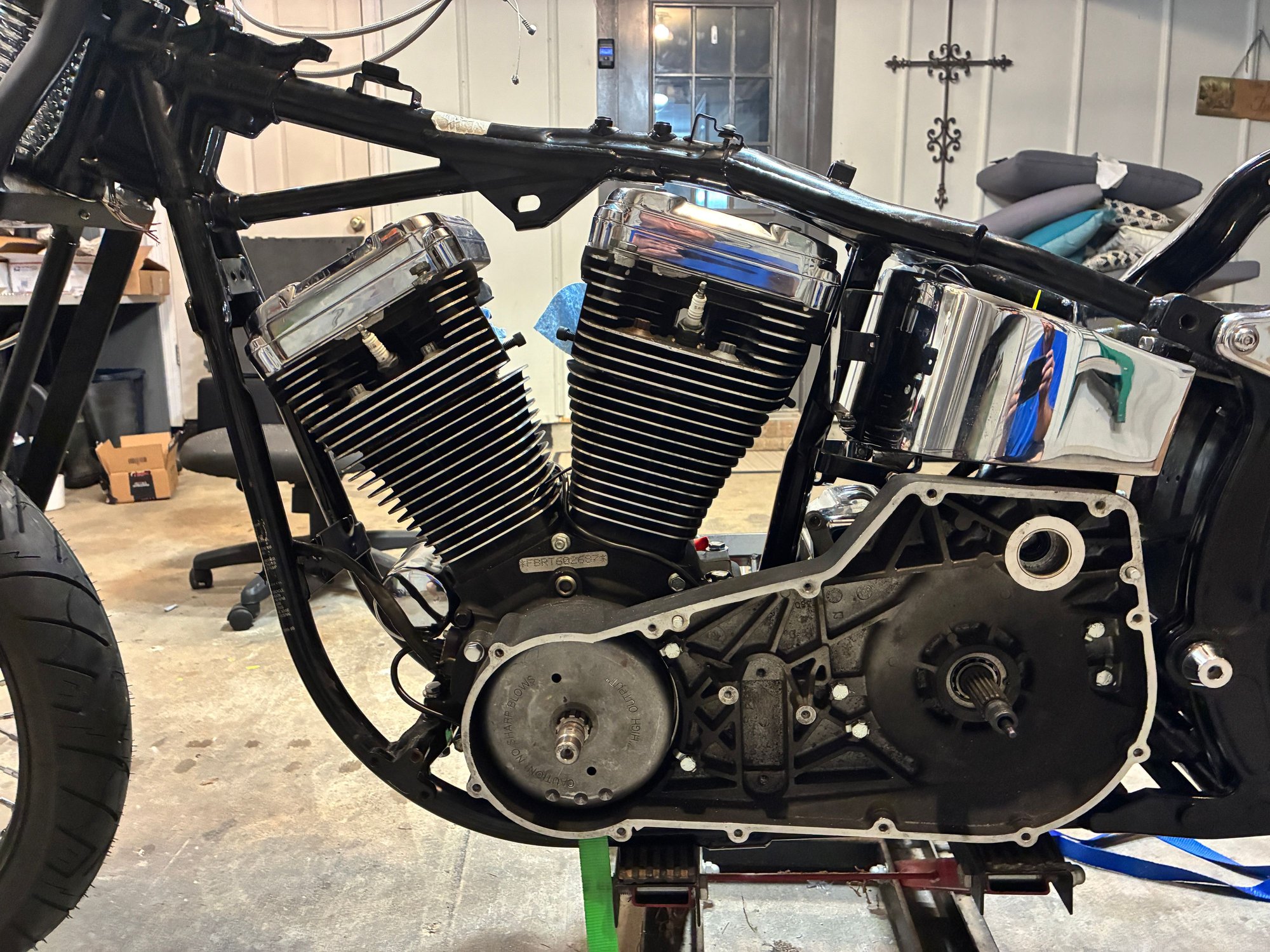

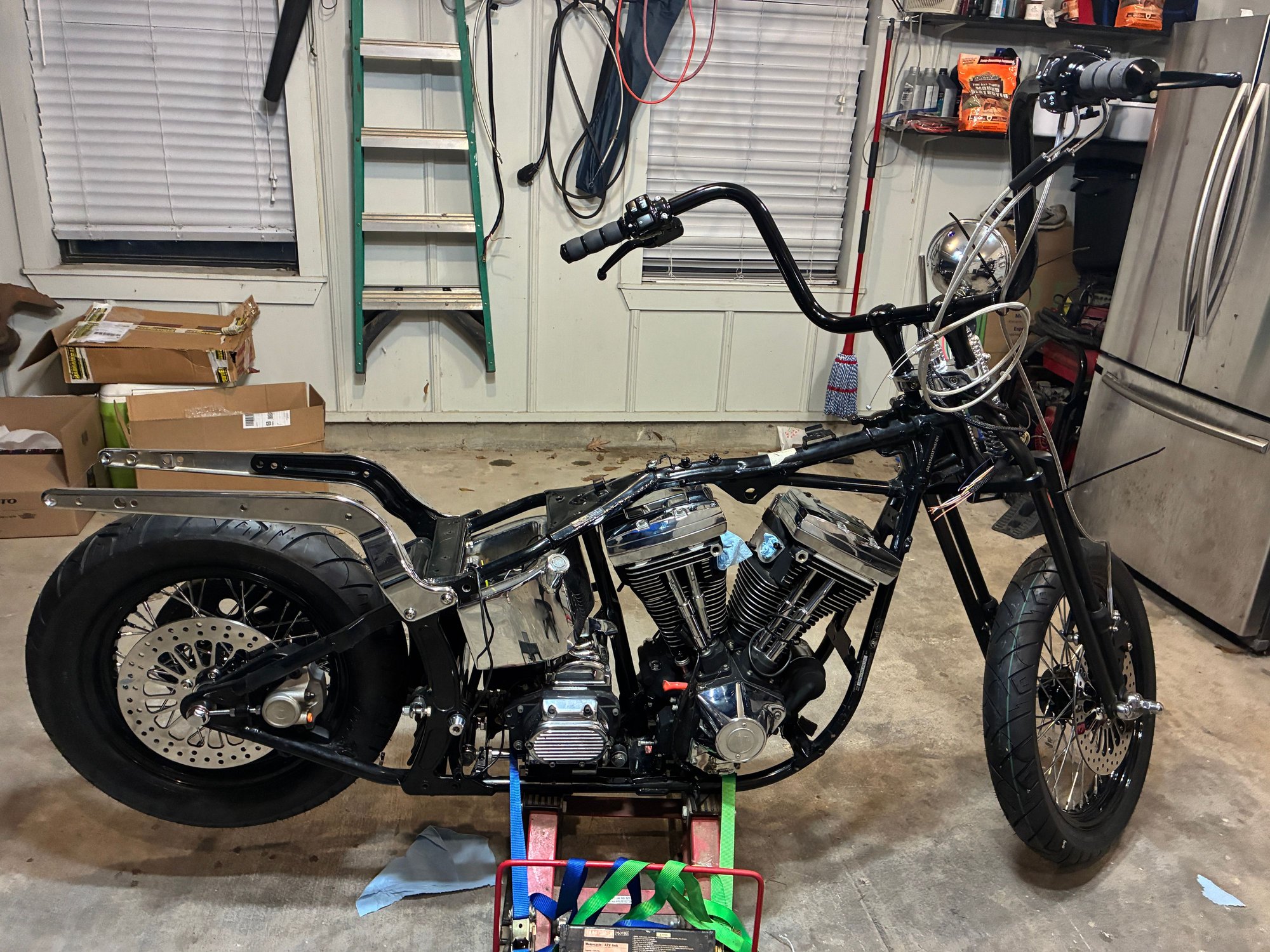

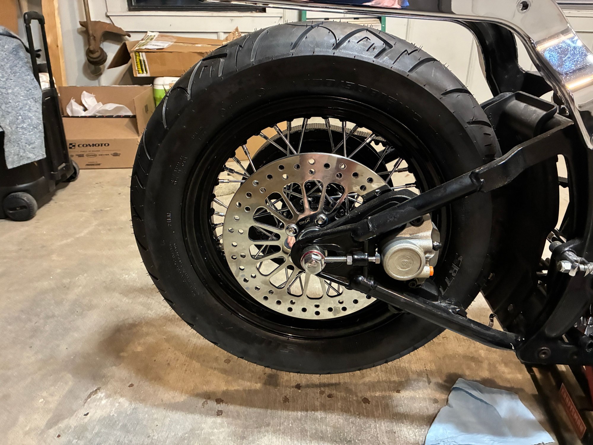

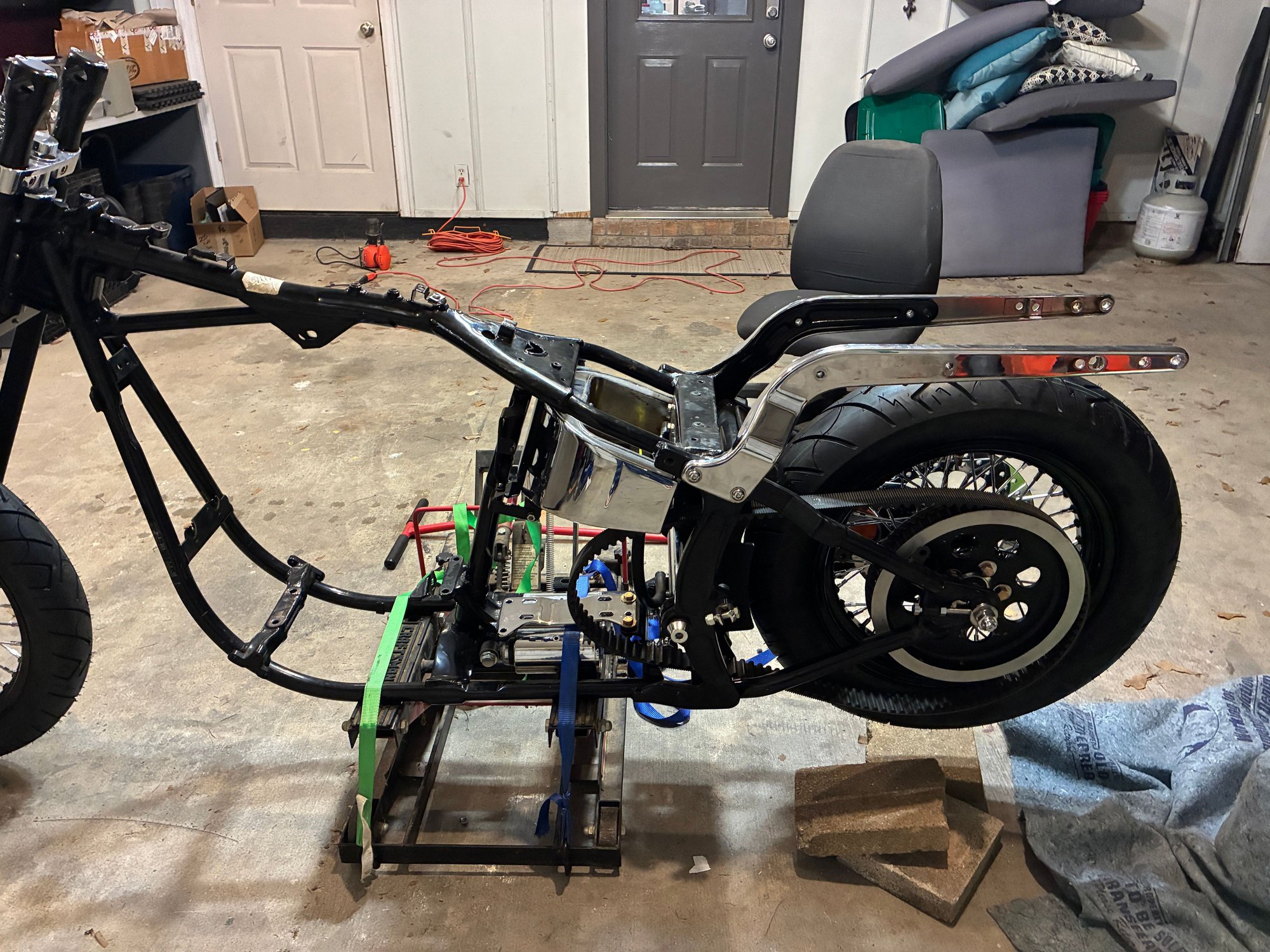

Progress as of last night.

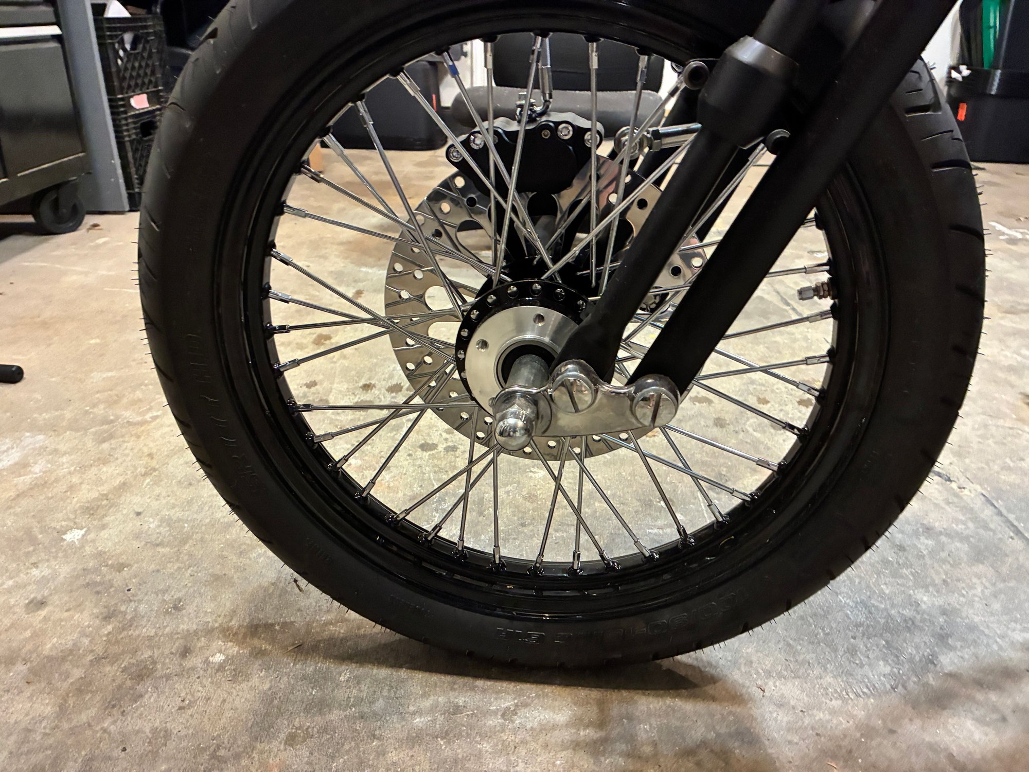

Love these wheels and brake setup.

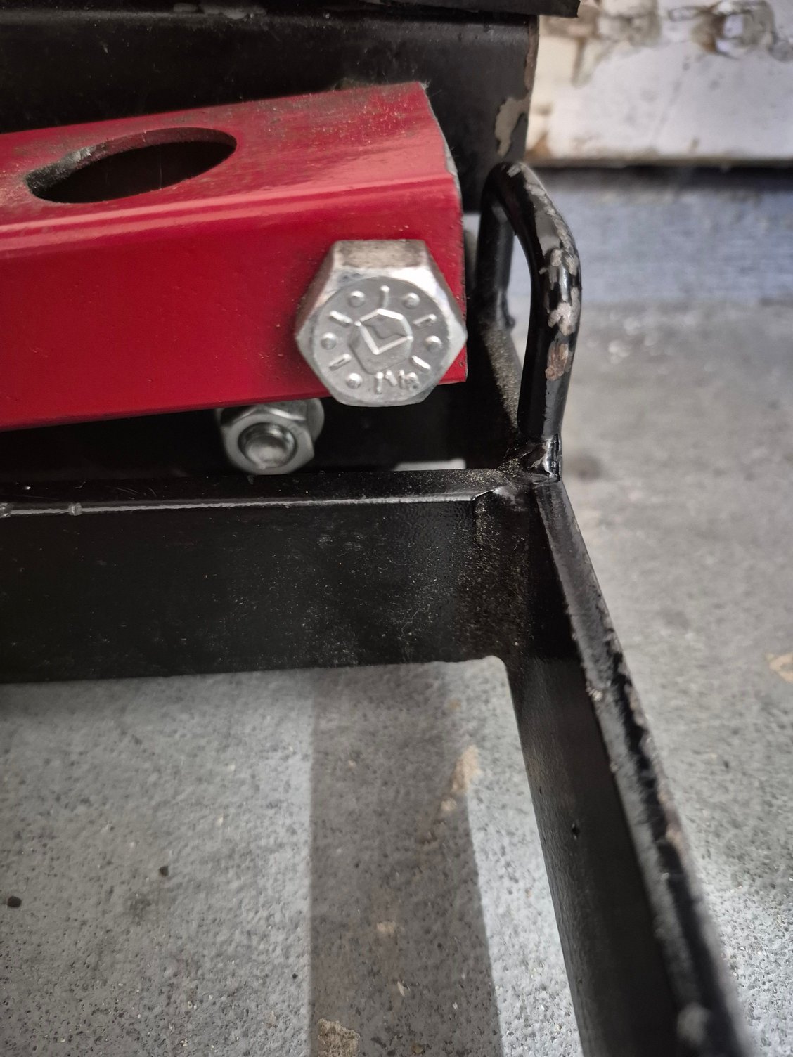

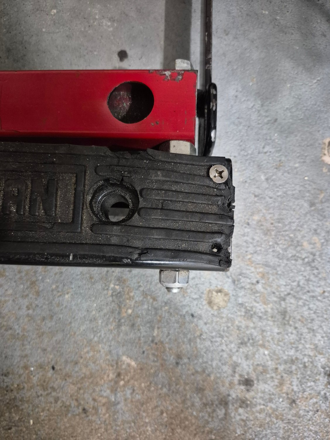

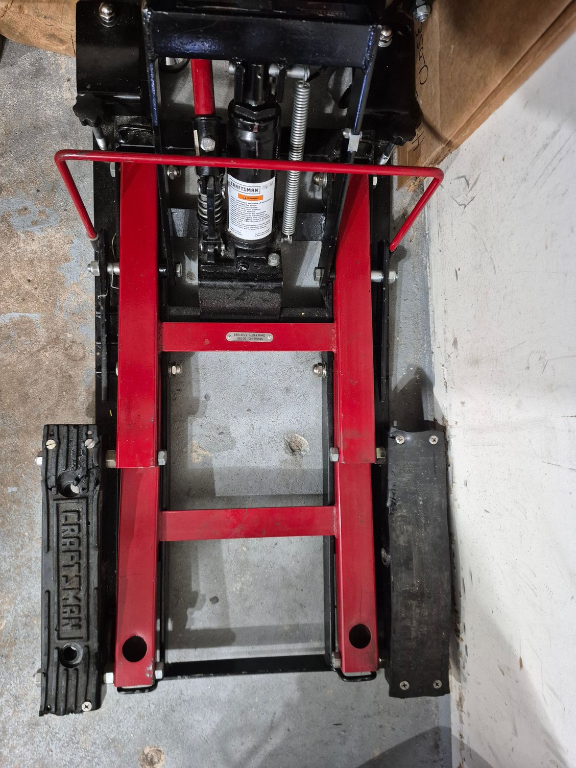

It's coming along nicely.. When you jack the bike up try to keep the rear pad off of the shock housings.. It ain't good for the shock seal and I believe it's what led to my 422's leaking..
Old Mar 4, 2026 | 09:34 AM
cwhite6's Avatar
cwhite6
Posts: 505
Likes: 240
From: Pineville, LA
Great advice. I moved it last night and I will need to check it this evening to make sure it is not on the housing. I am thinking about taking a couple 2x4's I have and putting some rubber mat I have on them. Then I can put them perpendicular to the lift pads so the frame rails can sit on them and be secure.

It looks like we have the same motorcycle lift, a craftsman. What I did was I cut the center supports out of the two pads (the connecting bars).. I then purchase some 6-in 12.9 heavy equipment bolts nuts and lock nuts and move the pads to the outside of the lift arm. Then drilled everything out to 17/32's.. By doing this you can get a lot more separation and better balance of the bike and not put the pads on the shocks.

That is a great idea. I will have to look into that.
Did something similar for my dyna. The perfect spot for where I wanted to position the jack was right where the oil drain plug was in the way (Dyna's have an oil pan below the trans), only had to move one of the support rails for a perfect fit. Nice mod.
