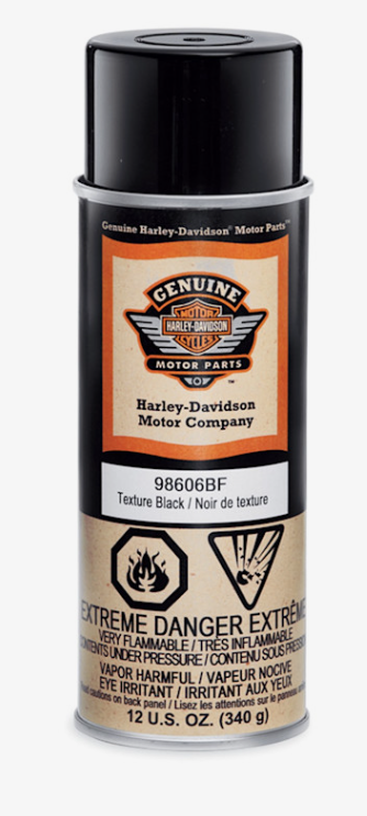

Originally Posted by Schex
Test compression and spark.
Go through the complete fuel system from the tank to the intake seals.
Clean and take care of the tank, whatever it may need.
Pull the petcock and clean or replace the screen (this is the fuel filter) or replace the the whole petcock if it's original.
New fuel hose, including cross over hose at front bottom of the tank.
New vacuum hose on the VOES.
Disassemble and clean carb.
Replace intake manifold seals.
Harley Texture black is a match for the engine and holds up well,
Texture Black, not wrinkle black.
No need for primer, just sand a little, clean and dry, mask and spray.
You can spray the cylinders, then scrape or sand the paint from the edges of the fins after it dries.
That paint is the only way to go for freshening up the motor/primary/trans. The results are phenomenal.

  2. I will definitely use your solutions for re coating the engine case and jugs. THANK YOU for the advice!
