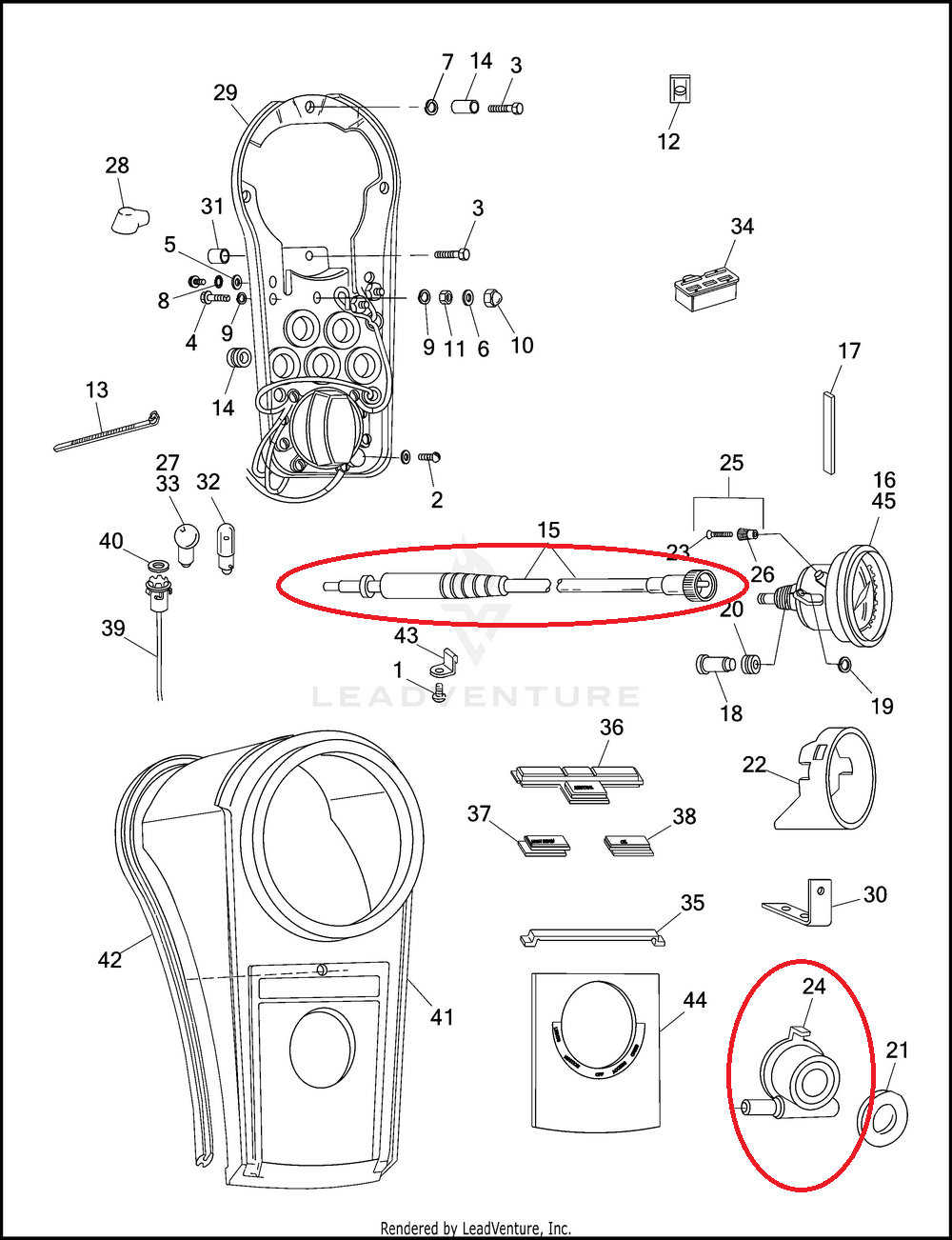

1995 bad boy Springer OEM mechanical speedometer.
You have mechanical speedometer, the sending unit is mounted on the left side of the front wheel. You may be able to purchase an aftermarket unit.
See diagram below for your specific bike, pay no attention to Jackie Paper as he provides bad information. The cable inside the cable assy may be broken and you should be able to find aftermarket for that too. I would inspect both the sending unit and the cable assy to see what is going on.
Ref:24
67166-88
DRIVE UNIT SPEEDOMETER Not Available
Ref:15
67024-84A
CABLE ASSEMBLY SPEEDOMETER Not Available
https://www2.vtwinmfg.com/left-side-...r-drive-1.html
https://www2.vtwinmfg.com/39-stainle...ter-cable.html

The speedometer drive is left on the front wheel. They wear out but there's no service other than to replace. They normally last a long, long time.
Usually you can remove the cable from the head, pull the chain out of the housing and grease it good as you push it back through the housing.
That is the only service to it. If greasing the chain doesn't fix it, then it's the head that has malfunctioned. Some of the other guys might know repair centers.

I had the little tang break off the sender and replaced it with a piece of tubing glued into the hole in the wheel. I've also taken two apart to make one, but it was winter and I was bored. Best bet if the cable isn't the problem is getting a new one. Be aware there are two different ratios - I think you need the 2240:60 not 2:1. Someone can confirm that

Have not looked in a while, but I think the front wheel sensor is one piece. Inner half spins with the wheel. Outer half has a bent tang that slips in a notch in the spinning part. I had that tang bend out of the notch so it would not spin the cable. I replaced both.
Connect bottom of cable first. Small slot set screw holds that in.
Lube and screw into tach.
Might have to rotate wheel slightly to mate square cable end into tach.

Beware - the drives have different ratios depending on your wheel size. Check before choosing.
