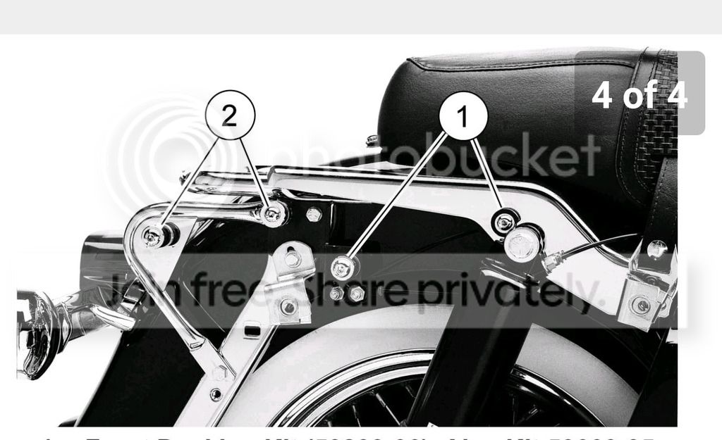

I having some trouble with this install. Does anyone have any pics of what the mounting hardware looks like installed without the saddle bags installed?
I have a 1996 Ultra classic EG
This is the pic that came with the hardware:
This is the bike with the factory tour pack hardware installed:
This is where it looks like the instructions says to put it but the pack will be way too low. Also, I think the saddle bag support has nothing to bolt to here except that one bolt that goes through the fender. Doesn't seem strong enough. Especially with stuff in the bags.

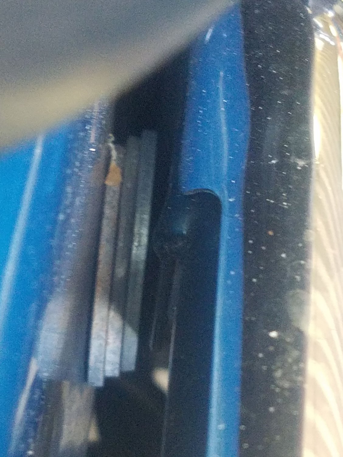

Fender washers to space for shock bolt

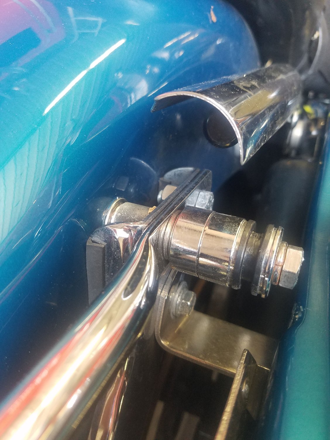

Goes on the top of bag rail

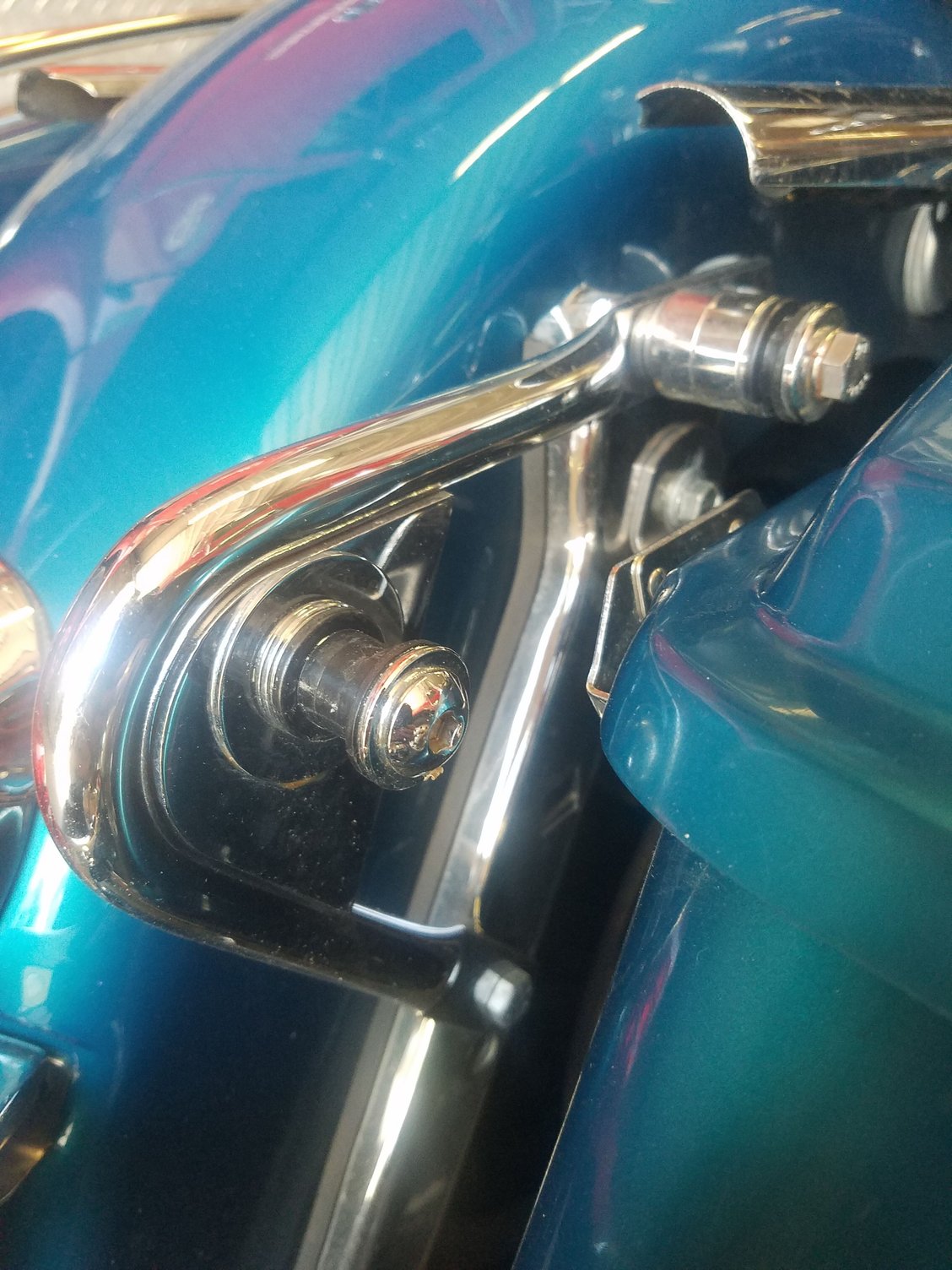

Full install, trunk sits a little lower but plenty of clearance

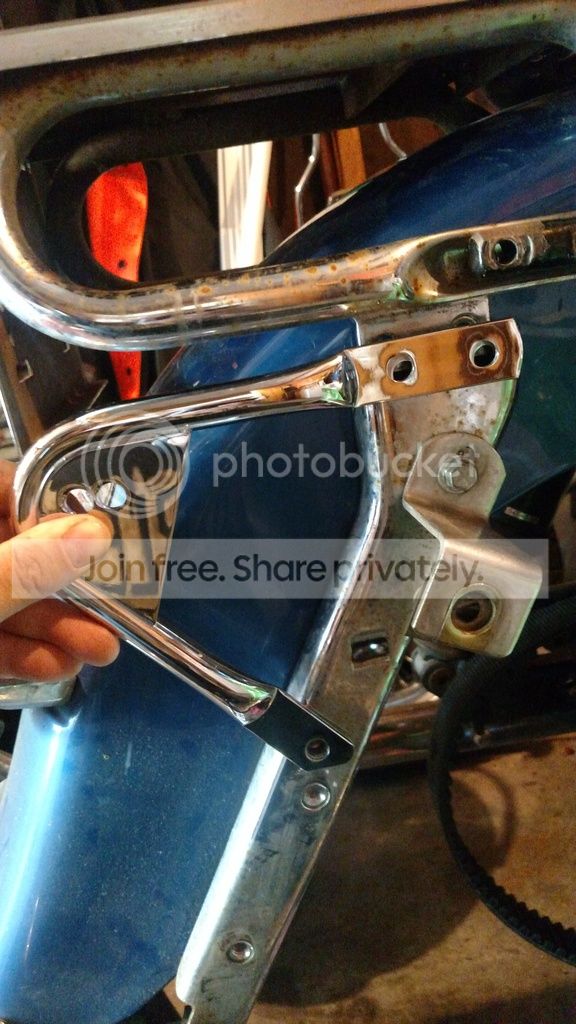

I appreciate this is an old topic and people might have moved on, but I found - and have - a pair of 'frame ends' that include the missing bolt holes for the saddlebag supports. They fill the gap in the photos above.
They have the same 'crushed tube' as the original racks do, but are just about 5" long with chrome caps. Two holes to bolt onto the frame, and two holes to bolt on the saddlebag supports. They fit under the chrome frame cover.
No idea what the part numbers are but they would give you that proper fender support.
If I can, I might be able to upload a photos of them. I would not have the saddlebags hanging on the fenders alone.
