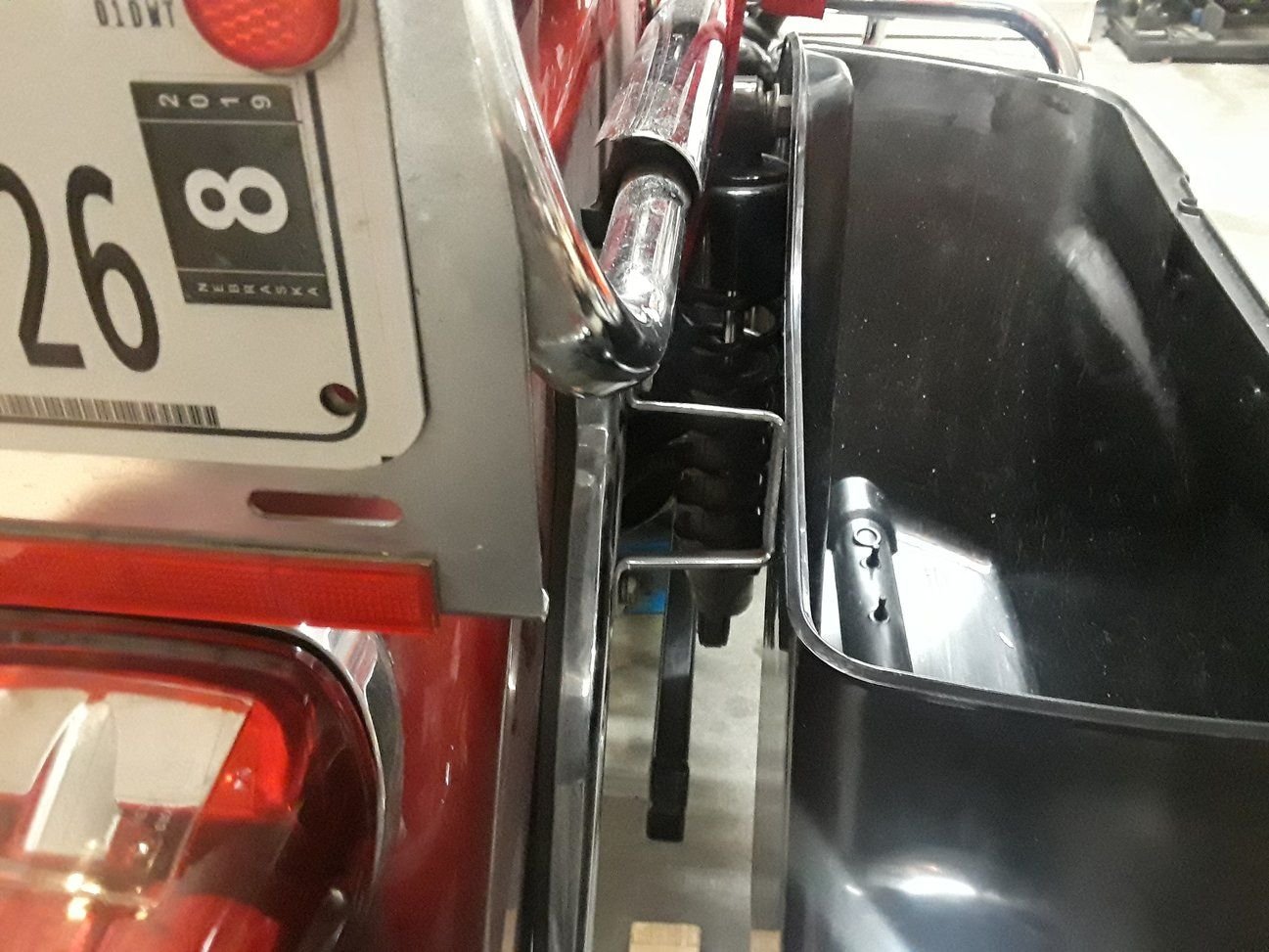

Did just go through the battery relocate / new bags conversion.
Not a whole lot to it, really. I bought a tiny lithium battery and fabricated an aluminum box to mount it under the seat. The bags (I went with cheapo aftermarket "one touch" style) fit without a lot of drama. Just needed to fabricate new brackets for the mounting bolts and cut off most of the old battery tray. I shimmed the grab rail bracket and the tour pack to ensure clearance from the bag lids.
Some pics:

I did it. Had to move the horn and use a smaller battery. Trimmed the right side cover and used Twinkie saddlebags.
had some metal bent for the battery.
do you need pictures from my 81 5 speed?
