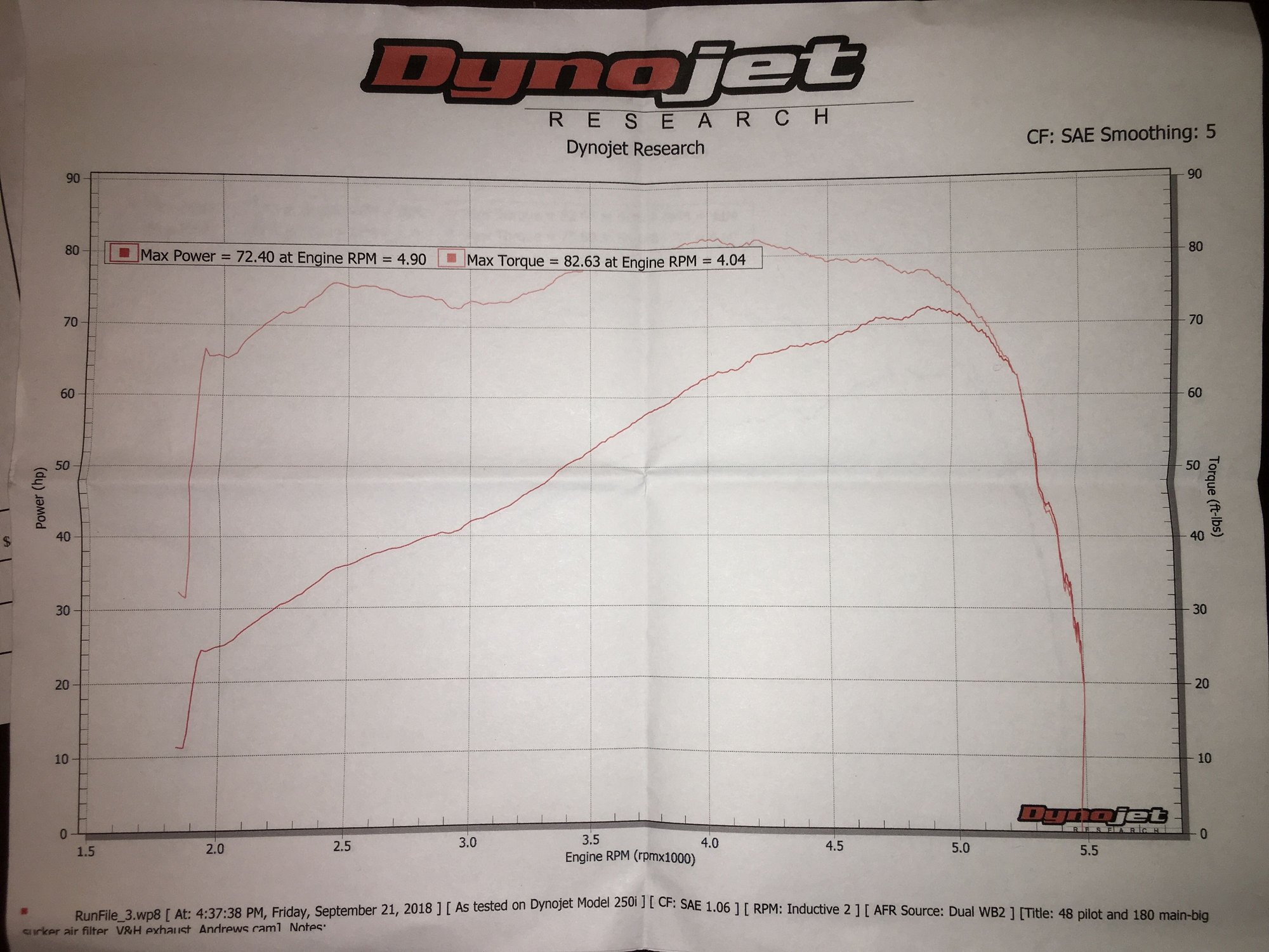

1997 Bad Boy
Andrews EV27
VH Big Radius pipes
Jetted CV
i bought some Johnson Hylift tappets to go with the build, but 2 of them were defective. It’s the $90 set of Amazon, buyer beware. Work and dyno tune by Custom Cycle Corner in Knoxville. Good people.

See that big dip between 25-3500 rpm.? Thats that VH pipe. They really do suck for performance...... I know cause I had on and mine tuned the same problem and could not get rid of it so I got rid of the pipe and put my old Python III"s 2-2 back on and it helped a lot.... Get your self a decent 2-1 and you'll see the difference....

Yes and I agree, just the pipes will probably stay as i like the way it looks.
