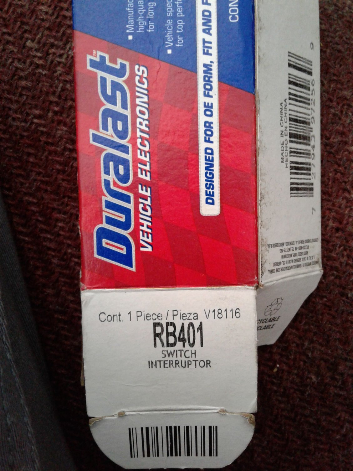

Autozone Duralast part number RB401 only $13.49. Works perfect. Insert onto mount, depress brake pedal and hold, tighten switch and go riding!
