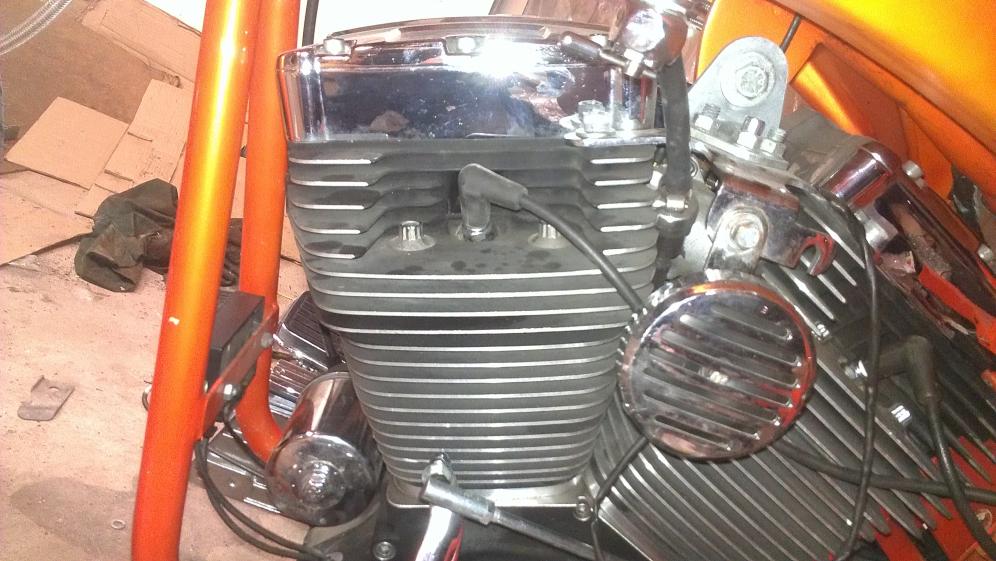

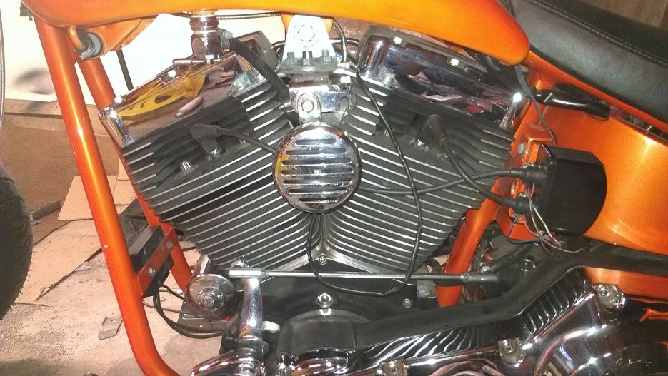

here ya go

That is a Twin Cam motor.

No its an EVO, not a Harley EVO, but an EVO. The two vertical bolts behind the rear cylinder are the giveaway, Twin cams have the bolts going through the tranny and into the engine. It could be a Rev-Tech or an early Ultima. You can check with them and see if they can help you.
You should have gotten an MSO for the Engine and Frame. You will need these to prove that the parts aren't stolen if you get stopped at a checkpoint.

Close but no cigar...it's not an EVO, it's a Fatso...Basically evo type cases that take twincam topend parts ...Delkron and a few others make them
http://www.delkron-mfg.com/products/...rankcasesFatso
Yea, those lifters look to be oriented like an Evo but definately TC heads and jugs.. I agree with the Fatvo.. Sounds great on paper, I have no experience with it..
