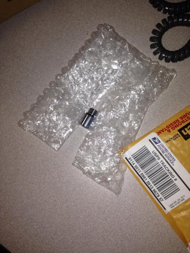

Originally Posted by Proud Marine Dad
Jammer, I have some extra hex head plugs laying around from my last evo project. They came in a three pack and I only needed 1. Don't have my evo anymore...........I know, I know I don't want to hear anything from you guys. PM your address and I'll send one out. They are just gathering dust here.
Your awesome Marine dad! PM sent! This Seabee Thanks you!
Dude your awesome! PAY IT FORWARD IS YOUR MOTTO! You rock. This is like the first thing I ever got free... You have spurred me to look for opportunities to help our brothers and sisters! Many thanks again!!!! I OWE YOU A BEER.... if your in Daytona for Biketoberfest...
