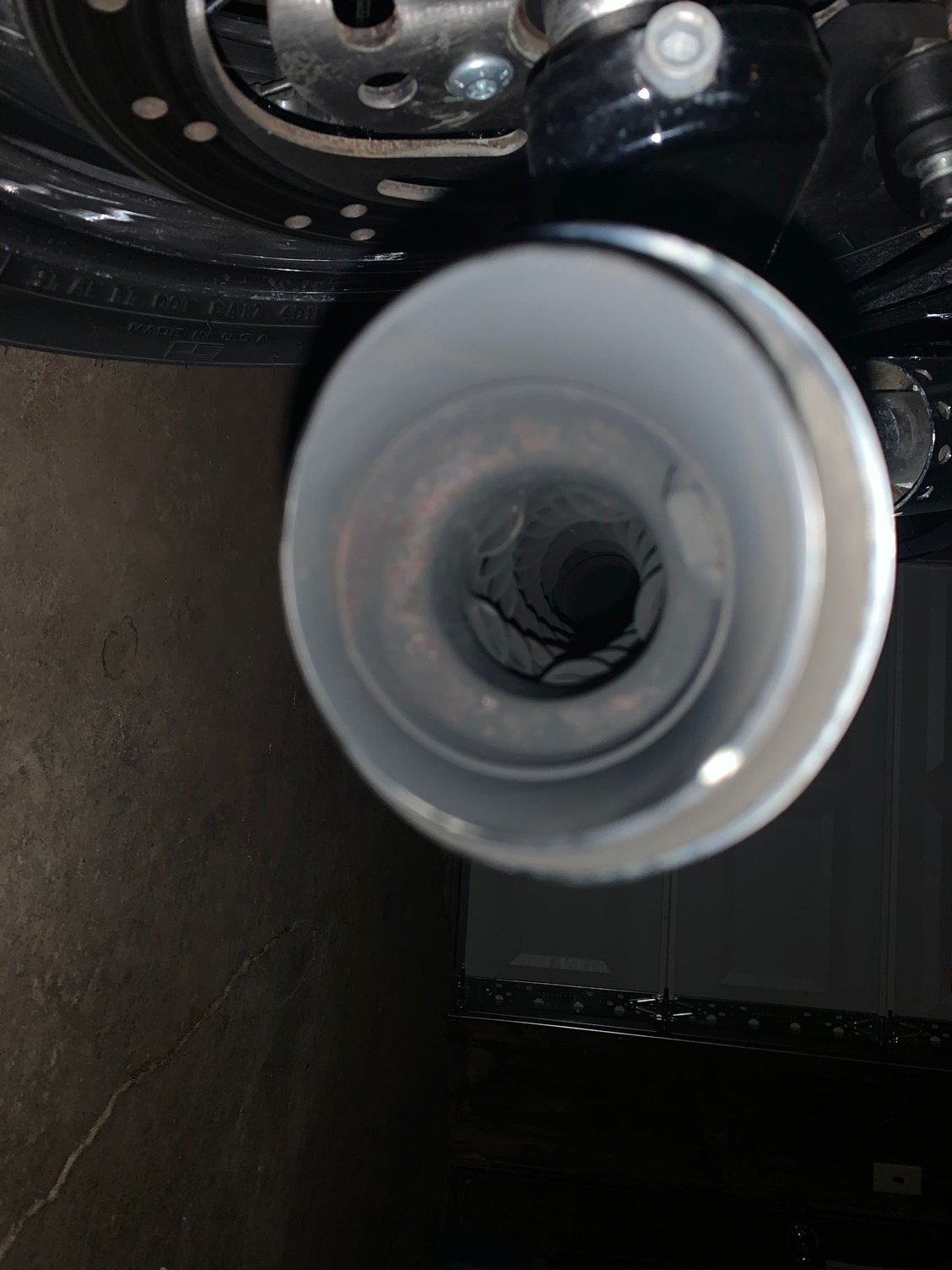

May seem like a obvious answer, but I really don’t know what I’m looking at. I bought the bike recently, didn’t bother to ask if the baffles had been removed but i notice its considerably loud...
V&H pipes

yep, see that spirally looking thing up there? that's your baffle. if it's considerably loud, you probably don't have a cat in the headpipe.
thank you. Now, without the cat converter, are there any issues in not having one?

1 You are breaking Federal law by removing the cat. ( In P.A never heard of anyone checking for the cat.) I replaced the exhaust system the day I bought the bike.
2 The bike will run much cooler and the exhaust will be free flowing restrictive cat in place.
If you replace the air filter with a free flowing setup the bike will mostly be running very lean. Buy a tuner or get it tuned by somewhare other than Harley.
3 You will have more power, the bike will run better, enjoy it.
