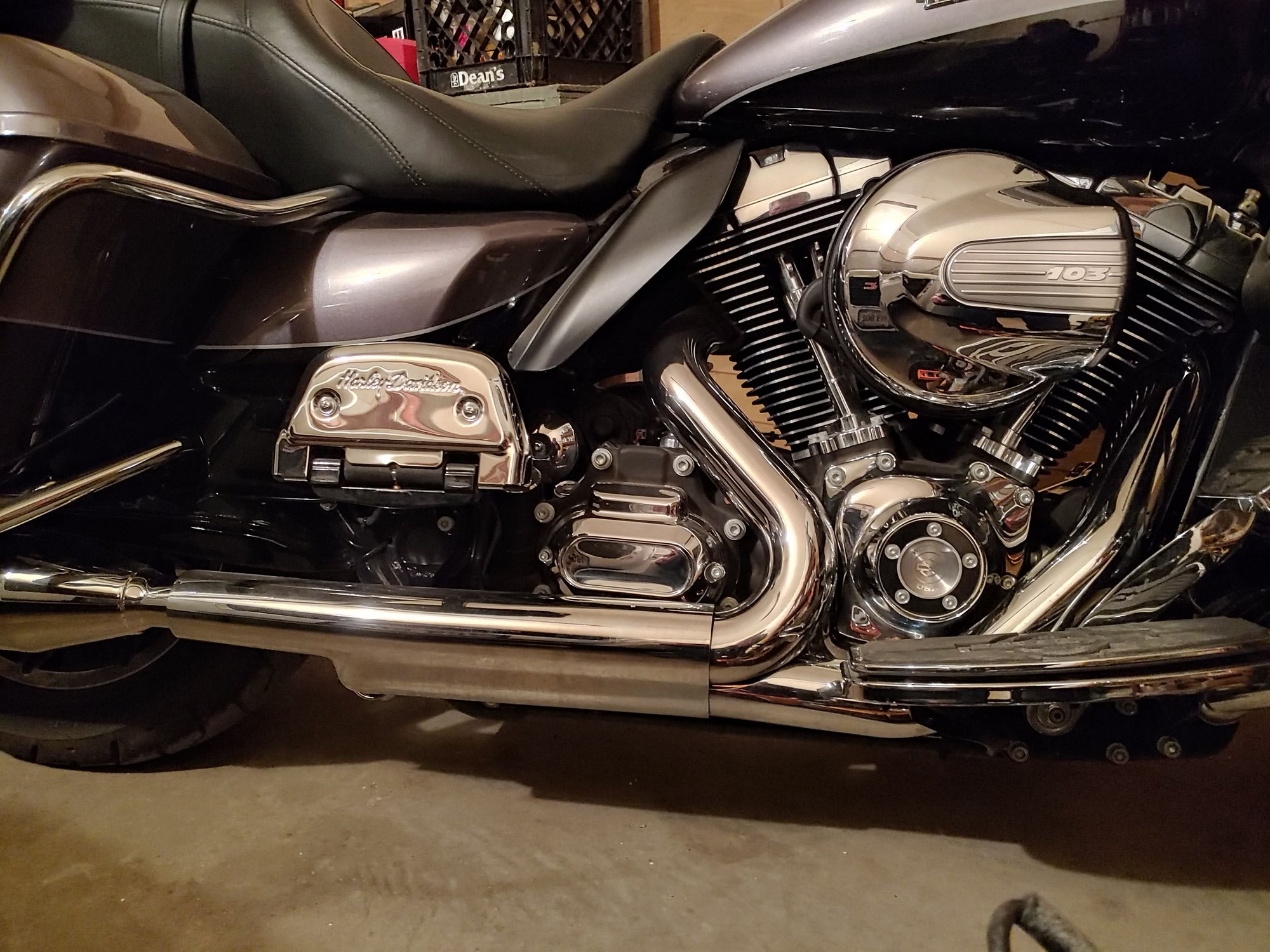

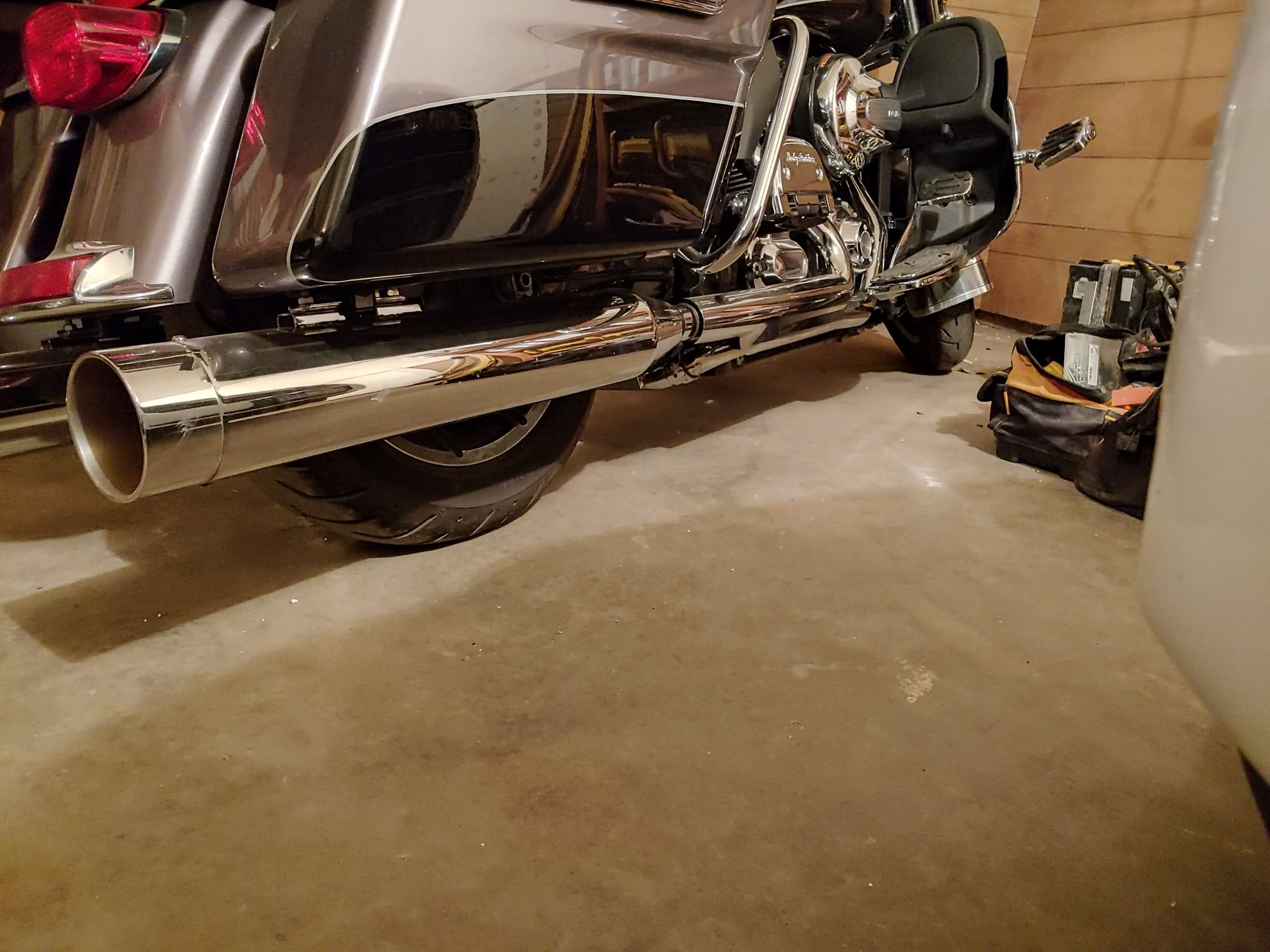

Greetings! Could someone please help me identify the headers and mufflers in the pictures. They are dual headers on a 2014 ultra Limited and the Mufflers are 4 and 1/2 in in diameter. No visible identification or markings anywhere . Thank you in advance

Look like stock head pipes but would need to take heat shields off to be sure. Don't know on the slip-ons but should be a makers mark or part number somewhere on them.
I thought the stock Harley exhaust where. 2-1-2. These are true duals. I have the stock headers from the bike and these are not it. Yeah there's probably a mark somewhere but I was hoping that someone would recognize them and I wouldn't have to take everything apart to find it. Thanks for the reply.

Correct, stock is 2-1-2 but unless you take the heat shields off you cannot see that. The x-over is right under the mid cover and makes it appear as they are duals.

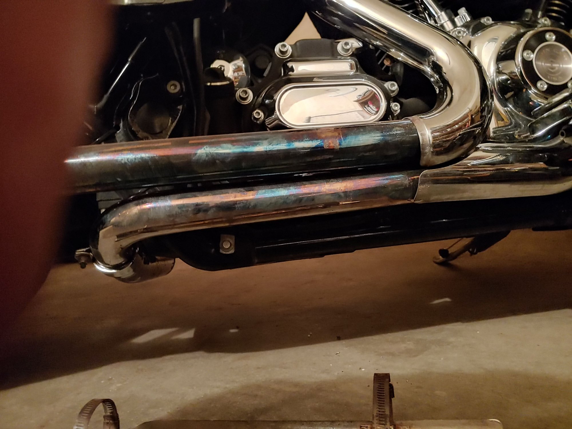

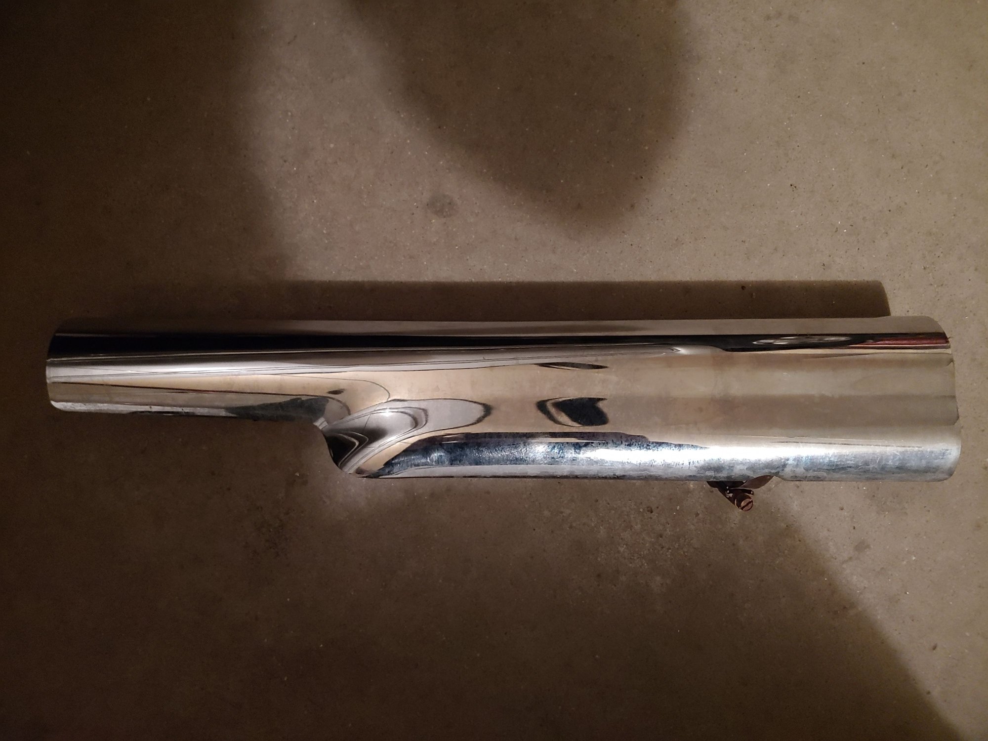

Heat shield removed
Lower heat shield

There was a "true dual" head pipe that reused the stock heat shields to save money but I can't remember who made it. If there are no markings on the mufflers they could be generic no names off eBay or Amazon.
