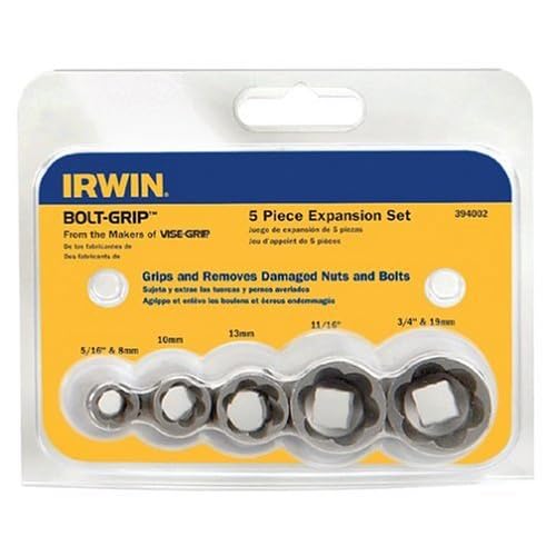

maybe ?

Originally Posted by deni
maybe ?
My nuts are fine (insert joke here) but there is a tool that I don't have. I so gotta get me a set of those...sh%t I just got back from OSH...going back 2mro...

It's worth a shot. I bought a set off ebay last night. Will try it when they get here and see what happens I don't have 6 sided sockets to try with so this will have to do. I hope.

not being a smart a$$ or anything, but... using the incorrect tool is probably why this happened in the first place. just buy a cheap correct socket. like $ 2.00

+1 ! goto Auto Zone, Performance or any of the auto parts stores..... singles hanging on the rack- the six point will give you more flat contact area....
