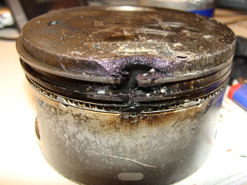

mrnone's Avatar
mrnone
Joined: Feb 2010
Posts: 1,220
Likes: 24
From: here
Default eureka I found it...
you think this will make the dipstick blow out?
Old Feb 8, 2010 | 10:09 AM
rbabos's Avatar
rbabos
Joined: Mar 2007
Posts: 3,706
Likes: 7
From: Woodstock, Ont , Can
Test the breather umbrellas by trying to blow into them. They should only work one way. If you can blow into either one the pressure will never drop to a near vacume state and venting will be aggressive enough to blow the cap off. Just did a 113 build and had James gasket set with it. Tested the umbrellas before bolting it together. Both leaked. Fired them in the garbage and put the stockers back in since they only had 13 k on them. The James name is embosed on the edge of the disc and this causes a warped area that leaks. DUH.
If you've covered all the other basics, do a leakdown test on the cyls, since breathers are only capable of so much flow and after that put pressure on the cap. Rings can fail at low milage also so don't assume they are not the problem.
Ron
