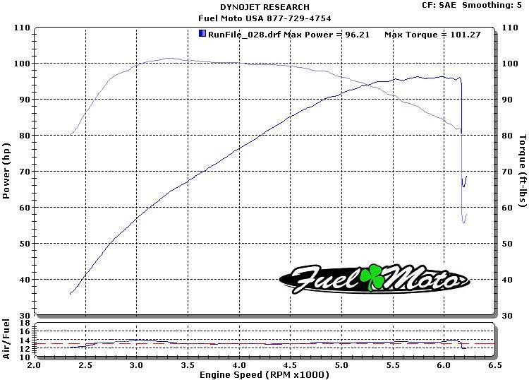

I was looking for the same thing and I went with the Wood TW-555 setup. I have a 2-2 exhaust and a Stage 1 air filter, but is otherwise stock. It seems to have a little more torque than stock from 2000-2500RPM, but pulls hard from there all the way up to redline.
Here's a dyno chart off the Fuel Moto website:
