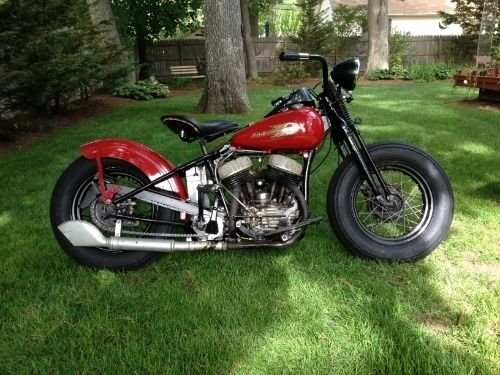

So I have been talking about the '46 WL I bought in the fall, but have not really posted anything about the bike. Here we go:
Here is how she looked when we bought her in November. We bought the bike for a good price with the knowledge that we were only getting a Bill of Sale and the transmission was pretty much toast. We got lucky and the previous owner could not get it started, that helped with negotiations:
It only took me a couple of days to get the bike started, ran well, held an idle and all of that. Transmission was a no go, third gear only. NYS DMV took a couple of trips but we now have a clear NYS Title. Since then, the goofy bicycle front wheel is gone and the transmission has been rebuilt. I also mounted the front fender and scored a nice front wheel from Ebay. I have also been spending time blacking out alot of the chrome as a '46 should be a plain Jane. This works well for me as I tend to black out my bikes, this time it is to be Factory Stock!!!
We did clutch gear, high shifter clutch, 2nd gear, 1st gear, kicker gear, shifter forks and tripper bolts. Plus all the little things in between. 1st and 2nd were NOS, scored one at AMCA meet in Daytona and the other on Ebay. The rest aftermarket but made in USA except kicker gear. The picture in the Palmer restoration book that shows what a messed up high shifter clutch looks like, mine was worse!!
Yesterday everything got buttoned up and we went for our first ride!!! It was a good day. Transmission worked perfectly, bike runs well. Had to keep it short, 30 year old tires with dry rot not so good for long rides. New tires are in hand, rebuilding the hubs and then mounting new tires and good to go for a decent ride.

New sneakers:
Not sure if the front fender is staying off or going back on. Did about 15 miles yesterday including a stint on the highway. Pleasantly surprised I was not eating rocks the entire time. It just might stay off.
Replica Firestones are hot, just what the bike needed.

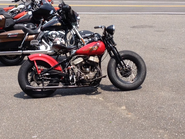

Here she is out and about. Did a short 20 mile put on Saturday, no problems. Sunday went to my mothers to show her the bike and do some work at her place, she had not seen it yet. Then I took a nice 45 minute back road ride to one of the local hangouts. Saw some people I know and had a nice afternoon, then took the very long way home, about an hour and twenty minutes. Everything doing what is supposed to do, I am very happy with my lil' Red 45 this morning.
Quick funny, when I pulled up couple of guys were hanging in front talking about a tasty Shovel, one guy owned it. Apparently what was said as I was pulling in was "so much for you having the coolest bike here!" They came over to talk about bikes and told me the story, good times.
