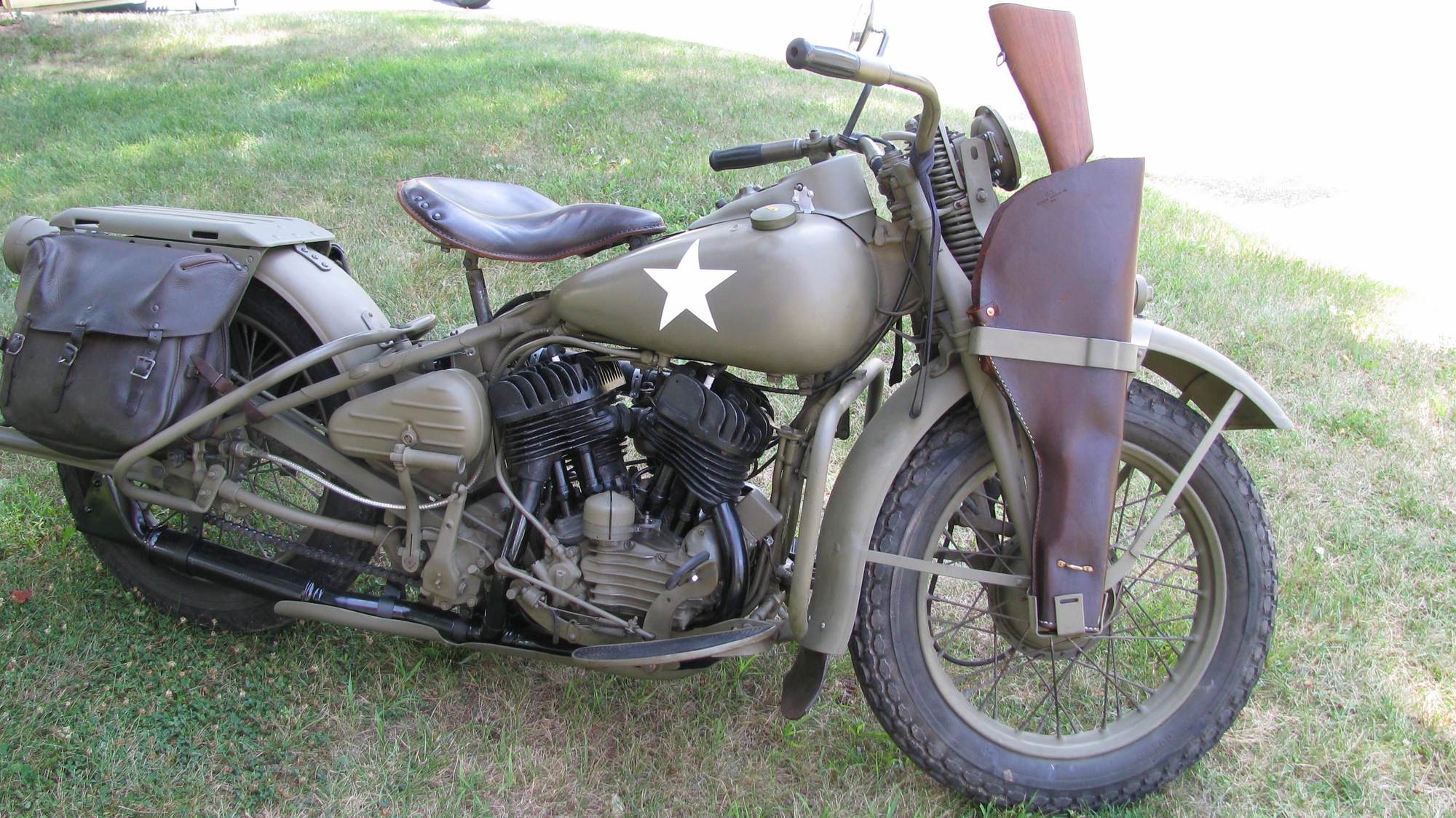

eric - I had some years back an un commissioned WLA that by palmers book was around 300 to the last one built - knowing it was not commissioned by the tompson was still real it came out of a surplus sale sitting in the back of a duce and 1/2 covered truck it was a 60,000 or 70,000 chassis don't remember exactly

Nice bike John. In the late-70s and early-80s I bought and sold eight 42WLAs and a 43WLC although none were in military trim. The first one I bought had been chopped and it was the first bike I owned with a foot clutch.
