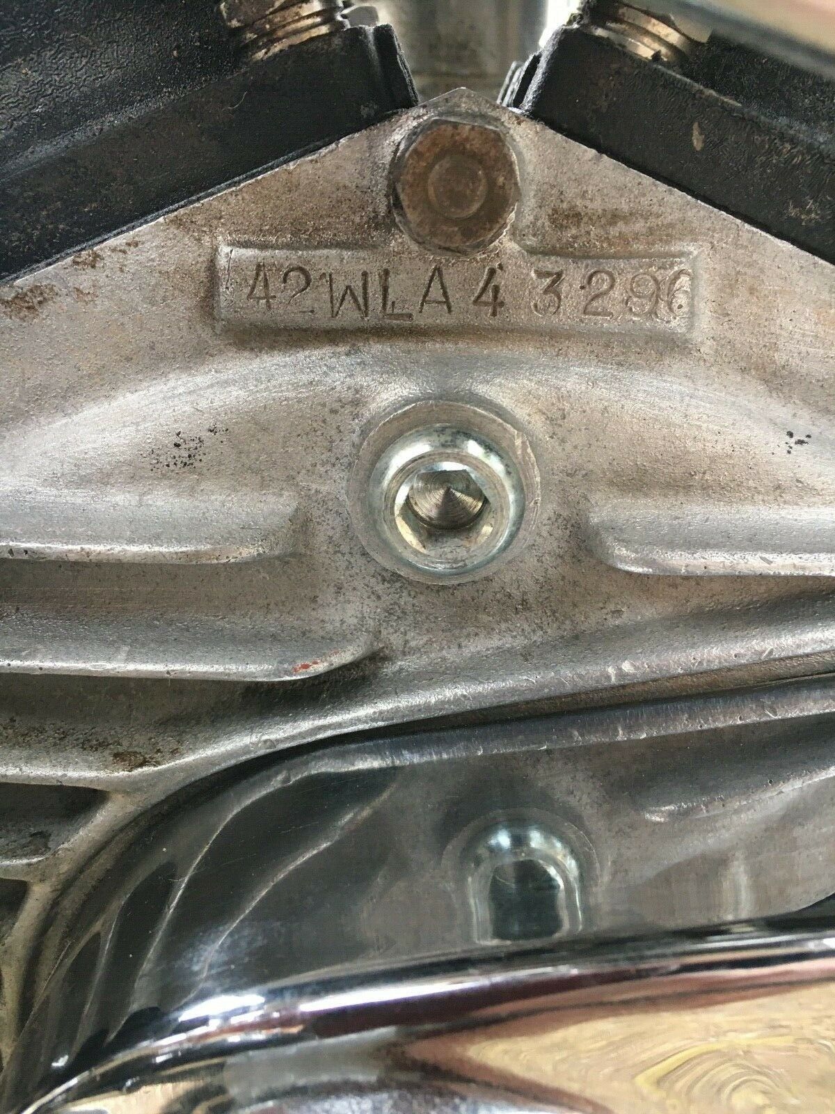

How about this 1942 WL?
Seems like the last digit is kinda crammed in there. Would appreciate your opinion as this bike is for sale locally.

Do some Google Image research on VIN #'s, those do NOT look like the correct font for the factory. There is also a website with a complete library of known good numbers for comparisons. I would walk away from that VIN, good luck.
That is the second version I’ve seen of that serial number.
The first version, which appeared authentic, I saved photos of a while ago. And I also saved photos of the belly numbers.
But as for the photo of that second version, I agree with Architect and the characters are not consistent with factory stamping for a 42WLA. Notice the 4s are sans serif and have an open back. For 42WLAs, at that stage of numbering, the 4s usually had a closed top and a serif across the base. (Later in 42WLA numbering the 4 changed to open top with serif across the base.)
Notice the 2s are sans serif. They normally had a vertical serif at bottom right.
The letter used as W is wrong and it looks like M upside down.
Notice the 3 is sans serif. Normally it had a vertical serif at top left.
Notice the 9 and 6 are a round-back style. Normally for 42WLAs the 9/6 had a straight back.
Just out of curiosity, what are the belly numbers?
Eric

The case numbers are definitely incorrect. I enlarged the the first picture and you can plainly see the last 6 is overstamped on top of a 9. And, of course, the fonts are incorrect. And the upside down M really looks ridiculous.

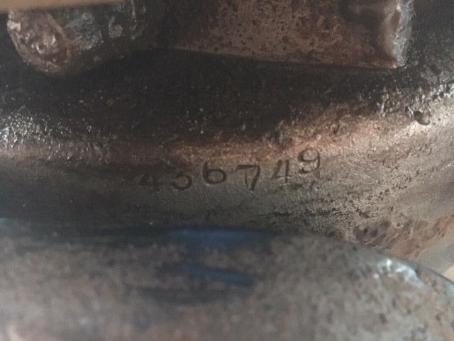

As for belly numbers, here they are. Not sure the fonts on them are correct either.

I have a photo of an authentic-looking version of that SN and I can email it to you if you wish. I sent you my address via PM. The BNs are 43-25+++A and they appear authentic so I could send you a picture of them in full as well. Why is the letter A at the end of the BNs? I do not know for certain but in this instance I don’t think it’s a concern and I have many other examples of it with BNs that appear factory-stamped.
Re the BNs you posted, they look like 43-6749? Some characters aren’t clear but I can’t see anything wrong at this stage. Decade 4 is probably sans serif and I’d expect it to have an open back. That type of 4 was used in the BN decade position for 1941–46. The 3 probably has a flat top and no serif. The 4 and 3 are often done with a tandem stamp and line up neatly with each other.
I don’t see a dash or hyphen in the R-H BN but I don’t think it’s a concern and it’s not the first time it’s been missing for 1943.
Sequence 6/9 is the round-back style I’d expect for 1943 BNs. (H-D used more than one type of round-back 6/9 in BNs over the years.)
The 7 looks normal for 1943 and it was also used in BN sequence portions for several other years. Notice it is sans serif and also notice the style of back.
Open-top 4 is normal in the BN sequence portion for 1943. Notice the serif across the base.

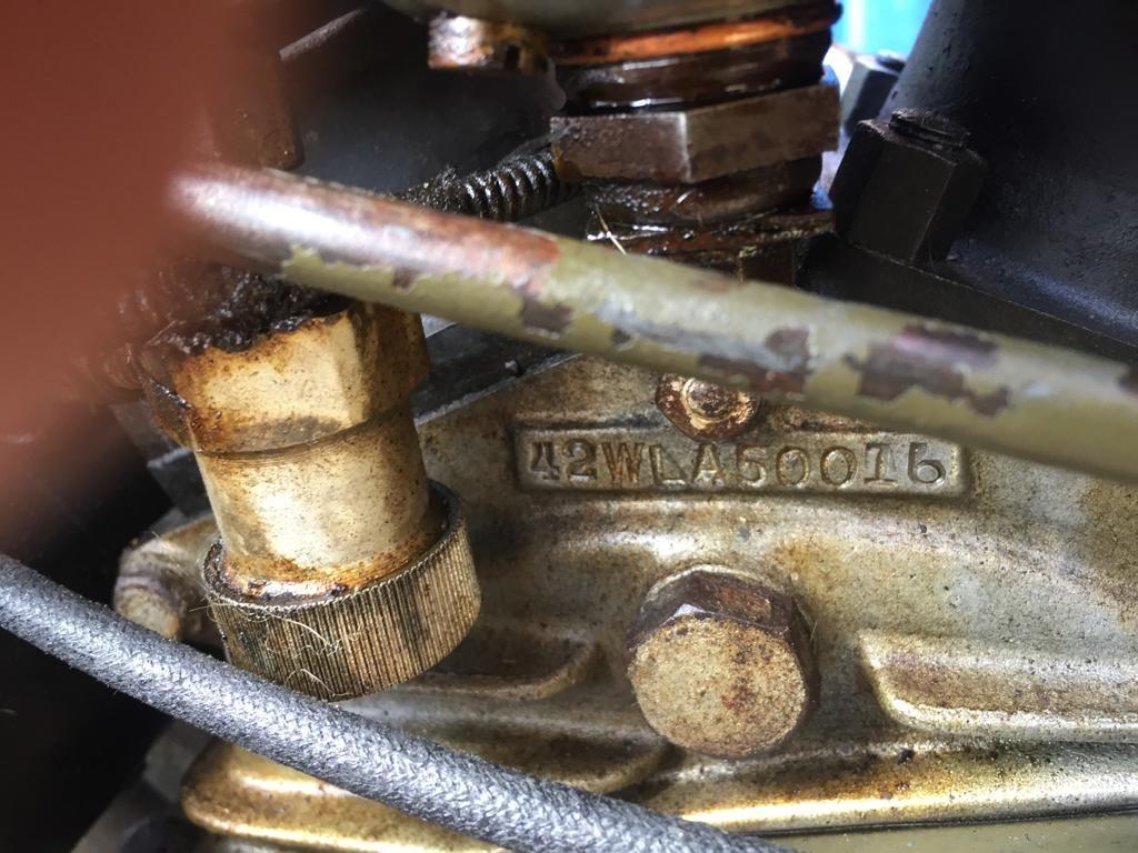

Just a question about a serial number on a Harley WLA I’m thinking of buying but unsure about the numbers could anyone help?
Thanks in advance!!

Speeding Big Twin is our resident expert, but I will take a swing.
First, as this thread started, too many numbers. Should only be four digits after the WLA.
Then comparing the characters to the font on my legit '46, the 4 and W are not an exact match. The top left of the 4 has a little too much curve and the W seems a little tall. The bottom line of the 1 also looks long.
