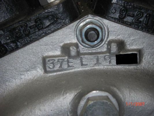

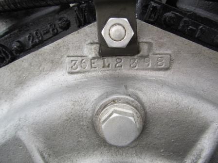

I agree your number boss doesn’t look altered.
I’ve seen those two EL engine numbers before and I can’t see anything wrong with them. Obviously two different 3s were used and both of them are different again to the 3 in the 32R+ I posted.
In the 36, the 3s are a type that is sometimes referred to as a long-diagonal 3. The earliest I’ve seen it is on prototype Knuckleheads that had 1935 engine numbers. (At least four prototypes were produced.) That 3 is also found in engine numbers of production model Flatheads for 1935–early-37 and on production model Knuckleheads for 1936–early-37.Here it is below on an early-37 Knuckle. Also notice the seriffed L etc.
But during the 1937 model year H-D changed a lot of engine number characters as demonstrated by the 37EL19++ you posted.
