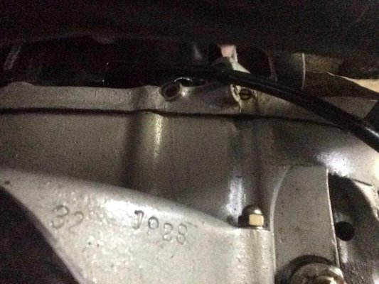

Did you check the belly numbers? If you’re not familiar with them, look under each crankcase half near the outer edges and somewhat toward the front. The belly numbers may be formatted similar to the following example: 33-1234.

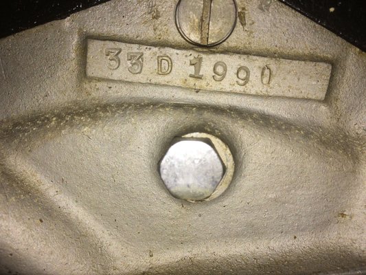

I've checked the engine number - 33D1990 - it looks original but will send a photo when I get back home. Will also do the same for the belly numbers.

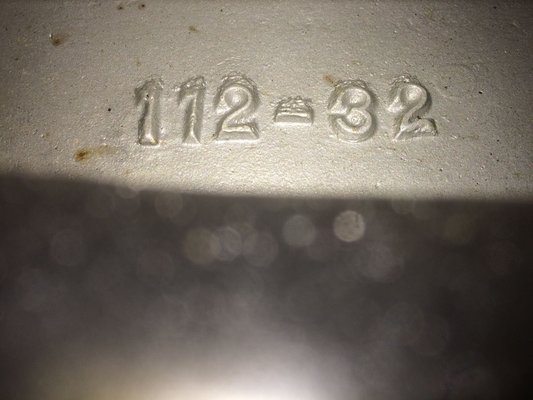

I have a photo of that 33D engine number. I saved it a while ago but I’m not sure where from. (Perhaps eBay?) The only other picture I saved is posted below. Notice the air intake/air scoop the bike had at that time. Also notice my red arrow. Above that arrow you may find casting number 112-322 and I’ll come back to that later.

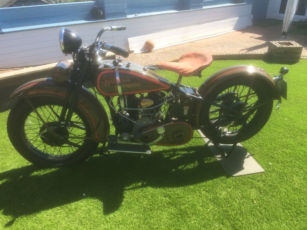

Your exhaust tailpipe is similar to the type first used for 1934 models but the cut at the end looks like it may be at the wrong angle. The toolbox seems unusual for 1933. A cylindrical one was used on 45s for 1929–30 but a wedge-shaped toolbox was used for 1931–34. The tank graphics aren’t consistent with 1933. Normally for 33 we’d see ‘Harley-Davidson’ but in smaller lettering and on each tank I’d also expect what H-D referred to as an ‘Eagle Head’ transfer. However, at times some features on export bikes were different to those used for domestic machines.
The main problem is that AFAIK there was no Model D for 1933. And your engine is an R-series as opposed to a D-series. R-series had a horizontal generator as I mentioned earlier and the left case had casting number 112-322. But the D-series had a vertical generator and the left case casting number was 112-29B (and it was in a different position to 112-322).
Also some characters in your engine number are not consistent with factory stamping for 1933. Your 3s have a vertical serif at top left but for 1933 I’d expect 3s to be sans serif. Your 9s are fully rounded whereas I’d expect them to have only a slight curve and your 0 is a lot more narrow than I’d expect.
The belly numbers may tell us more about the model year of the cases.
Is the engine number on the East German registration document? Does the document say anything about RL? Did the seller explain why the engine number is stamped D?

Have managed to get those numbers which may help to identify the bike further.
Old Oct 11, 2018 | 04:24 PM
village craftsman's Avatar
village craftsman
4th Gear
Joined: Oct 2018
Posts: 8
From: Dorset - UK
Hi Eric,
Hope these photos provide a few clues!!!!
Cheers,
Bob
