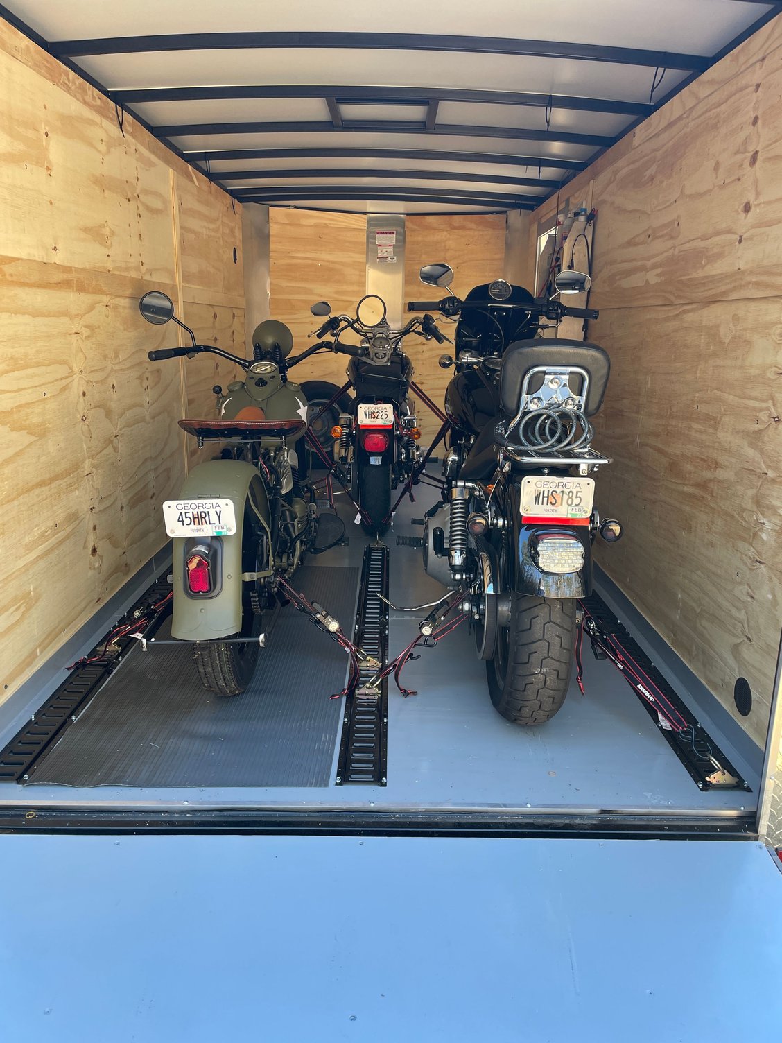

Bikes are in the trailer. I'll check pressure tomorrow.
Notice the rubber mat under the 45 to keep the floor clean
