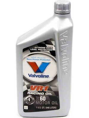

What are are most using in the transmission? This is for a WL, 3 speed. Not to really start an oil thread. But do most use oil as the manual says or something other. Not interested in brands but weights.

This is all we use in the shop for many years engine and trans any bike any year - real mans bike not the copy’s of a jap bike that copied Harley and then to most a surprise Harley copied the bike that copied them - go figure

John, Thanks, I just happen to have some on the shelf. I was kinda wondering if people were using a gear lube. I will use this!
Thank you very much! John

All transmissions today do not use any brass like bushings and Harley have plenty of brass - gear oil eats brass
GL5 is corrosive to brass and the transmissions using it last 1/2 as long -
note to the oil arguing crew they know all about gear - i dont care what you use - i was asked a question and answered it
