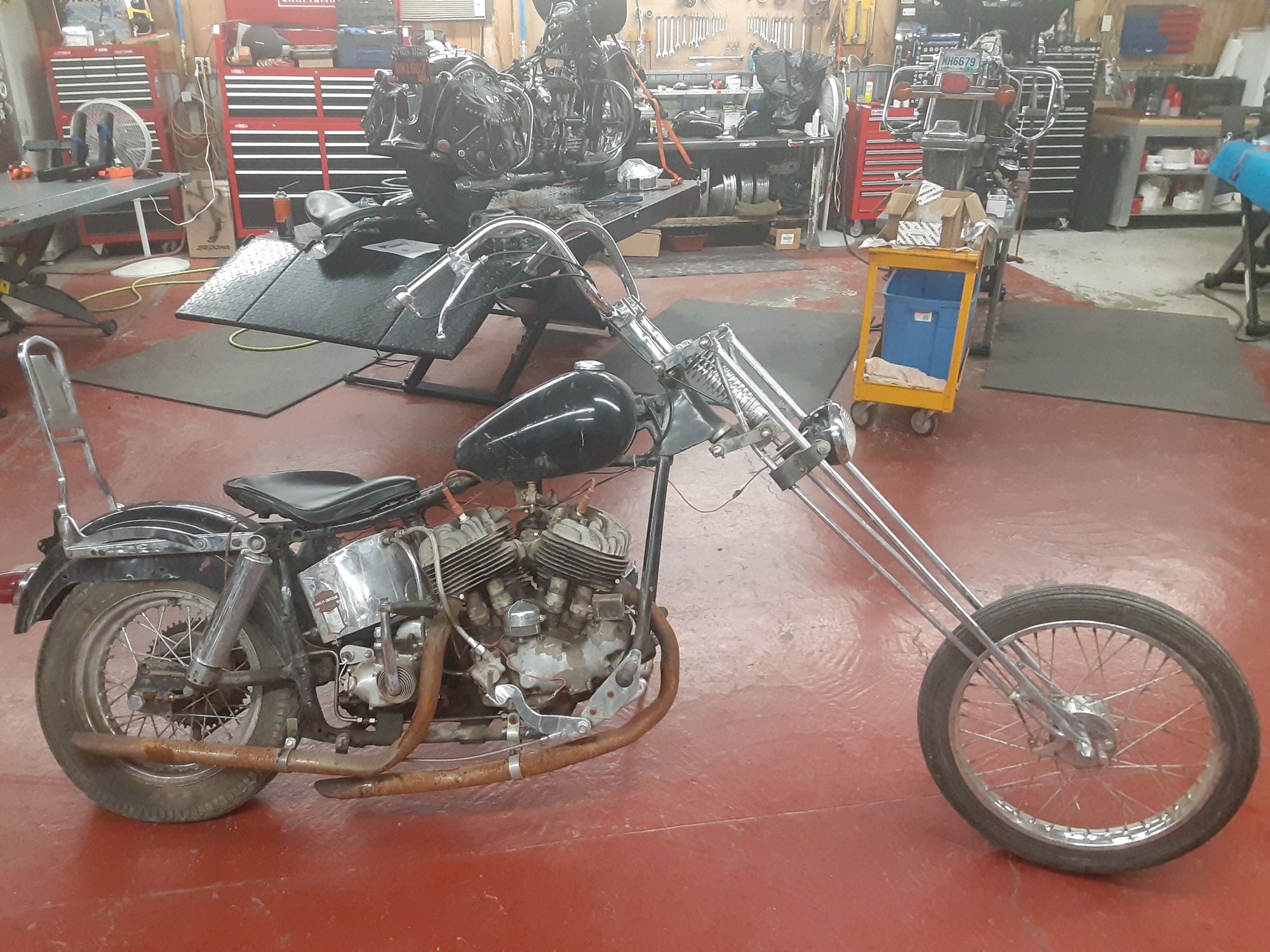

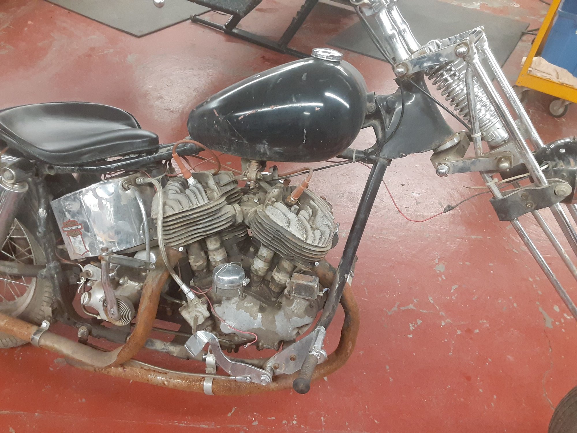

We have a project in the shop a customer brought in - '37 flattie in a newer chopped frame. I cleaned the carb, we oiled the cylinders, set the points and got it running after sitting for 20-30 years. Smoked heavily but seemed to run well considering it just woke up from a long nap. We don't have any info on anything that old and I'm trying to find what the pressure range should for a compression test. We were at 50 PSI both front and rear.
Can anyone steer us to an online reference for for Flatheads ? Added a couple pics.

Thanks for the advice and recommendations guys.That's the road we're heading down. Now that we had it running sounds like the owner will probably do the top end and put it in an aftermarket frame this spring.
