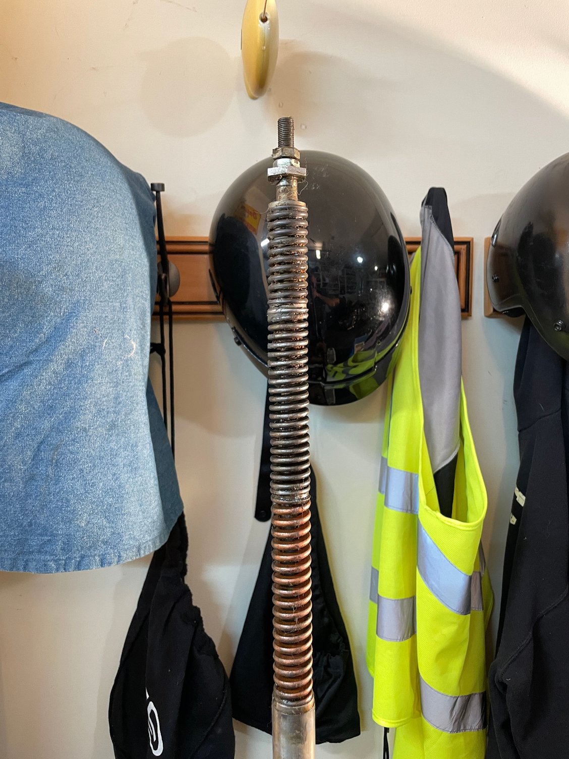

Update: The pogo stick springs hardly moves in a vise. It may have the fat boy springs in it. If I back off the pre-load, the thread post doesn't extend out the tube bottom.
I buggered up the threads in the steel plunger too. But I took a gamble to save $150 and ground off the first crappy threads and put it back together. Success there.
I put it all back in place, including the green buddy seat spring. I'm adding the rear buddy seat springs also. Just waiting on 45 Restoration to ship. (along with all my other stuff).

Are you running the springs as found in the Pogo or a new set from Colony? I bought the Colony set, installed per the instructions and my weight and never bottomed out again, nice comfortable ride.
If you still have whatever came in the pogo in there, post up pictures. Maybe you have lifter springs or something else some farmer stuck in here 50 years ago. Could be the cause of all the issues. What was inside mine did not look like the manual, good luck.

This was with the ‘42:

There's also more inside that tube on the pogo.
