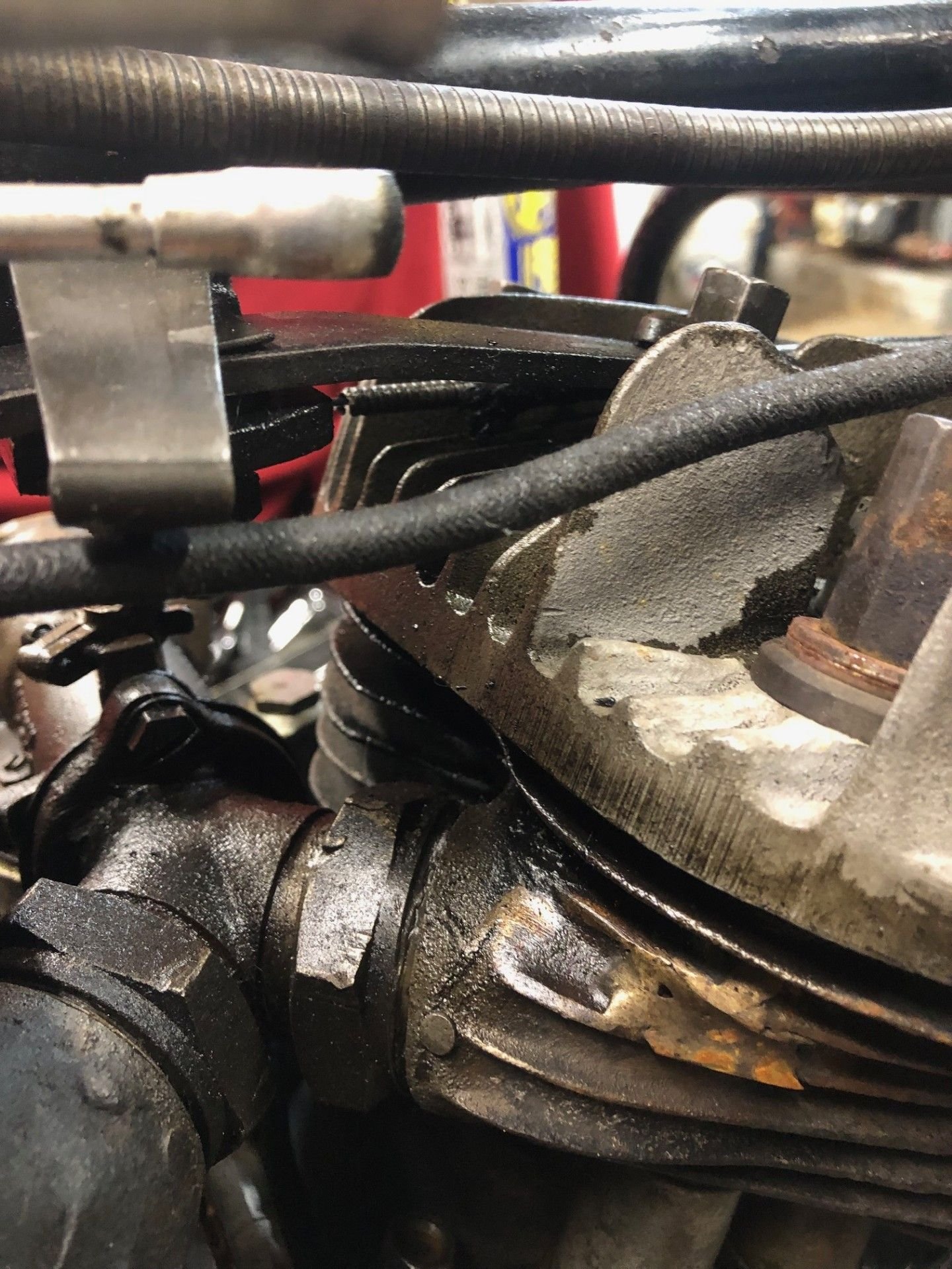

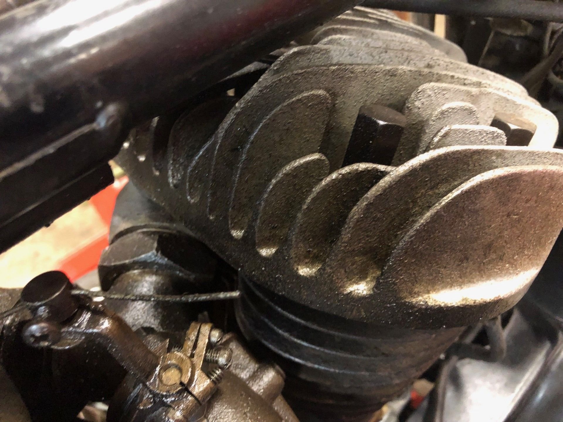

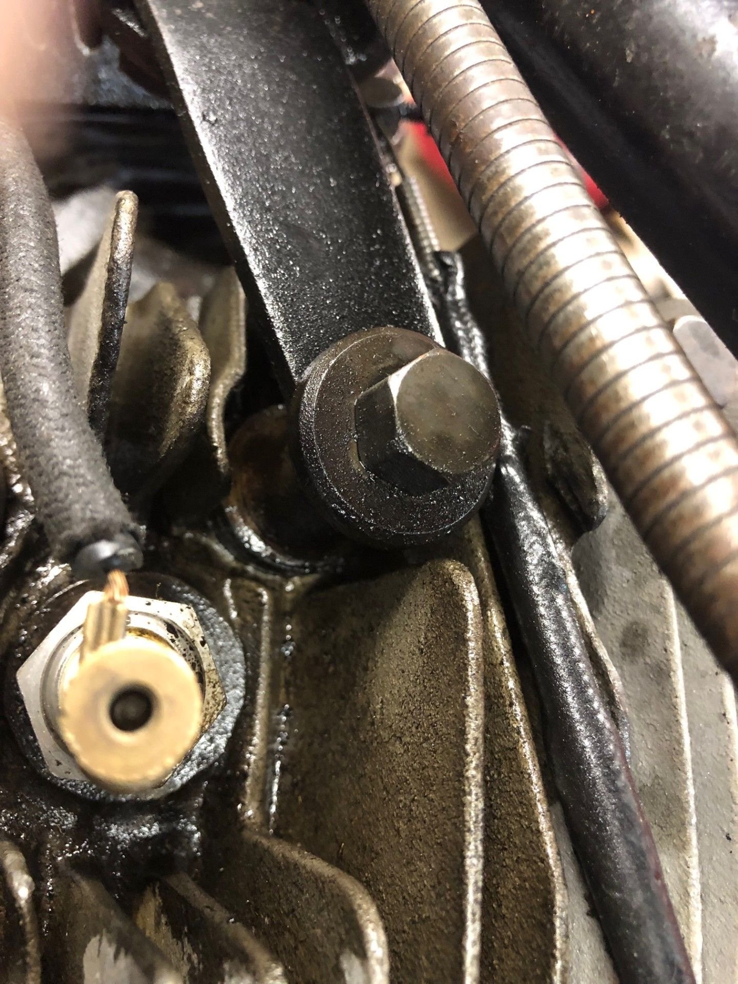

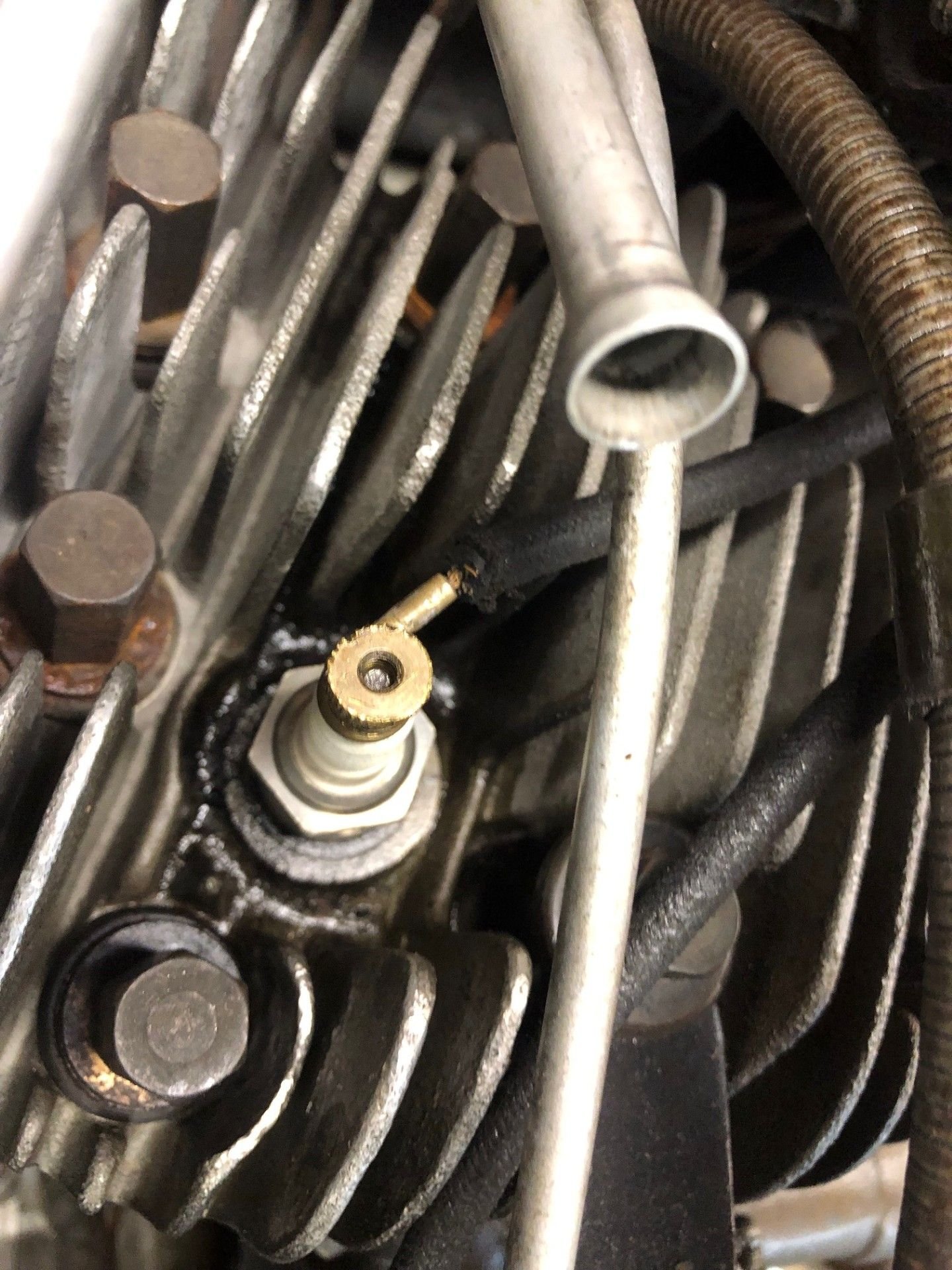

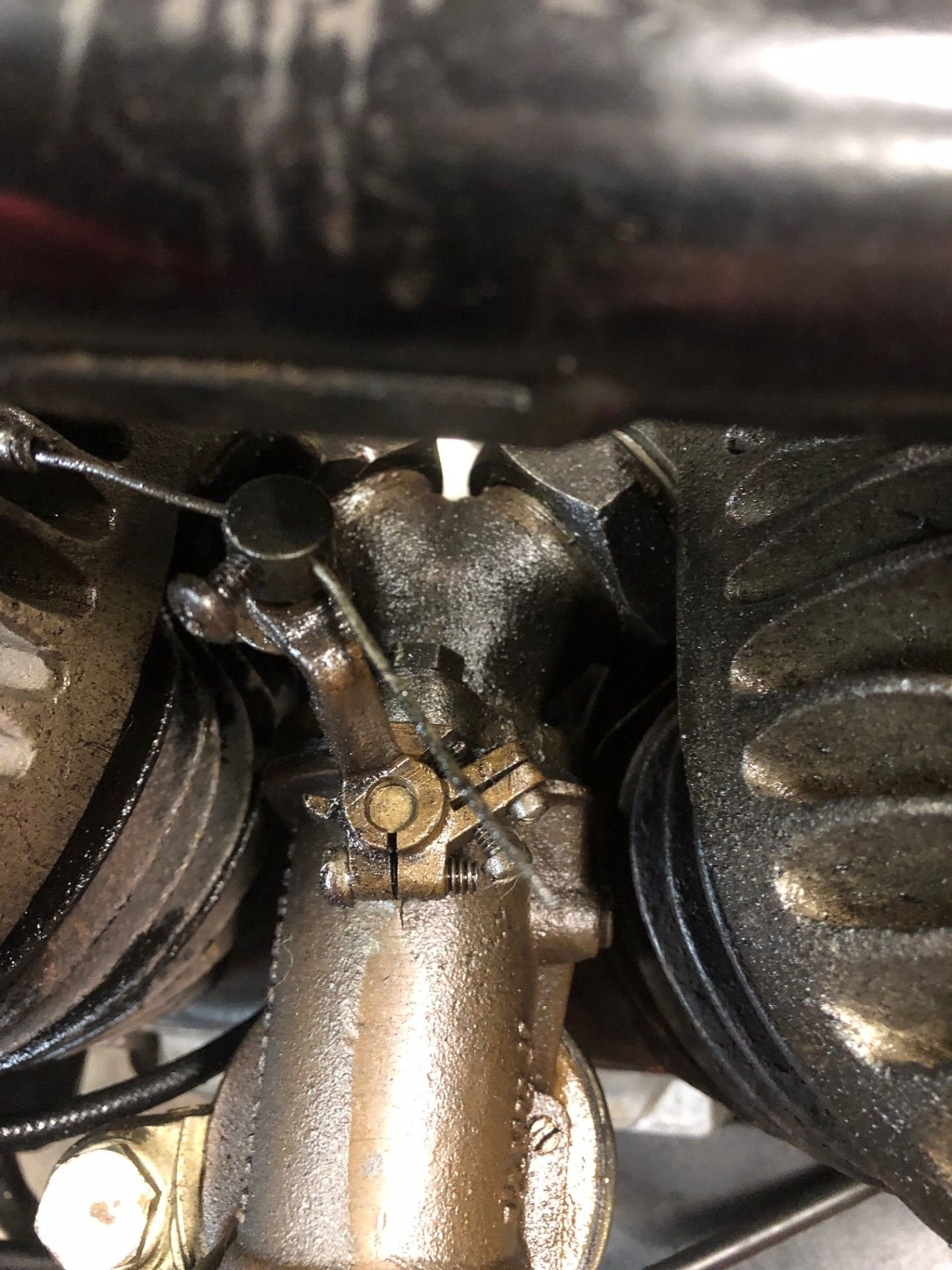

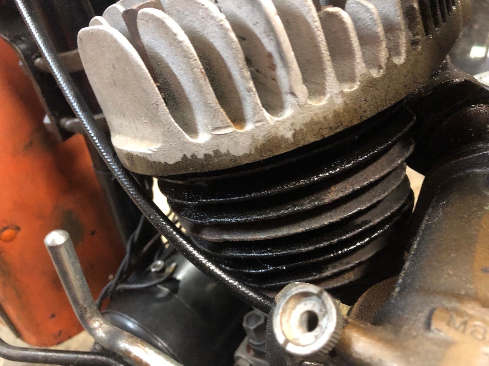

Good morning all. I am pondering my course of action, thought I would post some pictures and get some opinions or maybe solid advice.
Last Spring I had the motor rebuilt and brought her home. Full long block. I have been told to torque Flathead head bolts to 65 ft/lbs, so I checked all the bolts, they all took maybe an 1/8 of a turn, no worries. Put motor in frame and was setting up the motor mounts, the front top motor mount bolt "popped" back at me when I torqued her down. Well I removed the bolt, ran the thread cleaner down and with one less washer we were in business again. But it popped or snapped real loud when it happened. I assumed the bolt had not caught enough threads and just pulled out.
OK so now the bike is together and we are riding and it looks like I have a blown head gasket. Oil on the top of the cylinder and coming out through head bolt/top motor mount. Also coming out at the spark plugs, but that seems to be common enough for 80 year old motorcycles. My thought was to pull both heads and replace the head gaskets, I have a new set of copper in the basement. But I have questions:
1- Does the upper motor mount bolt lead down to an oil passage?
2- Or is the only way to get blow by from the bolt is via the cylinder and therefore the head gasket?
3- If down to an oil passage, should I put sealant on the bolt threads when installing? Sealant under the washers?
4- Any solutions for spark plugs leaking? Sealant? Anti seize?
5- Or did I crack the head or cylinder when tightening down the head bolt?
Front head, oil/fuel coming up around the spark plug
Front head. Oil looks to be coming up from this bolt.
Rear head, I think all of that is from the front head misting the rear.
Manifold is all wet
Front head, oil under the head and on the cylinder.
Front head, again oil under the head
Rear head, minor seepage from spark plug, that seems about normal

While i have used heli coils and the torque us then 55 pounds - but i spray the head gaskets with the hylomar just because both sides
thin wall time seat is really the deal as it stays a steel solid thread and you dont remove that much compared to a heli coil - my opinion is not as strong as a time sert but i dont know if they sell a kit in thin wall with that thread
once the thread popped you should have stopped and fixed it then - it was being held in place by the washer thickness only - in the thread depth

Any thoughts on the weeping at the spark plugs? I have copper crush washers for the Shovelhead, seems to help not sure if they would be the same size.

Front head is off, I will post pictures in the morning. As John said, looks like I messed up the threads on the head bolt/motor mount. Need to see what I can do with Time-sert VS heli coil.The special order tap I have for cleaning out the threads a couple of years ago is 7/16"-16. We will see where this takes us.
