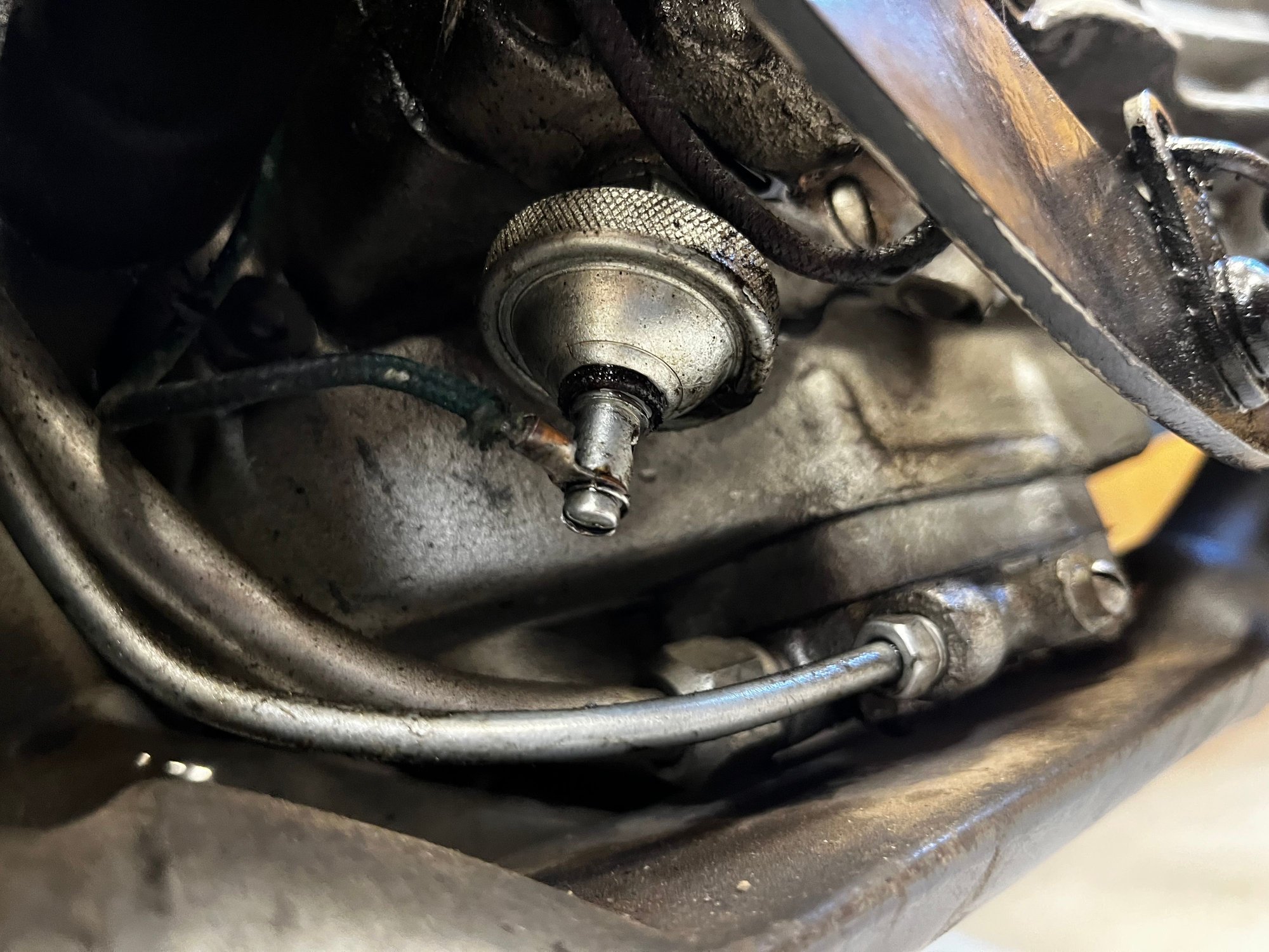

This is the current oil psi switch that “might “ be the issue. Does anyone know of a trouble free switch or how to cure this problem?

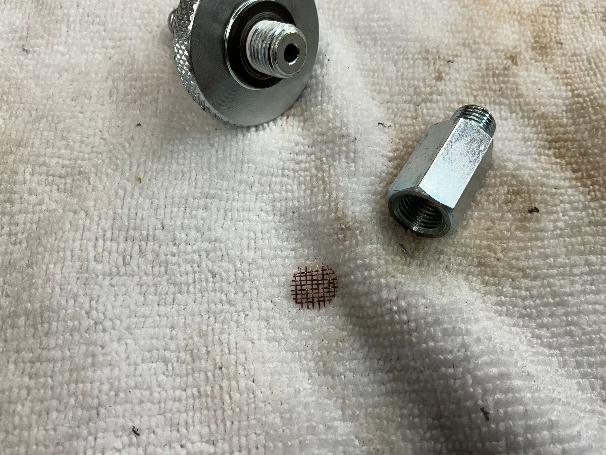

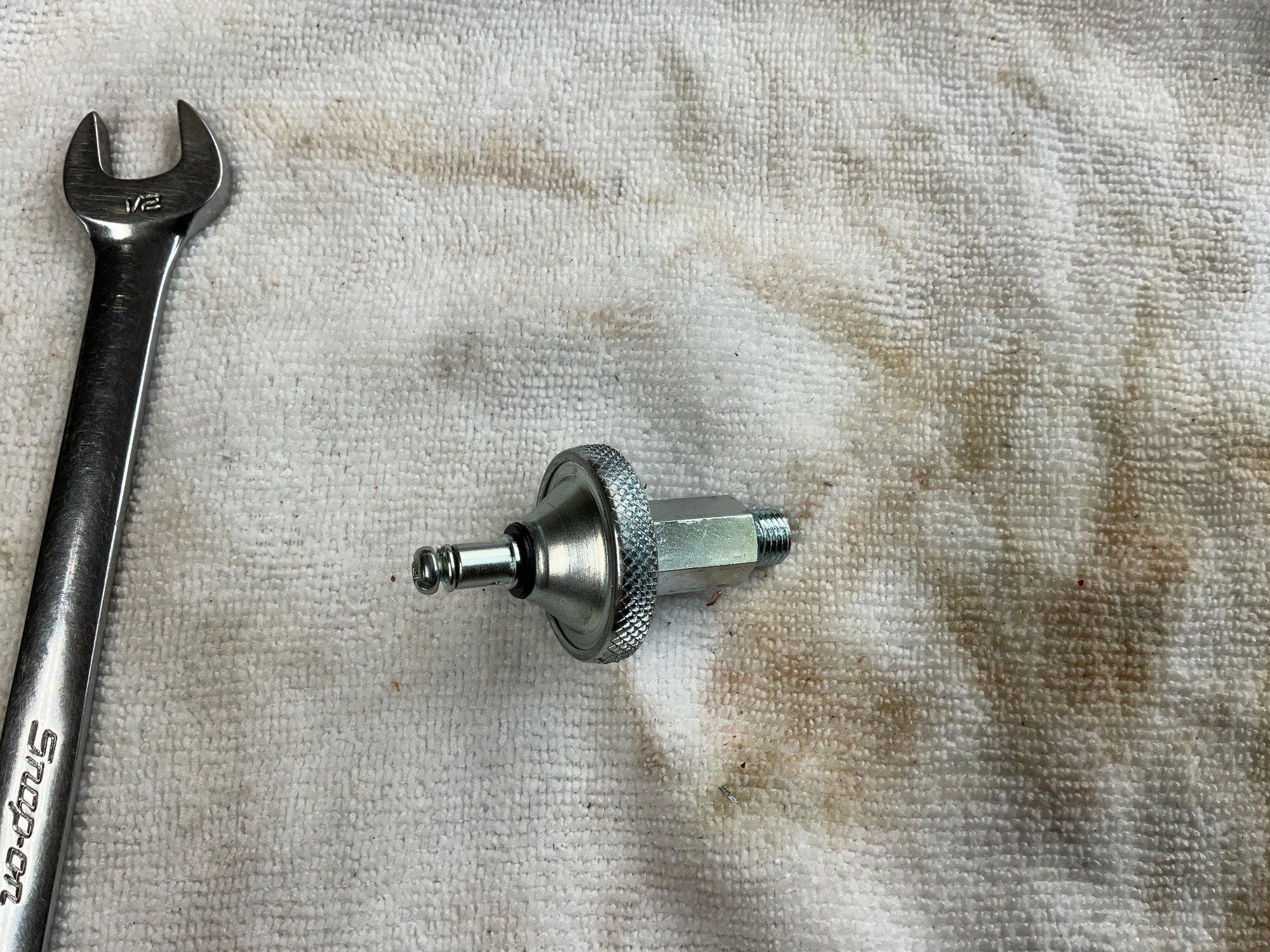

This one has a screen instead of the spring remove it try it then
