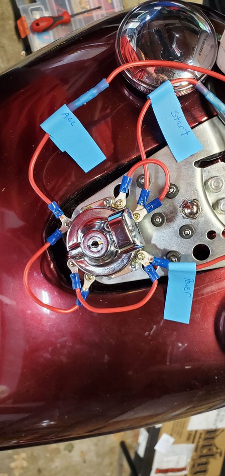

I've got this setup atm and I'm getting nothing. Can someone please help me out.

First all those wires aren't suppose to be red
Second there's a wire missing that's usually on that 6 post ignition.

again, from the underside you seem to be missing the "lights" wire going by your labeling.
