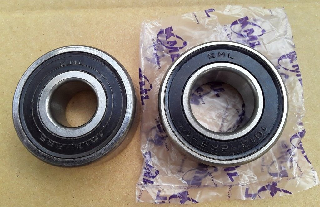

Just some additional identification Info
All ***** (KML):
3/4"ID x 21mm Wide (2 seals per side) << __ >> 1"ID x 21mm Wide (2 seals per side)
I had some New Old Stock
Disregard the groove on the seal of the 3/4" ... something rubbed on it
1" ID x 15mm Wide (old All ***** / KML Blue one) << ____ >> 1" ID x 15mm Wide (NEW All ***** / No Name)
I also have some NEW 25mm ID x 15mm Wide (which prompted my call to All *****) ... they are Identical Visually to NEW 1" x15mm above even with same 6205RS (only) on the seal. Which makes sense because they just resize the smaller ID 6205 for the 1"ID versions, but could mess someone up. They use a Sticker on the small bag to differentiate the Two Different sizes and of course they only fit properly one or the other
