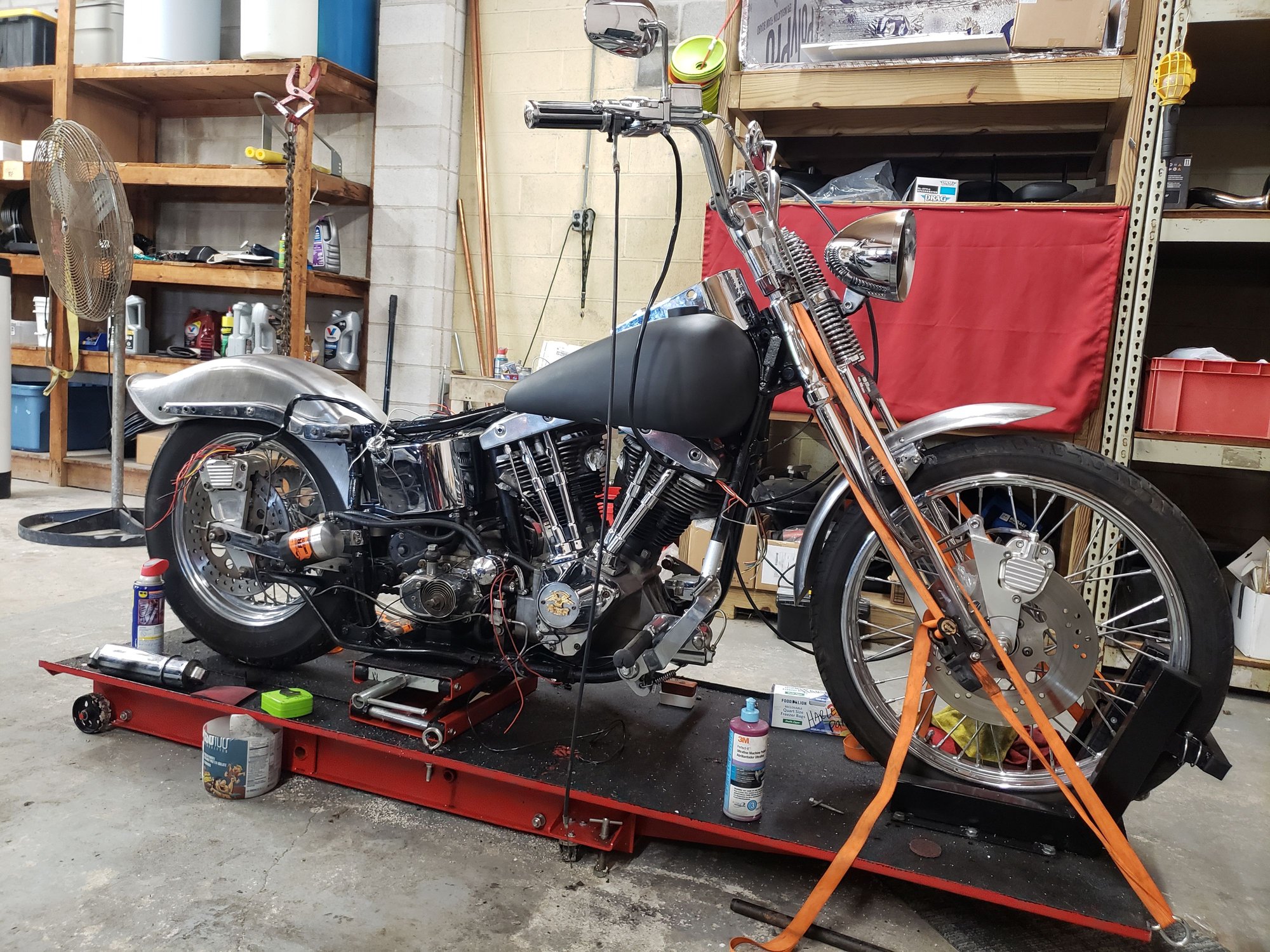

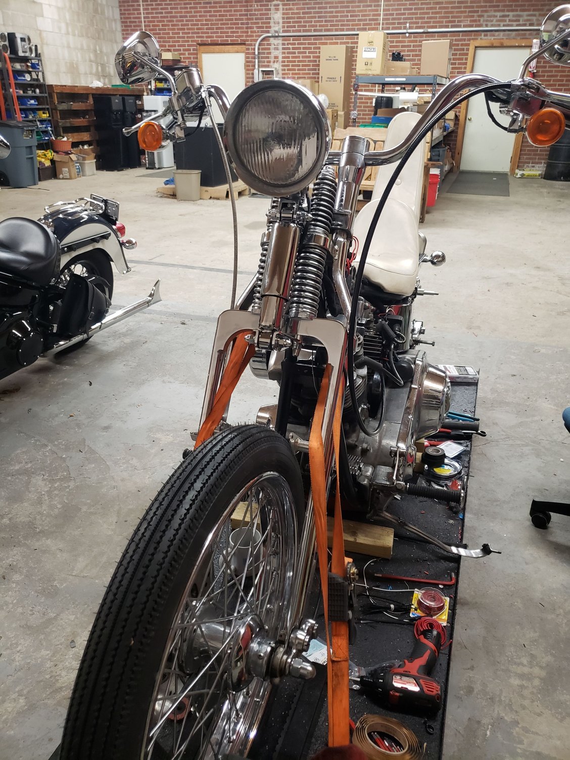

Picked up an old shovel that someone put a springer (unknown make) on. This bike has a bunch of problems that I am fixing and one seems to be the front wheel spacing. I'm not super educated on springers and thats why Im here. The spacing on the wheel looks off. The top of the legs measures wider than the point where the axle goes through. Are they tapered or did ol boy mess up the wheel spacing and pinch it? The wheel looks alittle closer to the right side in the fender. I realize that the spacing on the brake side can't be altered too much as to where the brake meets the rotor. Any advice on where to go with this or who to ask? Should I buy a spacer and axle kit? I've seen some out there.

. Are they tapered or did ol boy mess up the wheel spacing and pinch it ?.
Loosen the axle and watch the legs, do they "grow" outward?

Well for sure that is not a springer from the MoCo, neither modern or from way back when. So we are in full custom land, anything could be right or wrong.
I would assume that you are correct that the legs should be straight and that one or both spacers are too short, resulting in pinching the legs together. As eigheight stated, loosen the axel nut and see if they start to spread apart.
Custom spacers are out there, either pre cut or stock to cut to length. A bit a patience, accurate measuring and some time you should be able to sort it out so things are straight. Not only do you need to space the wheel to keep things straight, you are going to need to keep the rotor centered on the caliper. They may require shimming the caliper or the rotor, caliper is probably the best answer. Good thing it is winter, good luck.

Fella`s, check out that seat in the 1st pic !

What's the possibility of heading to the hardware store and buying a bunch of washers that fit the axle bolt, then "assemble" the necessary spacing using the appropriate number of washers?
Once you get everything centered properly, you could then measure the washer stacks and get the proper-sized spacers, no?
thats an old 80s mustang seat.
