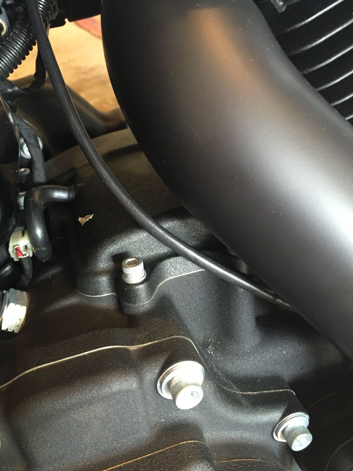

Is it ok if the rear o2 sensor wire brushes against the engine? I rerouted it as it was before, but I can't remember if it touched or not. I don't see how it could not touch unless I used cable ties. Is it ok if it touches? Pic attached:

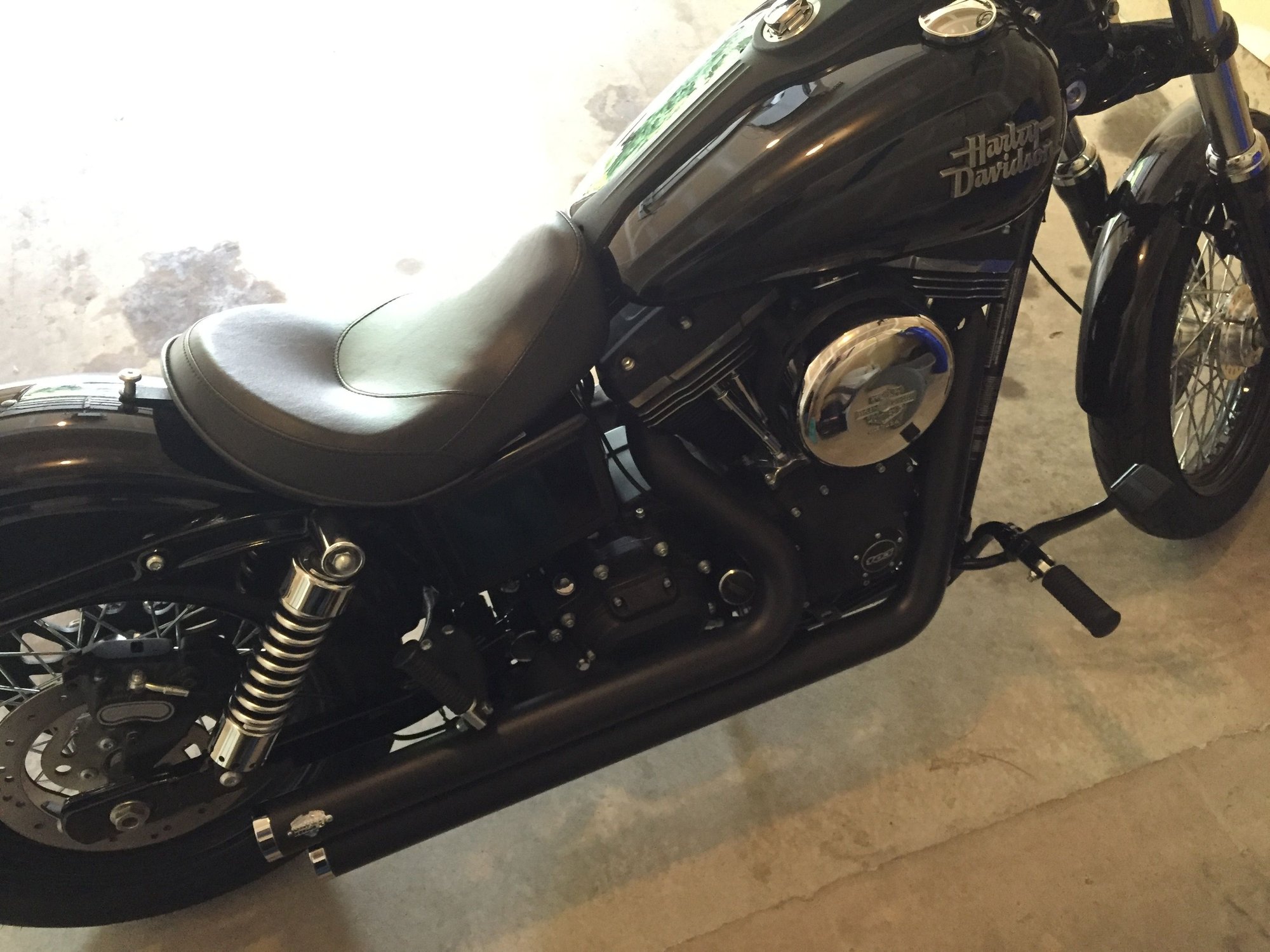

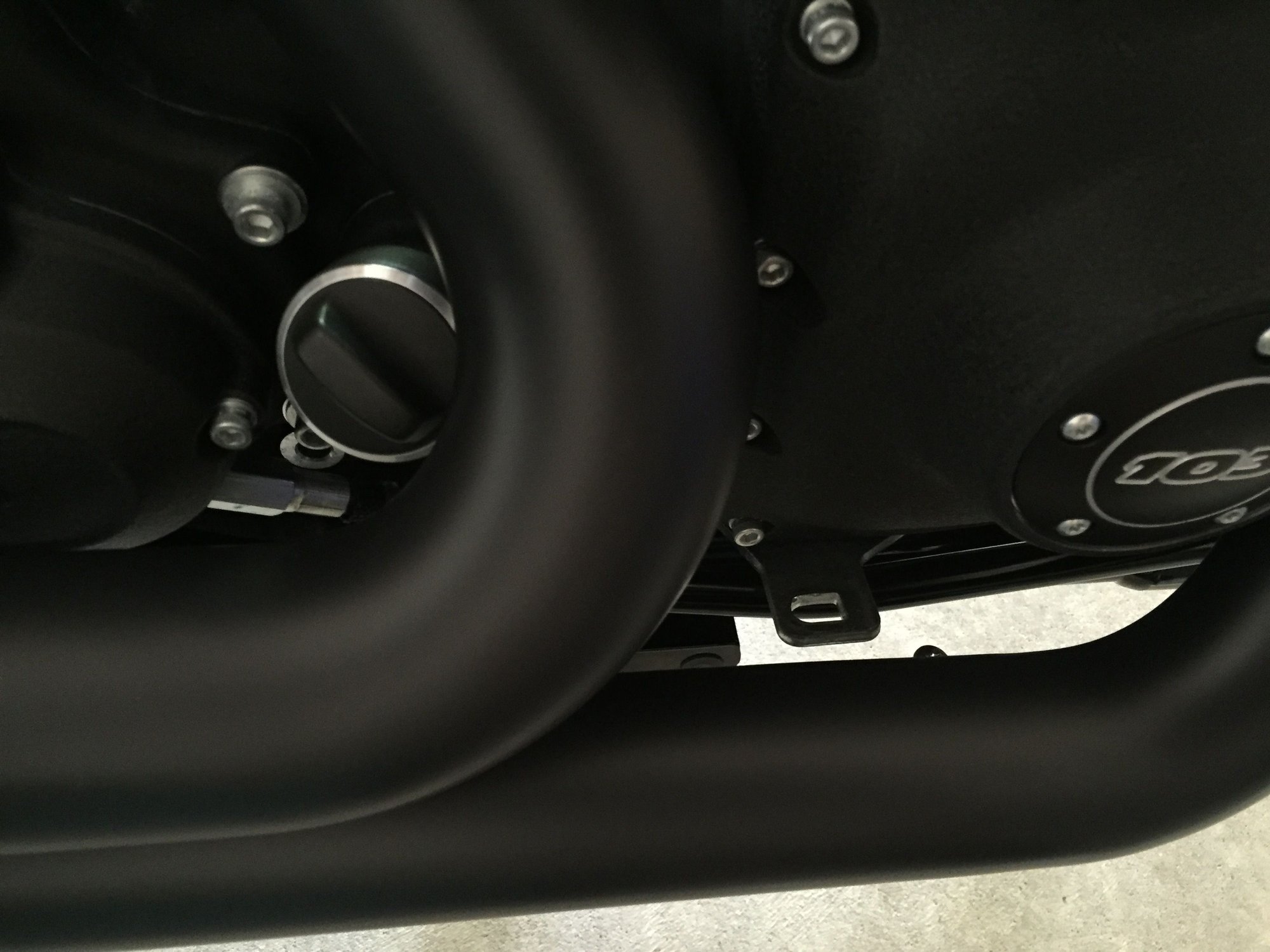

Installed finally. Damn these things are louder than I thought. Didnt get to ride her yet, though. I got a couple of last questions hoping someone could help me out on:
1) refer to above post about the o2 wire.
2) I held my hand around the headers / flange area to test for leaks. Is it easy to tell if there's a leak? I didn't feel any obvious air blowing on my hand. I felt heat radiating out of the rear cyclinder section but I'm not sure if that was just heat from the engine vibrating hot air in that tight space. Is it usually obvious?
3) can I run these without a tuner temporarily? I need to install the air cleaner before downloading a correct map on my fp3 which I was gonna do next weekend. They don't have a big shots with stock air filter map.
Thanks all for the continual help. I've attached a pic and you can also see the extra clamp bracket left on as was discussed before. No biggie if you ask me.

1) refer to above post about the o2 wire. You mean this?
Then use cable ties like everyone else, including HD.
Yes, it's obvious,, it makes a different sound that can be heard too.
3) Can I run these without a tuner temporarily? I need to install the air cleaner before downloading a correct map,
Yes, run it without fear, there will be little change to the Air/Fuel mixture until you change to the Stage 1 AC

Thanks Jon. The stock o2 wire wasn't cable tied. I just couldn't remember if it brushed against the engine or not. I can cable tie it though if it shouldn't touch anything.
