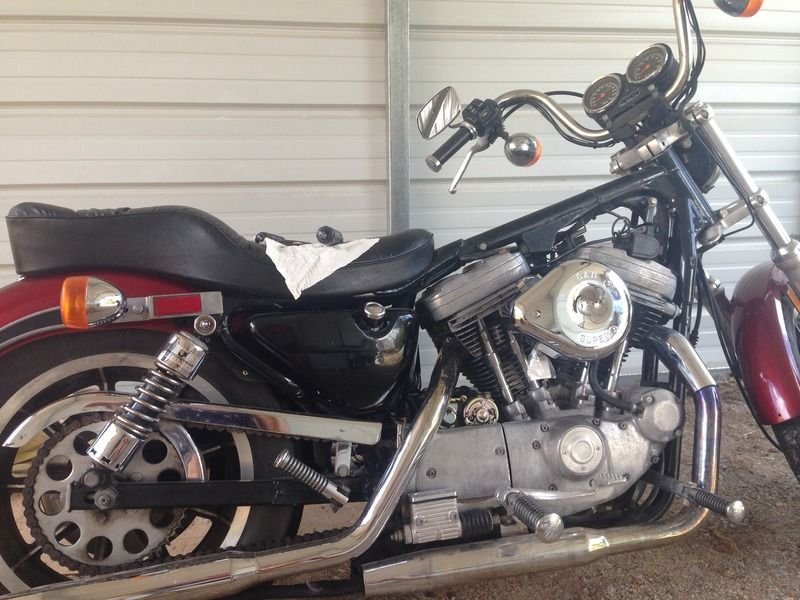

I'm in the process of swapping to a s&s super e.
Had a mikuni on it so i need different cables. (the ear / tab that holds the float was physically broken)
Want to make sure i order the right ones.
This is what i think i need.
http://www.jpcycles.com/product/520-460
http://www.jpcycles.com/product/520-466
Pictures of what i'm working with....
Thanks for the help.

He doesn't have stock cables-probably. He's taking off a Mikuni,so who knows.He could try the existing cables before ordering replacements though,but from his pic it looks like the s&s is already on the bike,so maybe he has checked the cables.

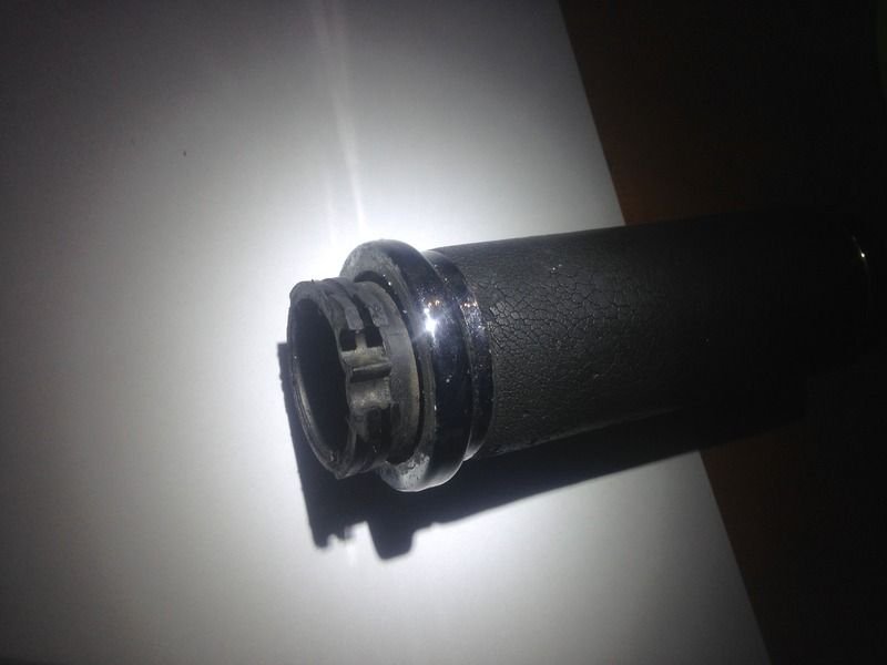

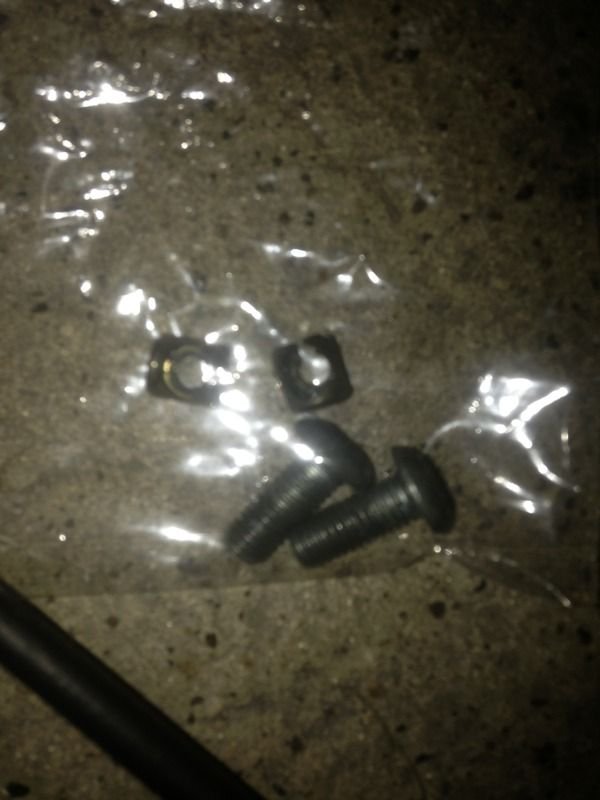

Correct "i think" from all the research i've done if i had stock style cables i'd be good.
The mikuni type cables i have are threaded and have nuts on the ends...
Pictures of what i have
Yes the s&s is on the bike now.
Ends that went to the mikuni that wont work.
ends that go into throttle
brass ferules that came off throttle ends
