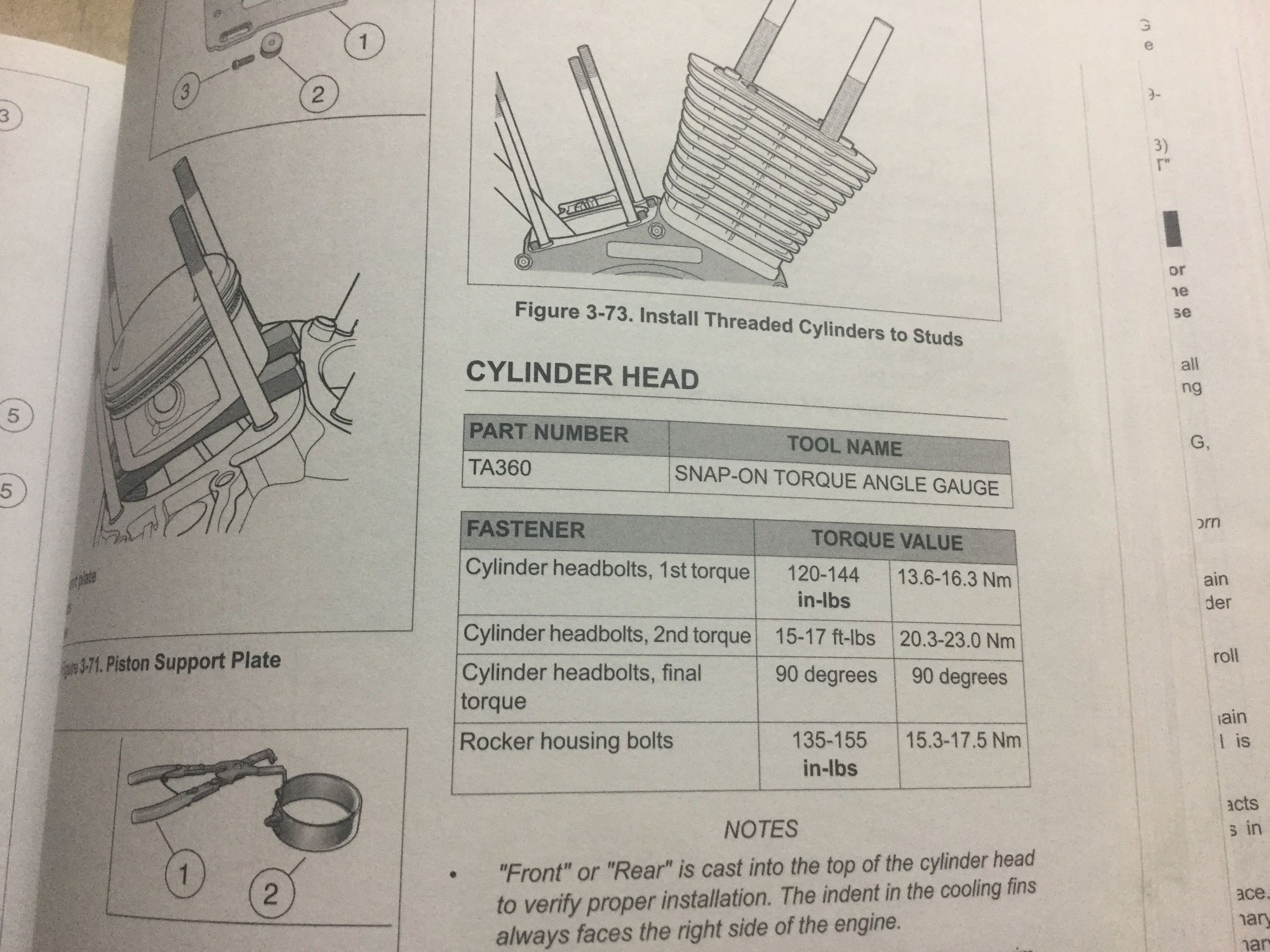

[QUOTE=sixguns;16119759]When it comes to Harley-Davidson, they provide a range of min and max. and as part of the maintenance program you check a fasteners torque with the torque wrench set to the Minimum range. They also use torque in stages but they clearly call out those as initial and final. No need to look any further than your service manual.[/QUOTE
From the manual:

Originally Posted by senna
Just for the record, I don't hold any animosity here. This is just a discussion, we agree on pretty much everything else.
I agree on using the step method on anything with more than one bolt. But I would go 30 ft lbs then final of 60 ft lbs. I would'nt go 50 ft lbs then 60 ft lbs.
The Service Manual spells out first torque, second torque and final tourque for cylinder heads and still gives a range. Best advice on torquing is get the manual and follow the instructions.
My example was on general bolt torque, not an application Like a cyl head that has a specific sequence spelled out.
