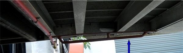

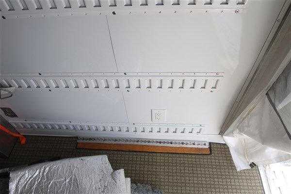

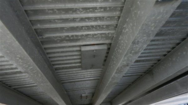

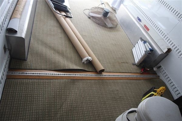

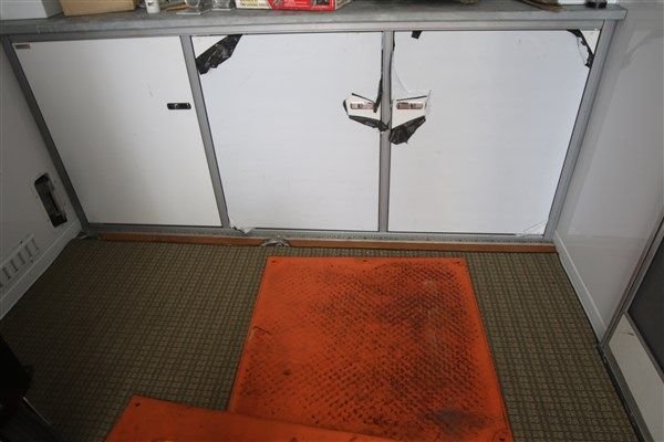

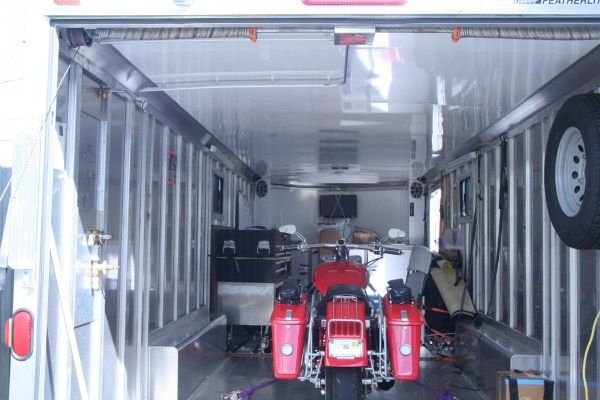

I made 2 per chalk mounting plates (10"x18"x1/2" with (4) 1/2"X13 chalk mounting holes in them. I mounted them using 4 additional 1/4"x20 under the Featherlite aluminum planked floor. I drilled the 4 chalk mounting clearance thru holes corresponding to the aluminum mounting plate than, when needed, install those cheap $35 HF wheel chalks which just work. I use my rechargeable screw gun with socket adapter, extension & Alan socket key to R&R the chalks. I always keep button head SS 1/2"x13 in the unused holes to keep the dirt out as well as esthetics. Button head do not catch. Takes a small amount of time. I ride right up and in and this chalk holds the bike-right and attach the mounting straps. i use 4 F, & 4 rear to keep the rear wheel from moving side to side (2) or up (2). I use I track (side to side) as well as on the side and (3 rows) of e-Track on the walls. The e-Track on the walls really strengthen the structure but add weight. I have found this method works for me and offers the best for the two worlds. I roll out a commercial grade carpeting and used a coating for waterproof the backing as well as made it non-slip. There are a total of 3 mounting possibilities on the rear section & 2 mounting possibilities on the front section. This way if there is a broken down biker on the side of the road I have the room to haul him/her to where they have to go. I have breathed in way too many bugs on the side of the road not to know better on giving help.
Over View
T to R I track for the rear wheel tie down for a better angle.
Front row I-Trac to secure the front of the bikes.
Surface mount I-Trac with oak ramps on each side of the I-Trac.
Mounting plate under the floor of the trailer.
