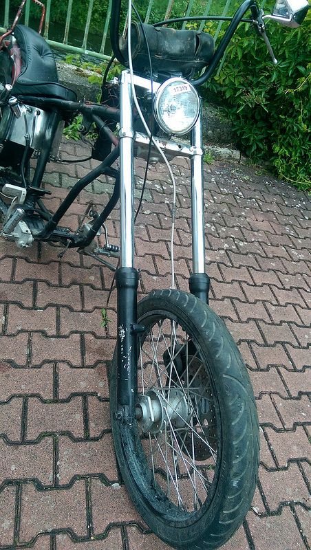

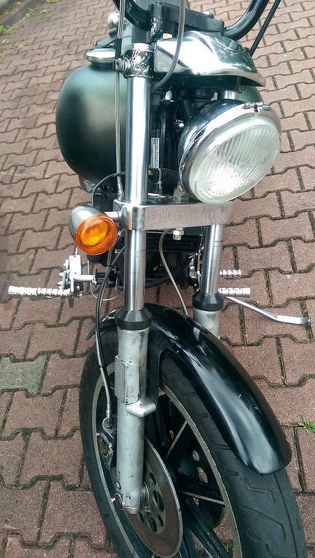

Can i swap the triple tree off this 1980 FXE frame
with the front end off this chopper frame? (frame has no numbers anywhere, so I dont know what it is, but it had a Shovelhead in it!!!)
CAN I DO A DIRECT SWAP? TRIPLE TREE, FORKS, TIRE, AND ALL!!!
CAN IT BE THIS SIMPLE?
And how do i get Fork Stem out of the neck and the lower bracket off? Removed the Fork Stem Nut and used a mallet on both but they aint budging!!!

The issue will likely be the rake of the neck. The chopper is likely designed with the neck of the bike at a different angle than the stock bike.

Likes: 544
From: Canton Ohio
Some raked trees with some serous rake might do it. Hard to say how much from just a pic. I wouldnt use that front though even with raked trees. To long.

The neck & bearing cups are the same it will swap but unless the frames raked or you put shorter tubes on the wideglide that long *** frontend on a stock frame will sit you way to high at the neck, kickstand will be 6 inches off the ground. That wideglide looks to be about 8" over on the tube lengths and the frames either an old wishbone ( worth some money ) or an aftermarket clone, nether had numbers.
Edit ; you have to remove the top part of the tree with the handle bars on it and the rest will drop out of the frame bearings and all. Pull the wheel before you try or have a buddy help lift the frame off it.
