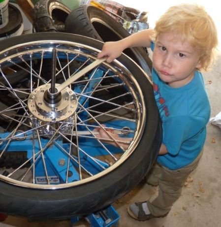

That's a pricey one! I got a used Cycle Hill (NoMar budget brand) several years ago, no regrets, figure I've already saved a lot of money over what it would cost taking a bike to the dealer. Even if I took the wheels off first, I think I'm around the break even point or better. Biggest reason though was feeling confident tires and tubes are done right. A bonus I didn't expect was finding a big crack on the inside of my 1200's front rim. Was covered by a light layer of rust, and I doubt a dealer mechanic would have bothered cleaning that off. Might have lasted years... or minutes.
I'm old enough to have some joint pain, and the tire irons were getting to be a strain on the wrists. Not a problem with the changer, does it all pretty easy.
Back-n-Black, if you don't already have a good bearing puller/installer, I'd highly recommend that, good tool to go with a tire changer. Easier to use when the wheel is gripped on the changer, too, if you have enough room on that one to reach under (mine's open). I have a Pit Posse, and almost identical brands of lesser and higher prices are out there, good design.
With careful supervision, the little guys can help, too.
