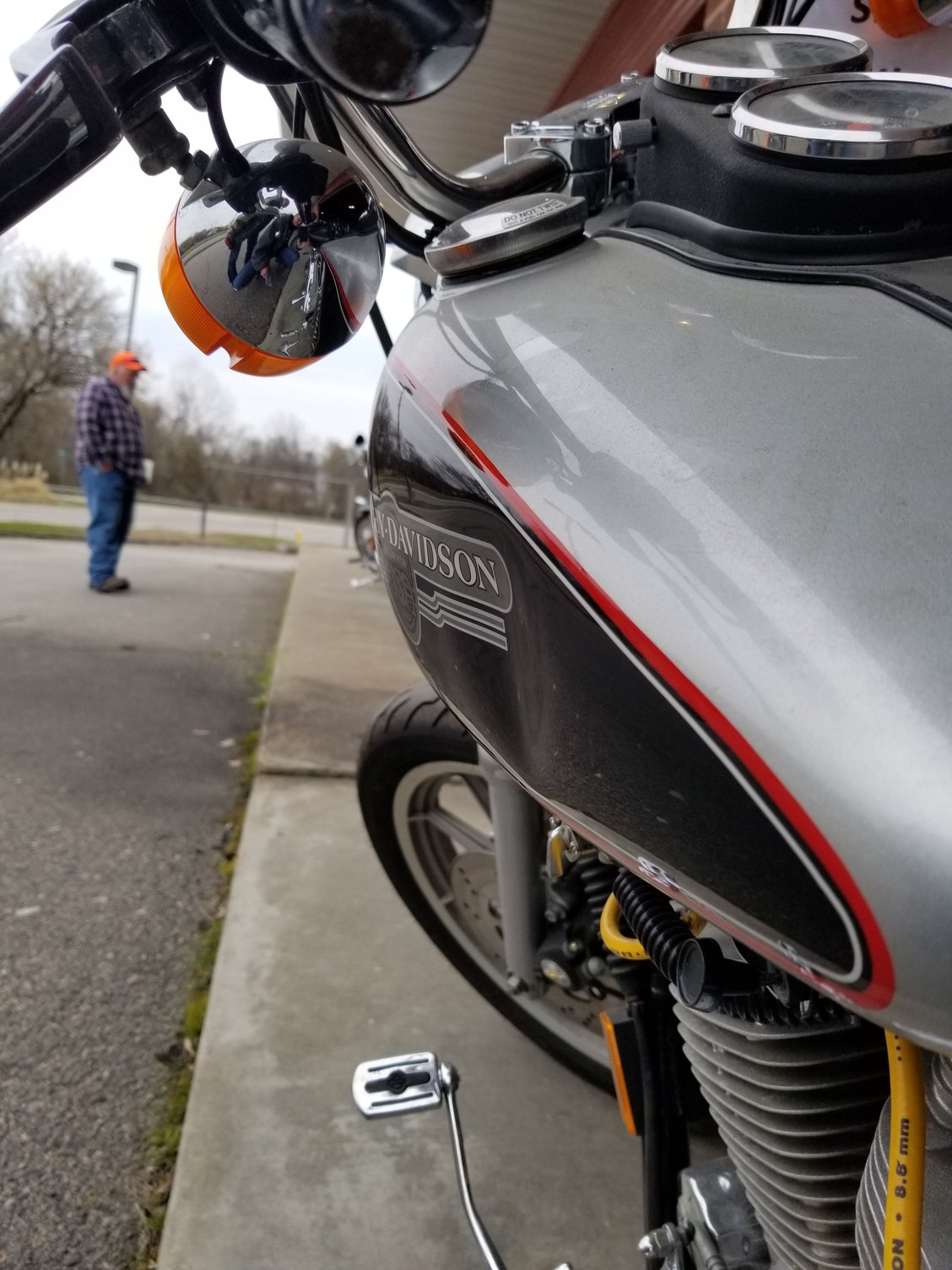

Just bought this for real cheap, how much do you think it will set me back to have this dent repaired?

What dent? Is it on the tank or fenders? Tank just pour all the gas out drop a match in, and RUN! If it doesnt explode it will pop the dent out... it may explode though so be careful.

It's on the gas tank, would prefer no demolition

Or maybe put a air valve into a old gas cap , and use a air compressor to pressurize the tank and pop it out with air . Might be a little safer. And this can be done with out taking the tank off the bike .

I’ve never used one but you can buy dent pulling kits for about $60 or so. (Some cheaper than that even).

Mine had a few tank dents when i bought my dyna. Ended up repainting it with a buddy and we bondoed what we had to. If worse case is you cant save the paint find a cool color with metal flake and go nuts. Just no green... any other color.

Might try a "paintless dent repair" expert.

But, give this a try first. I bought this to remove a dent in my fender, but haven’t tried it yet. Whatta ya got to lose by trying this? There are utube videoes on how to do this.
Gliston Bridge Dent Puller Kit,Auto Body Dent Removal Tools Pops a Dent & Ding PDR Tools with 24pcs Different Size PDR Glue Tabs

If there's a body shop close by, they should know how to get the dent out without destroying the paint (if possible) and will probably do it cheaper than you can buy the stuff to do it yourself.

Isn't there a way to freeze the dent out?
