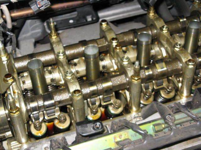

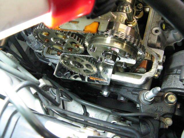

I truly would not worry about it. Once a year is fine. If you only put a few hundred on it, don't worry about it. These cold-blooded engines are hot as a firecracker in 10 miles. Oil stained hurts nothing.
Change all three holes when you change. The primary and transmission have no filter and are full of metal. So, draining may get some out if you run it first before drain.
Years ago, 3K was recommended. A year and 10-15K hurts nothing now with synthetic. I checked the valves a while back in RIP's car we gave to grandaughter that had a little over 100K. Purchased new and change once a year. Averaged about 10-14K a year.. Looked like new under the cover. Cam timing was dead on and it's a link chain. Solid lifter valve clearance was off about .001 tight but still intolerance. Does have a mile of tensioner and guides.
Realize this is a car but it had many short trips on it.
If it was mine, I would change it in 5K if it took 5 years to get there. You will never wear it out.
