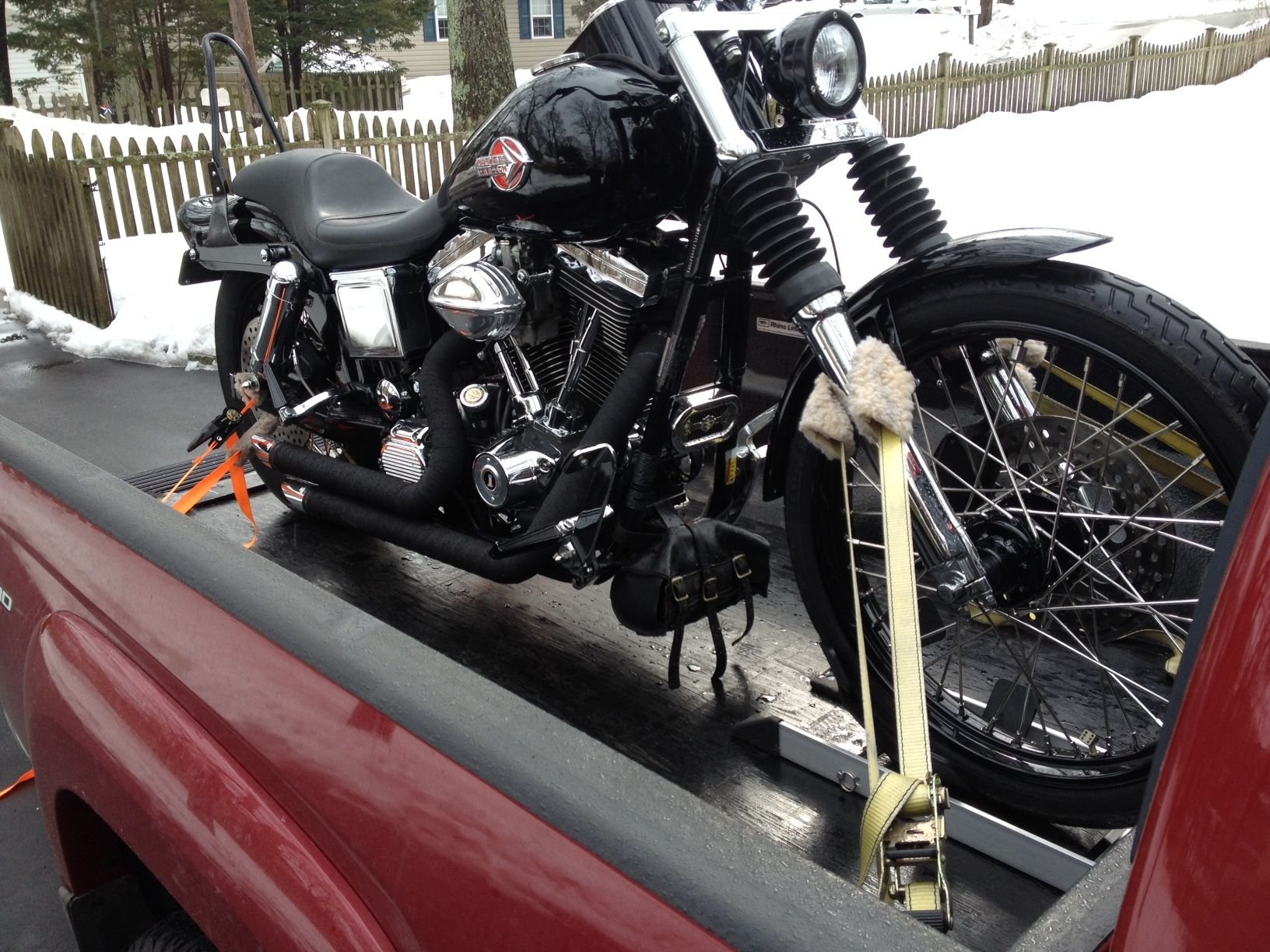

Put the front straps around the lower legs, above the fender mounts lugs as shown:
This works on 99% of the bikes out there. Rear straps, depends on the bike. But you want a location that is the frame or soemthing real close to the frame. You can see in this pick with a Dyna I went around the swing arm. I also use a Condor mounted in the truck, makes it a one man job. This way the front suspension is NOT compressed and free to do it's thing when you go over bumps. Good luck.
What is that WHITE stuff in the background I wonder!??!?!?!?!?
