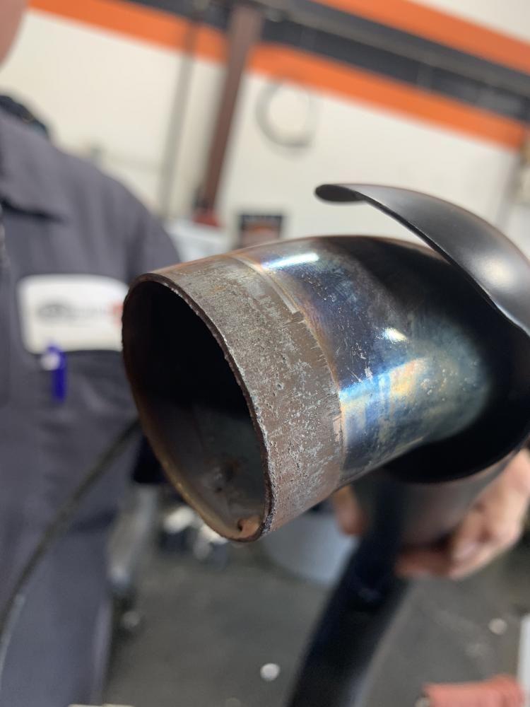

I just got back from a month-long training exercise in Bridgeport, CA (temperatures dropped to below 20-degrees through the night and it’s only October!!!). Anyway, I get back to the beautifully warm desert of Twentynine Palms to find my replacement header had been delivevered while I was gone.
I install the replacement and head out the next morning to Loma Linda, CA and the Quaid Harley Davidson shop (909) 796-8399 (just in case this story sounds too hard to believe to some readers). I get there on a Tuesday morning and there’s no wait - Bike goes in within the hour! “Steve” (older tech with 30+ years experience) takes on the inspection.
Now, it's my intent to do the services on this bike myself but with the recent experiences of misfortune, I thought it would be best to get an experienced set of eyes to give the girl a good “once-over”...The tech immediately notices an exhaust leak in the front cylinder - Apparently I don’t have the ear for what that sounds like. Bike goes up on the jack, front header is taken off and...See picture below because they’ll speak more than 1,000 words, right?

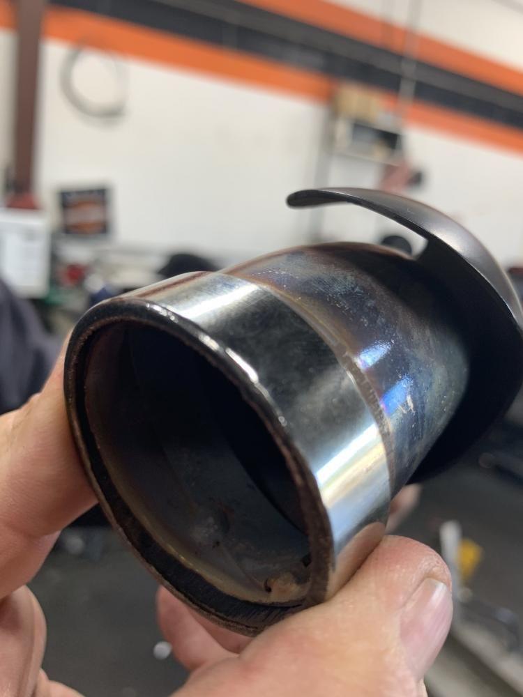

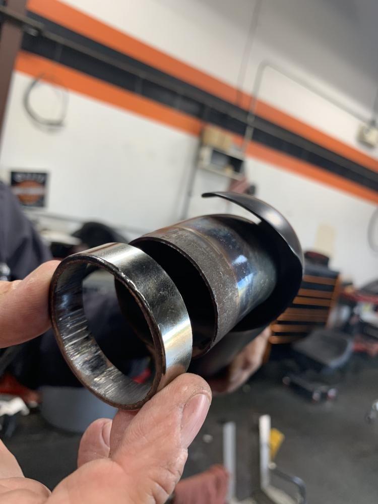

Basically, the collar or lip that was welded on the start of the pipe coming from the head lost it’s weld and slipped-off. That was causing the exhaust leak from the front cylinder. That header pipe was the first replacement that was sent to me back in May after the original shattered the exact same way as the recent one did at the o2 sensor.
