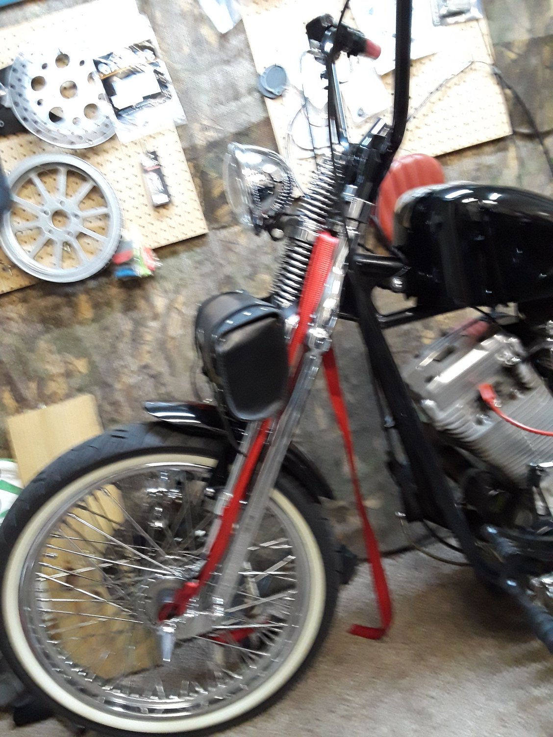

Ratchet strap. Axle, over the top of the tree, behind the upper springs, to axle on other side. Ratchet up, it will put the tension on the lower springs and relieve the tension on the upper. You can remove the keeper nuts with your fingers.

Surprised the ties held, few times I fooled with springers I compressed them much as I could on the bike and bailing wired the blue jesus out of them.
Now that's some slick stuff there, gotta love it.
