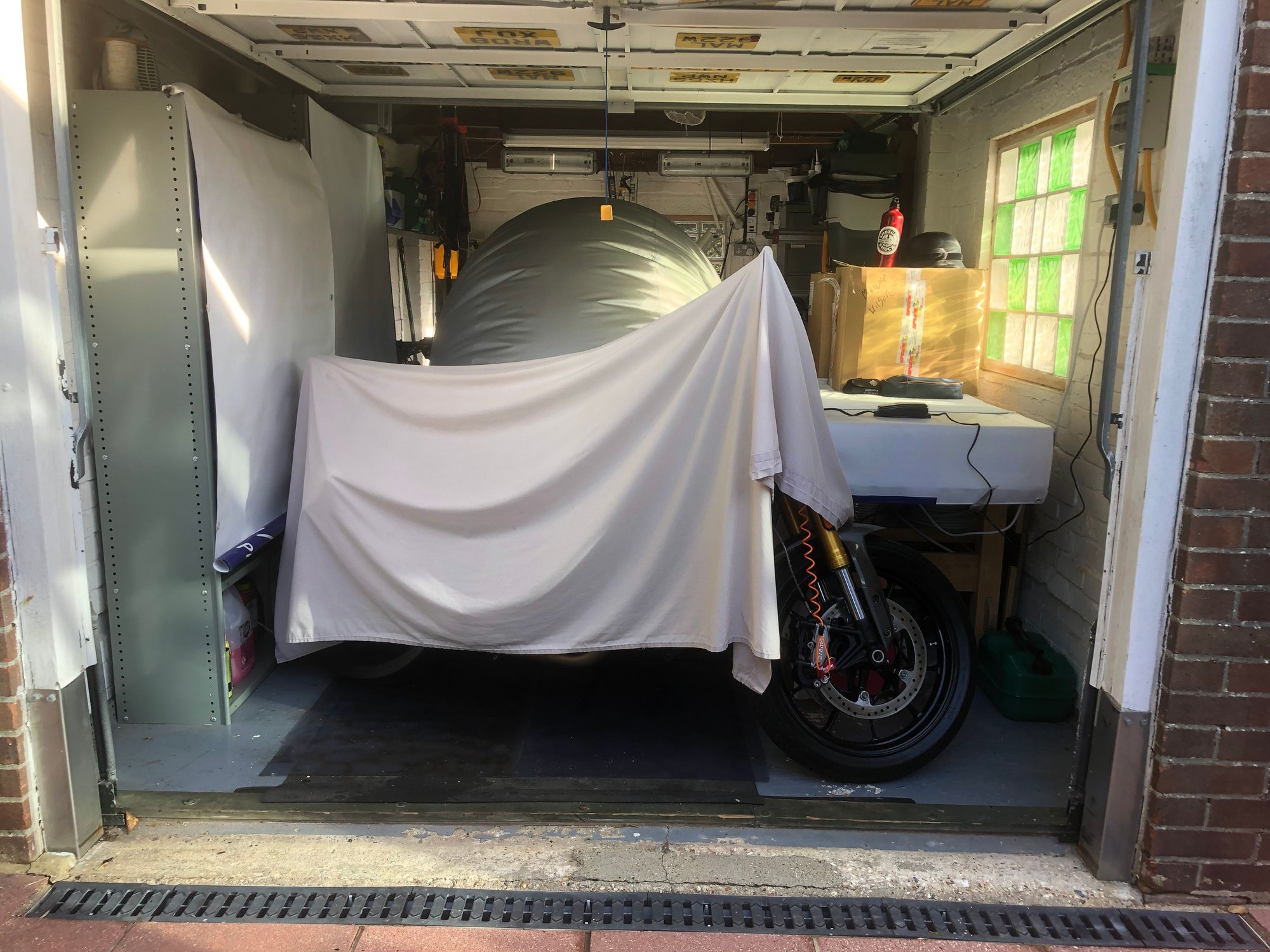

Are we talking detailing or simple less labour intensive protection in storage here? ACF 50 and a light cotton sheet. For longer term storage the Harley goes in a bike bubble depicted behind the Indian. You can put the bike away in the bubble wet, open the front and rear vents and it'll dry in about 30 minutes. Despite being in a garage I bought an outdoor one as it is double skinned and more harder wearing with UV resistant woven material. The previous one I had was an indoor clear PVC type but the PVC degrades over time in extremes of temperature, brittle in the cold and soft and supple in the heat, it still lasted me over 10 years in constant use before eventually cracking/splitting.
