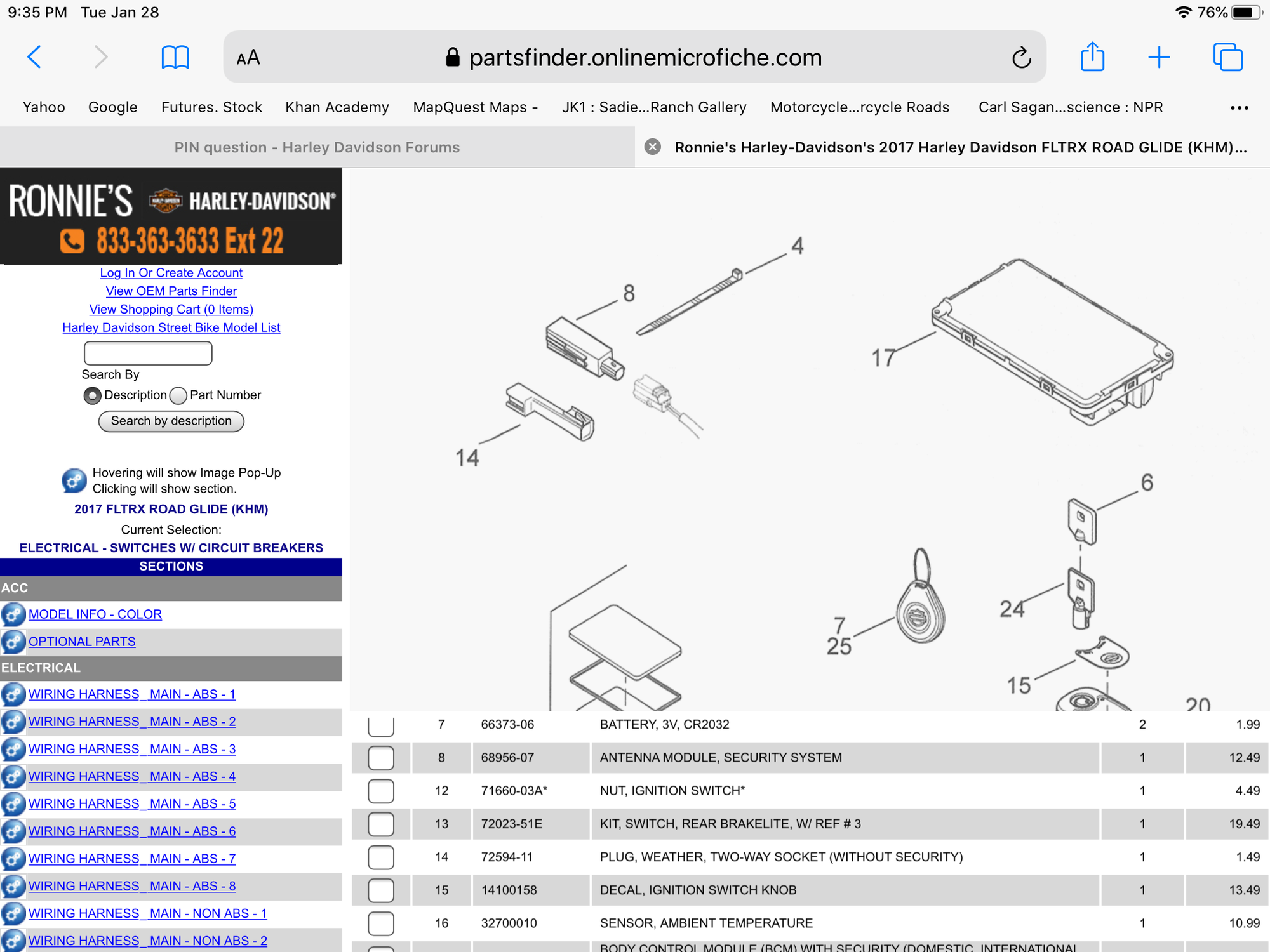

I have a question...i seem to have enabled some feature that makes me input my PIN every time I try to start my 2017 Road Glide...any idea how I turn this off?
Any chance the Security Antenna is unplugged? Our’s are under the seat.
