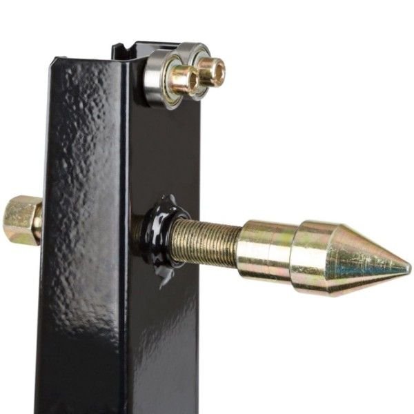

Very nice set-up ... I like the truing stand :>
Larry, that looks like a Balancer only
All you need is a dial gauge to make it a truing stand. It works quite well.
Maybe, but Truing Stands are made differently. They have another "Arbor", "Spindle"?

I have the No Mar Classic with the pedestal mount and the hitch receiver mount so I can go mobile if needed. However, I came across a great deal on this Ideal changer and jumped on it. I mostly use Dyna beads and Ride-On to balance tires, but I also have the No Mar balancer that I've used with a $25 Amazon dial gauge to true re-laced wheels.
I change a lot of tires and three things will never change no matter what system or machine you use.
1. Tubes are a pain in the a$$.
2. Dunlops suck. Very hard sidewall.
3. You'll always break a sweat.
Well ... I didn't want to "split hairs" .... I have a magnetic base for my dial indicator and it's very handy ... It's all good guys :>)
Not sure. The Field Service Manual shows a similar stand with a reference piece that will show you up/down and side-to-side wobble. The cheap gauge I use sticks magnetically to the base of the stand and can adjust and actually measure the wobble. The FSM tells you the limit. In my experience, as you approach the limit, you'll reach a point I call "good enough". It's the point at which any adjustment made after that only makes it worse. If you've ever trued a wheel, you'll know what I'm talking about.
