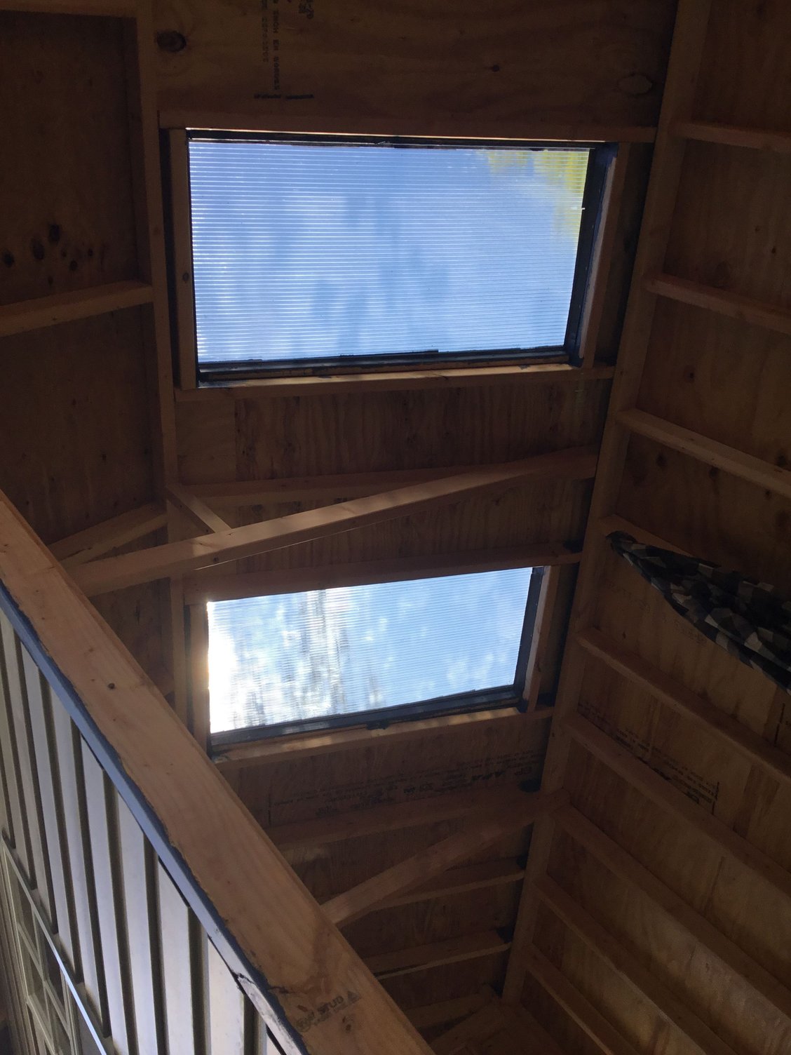

If you want light but ,not from the side do this .

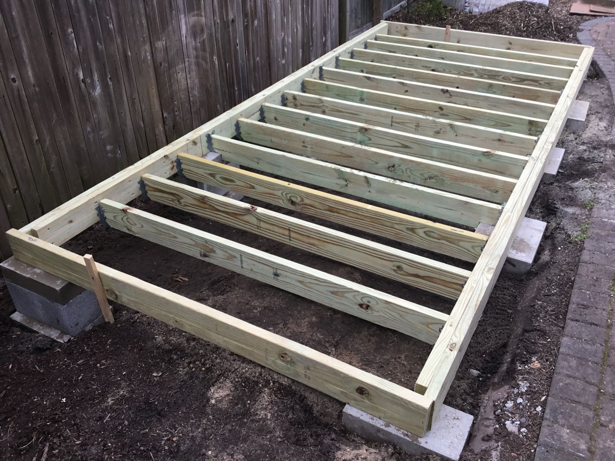

Originally Posted by Iron lHorse
Remember you need a Strong floor
Those living in very cold climes (Manitoba) should note how u supported the floor on those cement pads.
The frost level up here is more than 3 feet and frost heave can be a problem - pouring cement pads below than and then using that as a footing saves money.
Great idea - save concrete and by extension - $$!

In northern IL, I had to put 4' footings and a pad just for my 12X12 yard barn. We got building codes.
