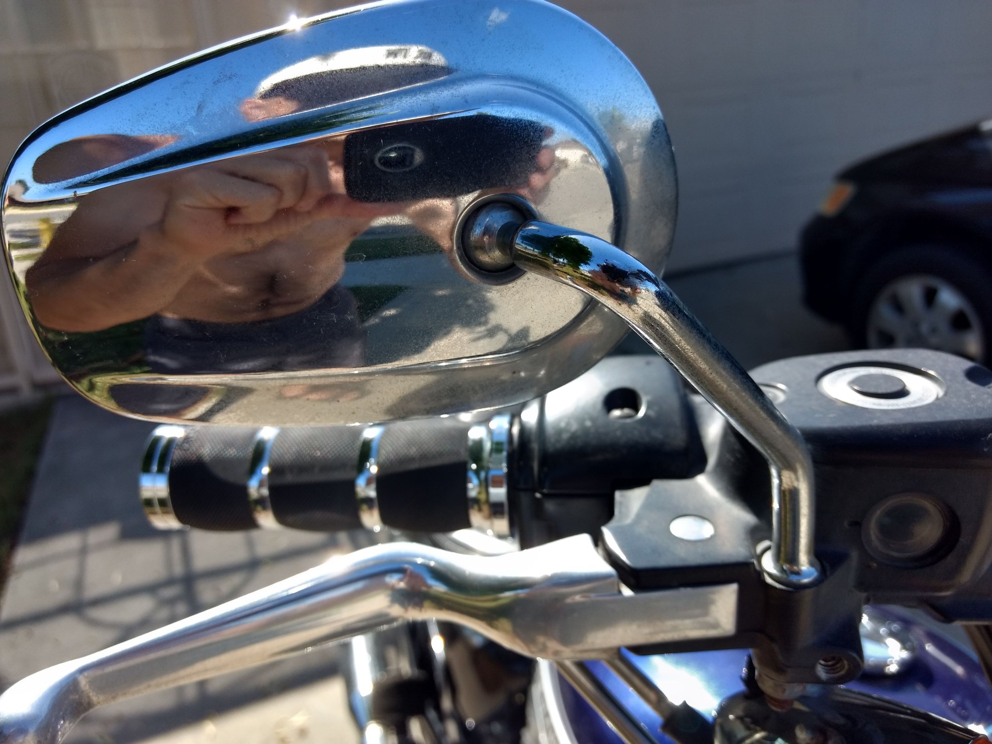

I hear ya, but it's kinda a pain that you have to remove the mirror to access them. If only they put them on the outside.
Perhaps you can take a picture and post it of your really weird mirrors that you have to remove the mirror in order to tighten the screws??
Good idea. Here you go.

If you don't plan on adjusting your mirrors then Fred has the simplest solution. Just glue them in place.
Crazy glue may not work well since the surfaces are non-porous. Ideally, a 2 part epoxy would be best. I would try E6000 adhesive. You can find your adhesive of choice at any home improvement store (Home Depot, Lowes).
Originally Posted by TroubleHead Fred
Sometimes after being tightened a few times they get where you can't tighten down on the ball enough. You can shim it or put a drop or two of your favorite adhesive on the ball, (super glue, gorilla glue, etc.)
It's not really permanent. Super glue and the like will usually hold until someone bumps or moves the mirror then you have to do it again. Yes, an epoxy would make it more permanent.

JB Weld
I wouldn't 'glue' them. But you might try using silicone seal. it stays pliable so you can still move the mirror. That is what I used to 'lock' bolts/nuts on my dirt bikes.
That might not work at HIGH speeds, but you could try it.
