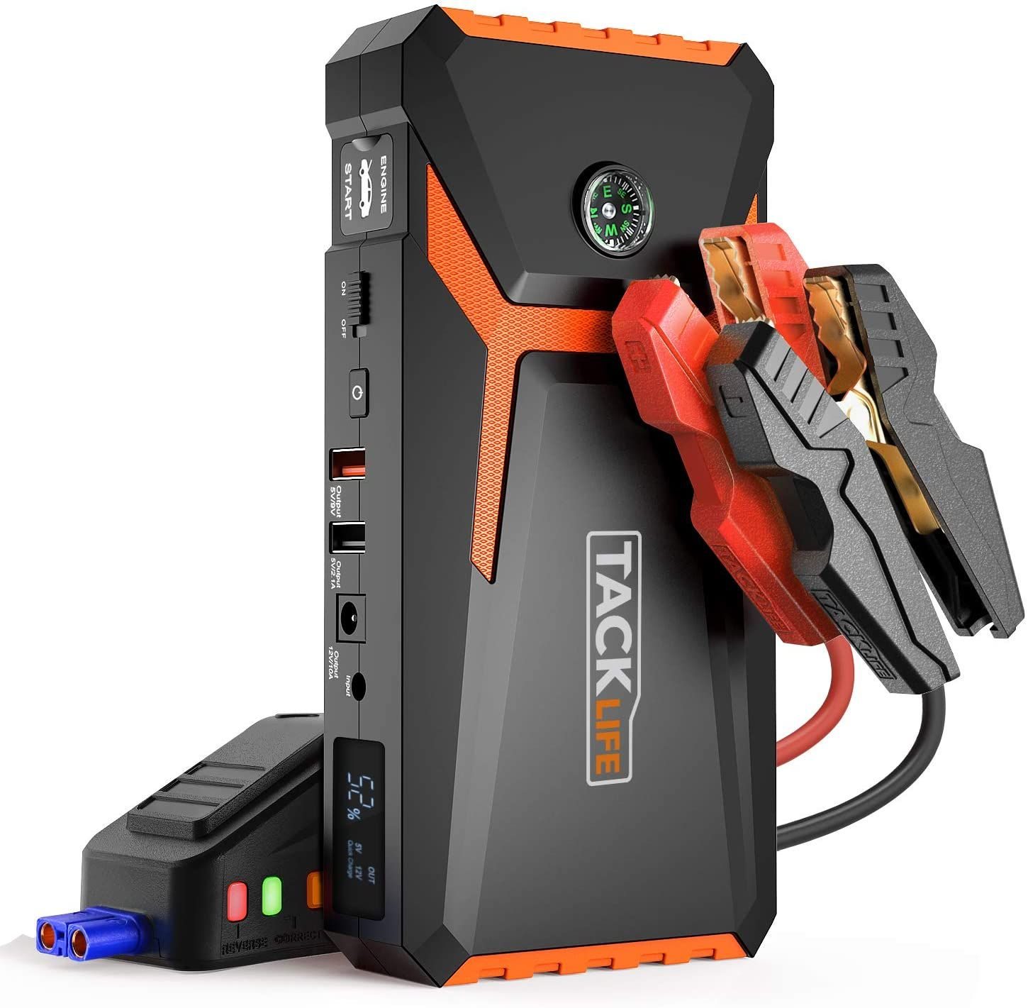

I purchased this one off Amazon after reading the reviews and it has worked well, jumped my Tahoe and a few friends bikes easily. If I had to do it all over again I would purchase the NOCO one others have posted here based on the fact that the alligator clips are not as bulky and easier to reach the terminals on some hard-to-reach bike batteries.

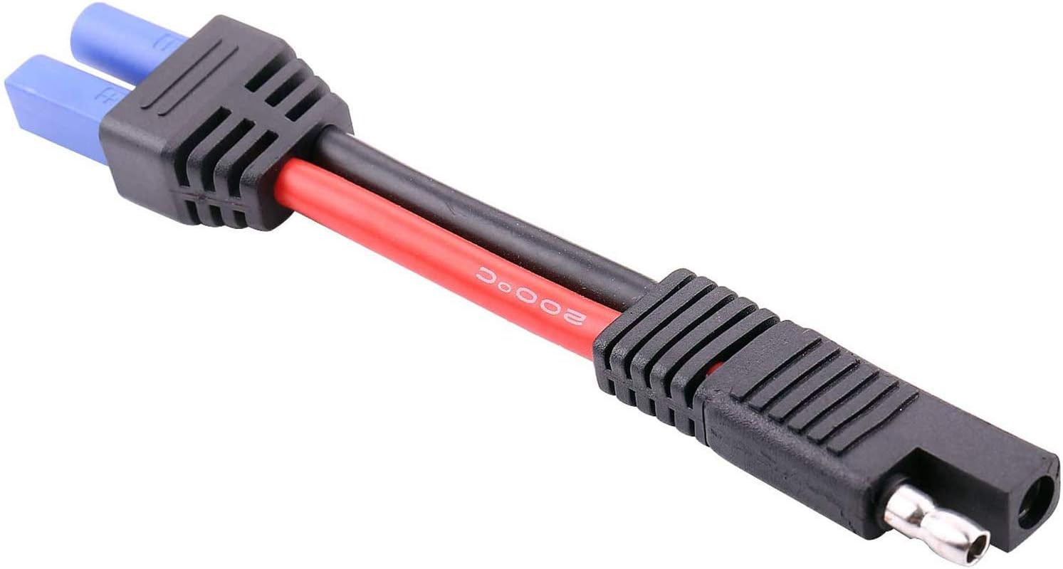

I was looking for this adaptor for the jump box to the tender plug on the
bike last summer with no luck. Just looked again and now it's available.
I need one of these- where did you purchase it?
I didn't yet. I just googled battery tender accessories and found it. I couldn't find it last summer.

Ok, I did a Google Image Search on the pic and it looks like there are many types available on Amazon. The cheapest is $9.
igreely EC5 Female Plug Connector to SAE Power Automotive Adapter Cable Wire 10AWG 12cm igreely EC5 Female Plug Connector to SAE Power Automotive Adapter Cable Wire 10AWG 12cm
