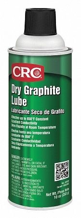

Lube your cables with something like this.

Thanks for all the suggestions and ideas, I’ll get the CRC ordered tonight.
