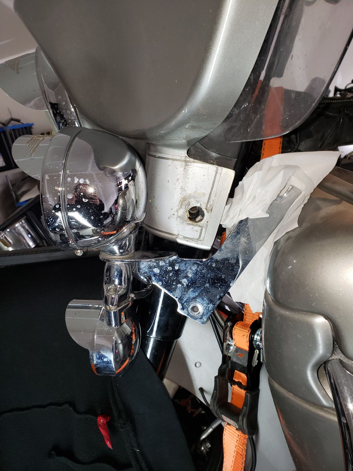

Soo head light comes off to reveal the bolts mounting it

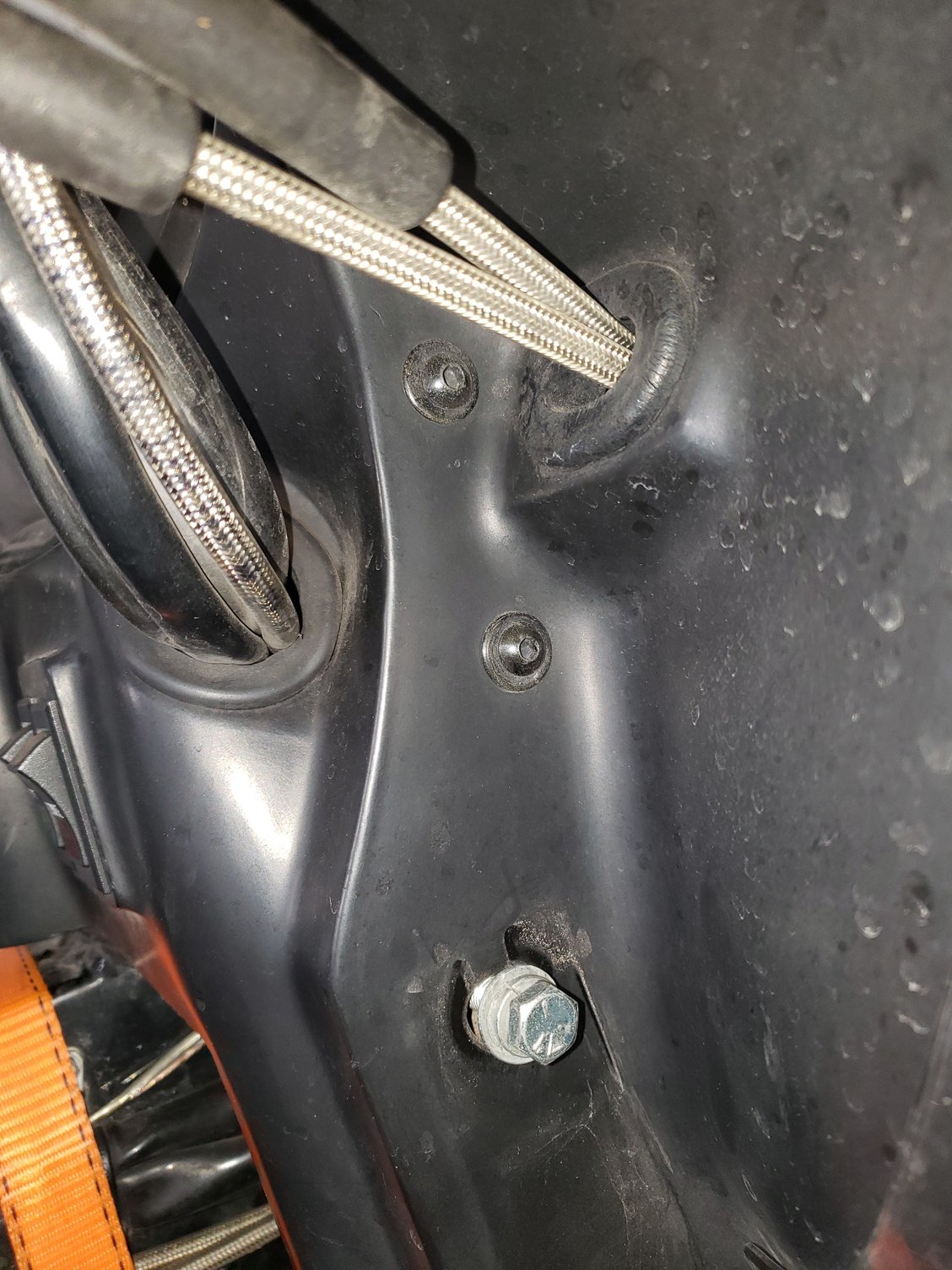

Remove headlight and headlight bucket. Inside of fairing , on R/L , you'll find two each nuts holding fairing to mounting plates.

Thank you i managed to figure it out from partial information in a thread about a different year bike.
